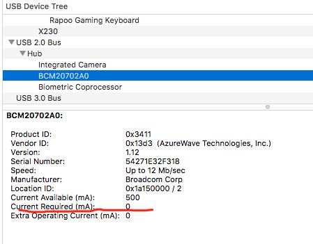

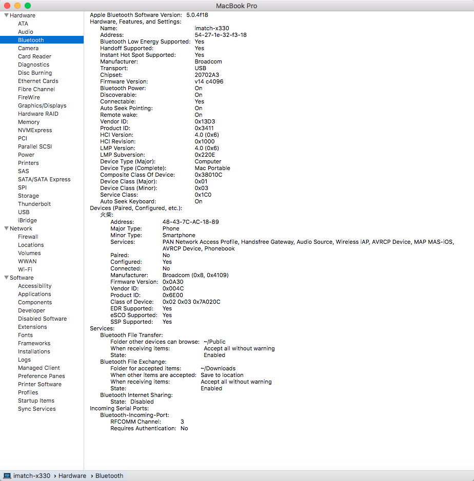

imatch Posted May 19, 2017 Share Posted May 19, 2017 I recently installed the AW-CE123H in my thinkpad x230(running osx 10.12.5 sierria ). AW-CE123H info: Model:BCM94352HMB with a buletooth chip(BCM20702) device ID:13d3:3411 I have read the guide https://www.tonymacx86.com/threads/guide-airport-pcie-half-mini-v2.104850/ And here is what I did: 1.put the latest FakePCIID_Broadcom_WiFi.kext FakePCIID.kext BrcmFirmwareRepo.kext BrcmPatchRAM2.kext in EFI/CLOVER/kexts/Other 2.modify the config.plist and adds those patch: Comment = "10.12-BCM94352-fvco-darkvoid"; Find = <81f952aa 00007529>; Name = AirPortBrcm4360; Replace = <81f952aa 00006690>; Comment = "10.11+-BCM94352-Airport-Extreme-skvo"; Find = <6b100000 750d>; Name = AirPortBrcm4360; Replace = <6b100000 9090>; Comment = "10.11+-BT4LE-Handoff-Hotspot-lisai9093"; Find = <4885ff74 47488b07>; Name = IOBluetoothFamily; Replace = <41be0f00 0000eb44>; The wifi is OK(both 2.4G and 5G works), and the system can find the Bluetooth, but I can't pair with any device through bluetooth. Plus, the Bluebooth is working well in Windows10. Has anyone had any experience with getting the Bluetooth connecting to devices under osx 10.12.5? I tried reboot again after sent this post, then I find the Bluetooth start work... I don't know why... I have rebooted several times before I came here ask for help. Link to comment Share on other sites More sharing options...
