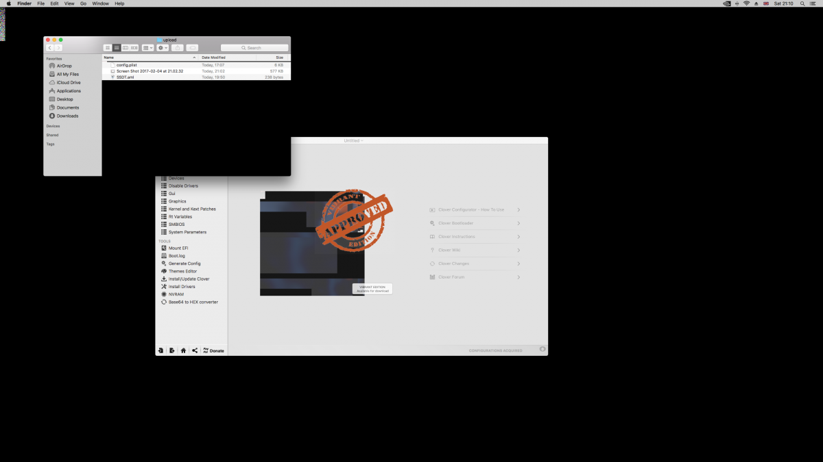

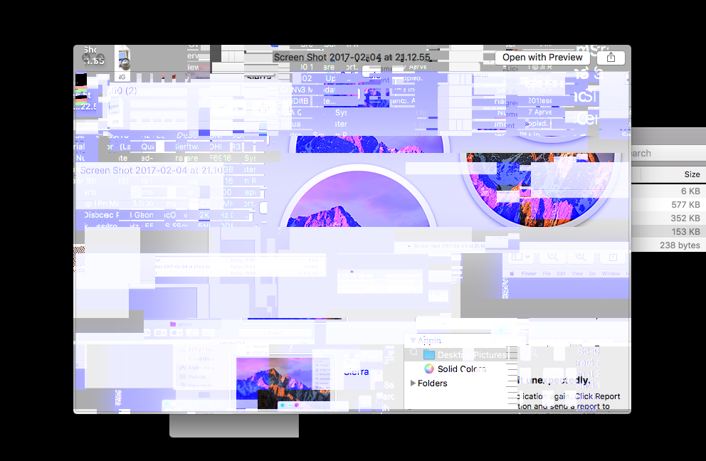

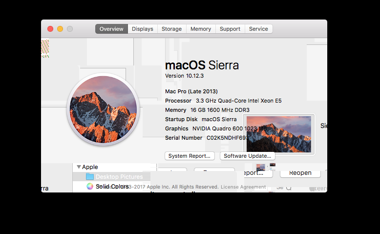

elkos Posted February 4, 2017 Author Share Posted February 4, 2017 Thank you anyway! It does help (at least psychologically) when someone is trying and could eventually solve a problem. In the mean time I came a little bit forwards. After - reinstalling the web drivers - rebuilding the kext caches - and made some minor modifications to clover config (attached) the web drivers finally load under 10.12.3 Both Quadro ports (DVI and DP) receive a signal with max resolution and full acceleration. HOWEVER, I get a weird problem with colors. Please look at the attached screenshots. Also, program windows and refreshes flicker and the display settings app from control panel crashes. What the hell is this?? Fortunately the macOS default driver works fine, so I'll make a break now until some clever guy gets a clue Anybody? config.plist.zip Link to comment Share on other sites More sharing options...
DuongTHVN Posted April 4, 2017 Share Posted April 4, 2017 Thank you anyway! It does help (at least psychologically) when someone is trying and could eventually solve a problem. In the mean time I came a little bit forwards. After - reinstalling the web drivers - rebuilding the kext caches - and made some minor modifications to clover config (attached) the web drivers finally load under 10.12.3 Both Quadro ports (DVI and DP) receive a signal with max resolution and full acceleration. HOWEVER, I get a weird problem with colors. Please look at the attached screenshots. Also, program windows and refreshes flicker and the display settings app from control panel crashes. What the hell is this?? Fortunately the macOS default driver works fine, so I'll make a break now until some clever guy gets a clue Anybody? Quadro 600 is nVidia Fermi architech. use inject nVidia on clover config.plist. and install freeze fix by Hackintosh VietNam Tools goodluck Link to comment Share on other sites More sharing options...

mfc88 Posted April 4, 2017 Share Posted April 4, 2017 ofc use 6,1 https://bitbucket.org/RehabMan/os-x-maciasl-patchmatic/downloads/RehabMan-MaciASL-2016-0423.zip dont use last version, have several bugs I don't remember what I was using at the time, but I'm using 6.1 now @elkos No idea if this SSDT-GFX1.aml will work, but try it out. Just drop it in patched (try not to use AGDP fix with this). I don't know much about injecting Quadro cards, but I've recently stumbled on some discoveries: - If your GPU's "NVDA,Display-{letter}@{address}"... (for example, yours is at NVDA,Display-A@0) is missing a connector value, then you may get weird graphical glitches - Also, if you're missing a "hda-gfx" value at GFX1, then it appears you won't get "nvAcceleration" and/or partial GPU recognition and/or no GPU recognition Important notes: If you're using pike's SSDT, then you should be dropping OEM SSDTs (specifically you should be dropping these SSDTs): - Ther_Rvp - Cpu0Ist - CpuSsdt - ApIst - Cpu0Cst - ApCst - Cpu0Tst - ApTst You may want to drop this SSDT as well, as it attempts to inject some stuff at your GPU location: - SaSsdt SSDT-GFX1.aml.zip Link to comment Share on other sites More sharing options...
