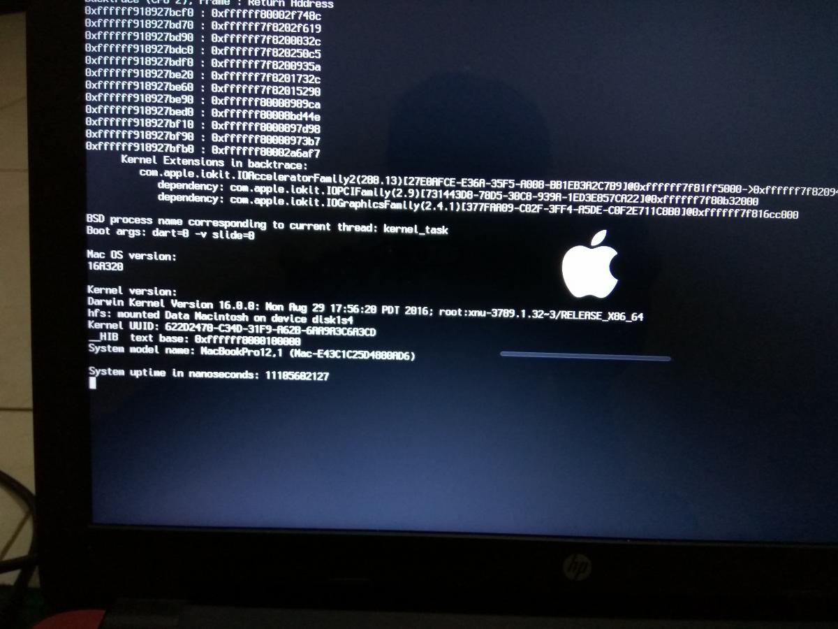

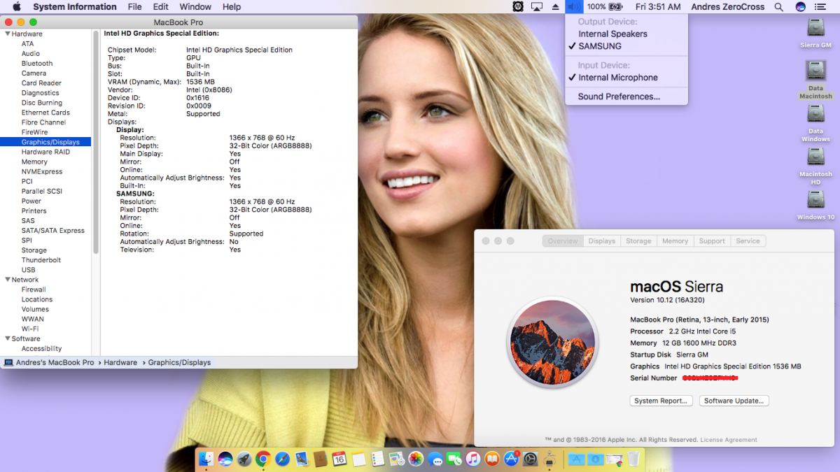

Andres ZeroCross Posted September 11, 2016 Share Posted September 11, 2016 At early version of Sierra i can boot and activated graphics IHD 5500 at Sierra with this patch http://www.insanelymac.com/forum/topic/312579-patch-dvmt-allocation-intel-hd5500-broadwell-not-found-at-sierra But now after update to macOS Sierra Developer Preview 6 and GM i always get Kernel Panic. I upload the picture. I already boot to desktop without inject intel (i use Clover 3716) and use Kext Utility to make Kernel Cache / Kext Cache. But still, i get kernel panic. At El Capitan, i only need to make Kernel Cache then boot with Inject Intel (inject ig-platform-id at DSDT). Thanks before,, 1 Link to comment Share on other sites More sharing options...

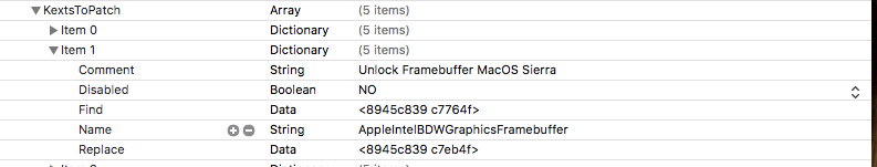

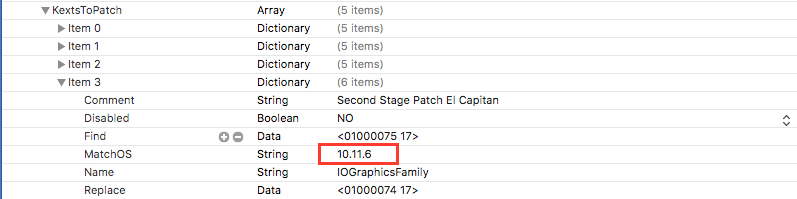

Andres ZeroCross Posted September 15, 2016 Author Share Posted September 15, 2016 Allright,, i found solution for myself.The second stage patch for El Capitan for IOGraphicsFamily is the problem, my system is dual boot El Capitan and macOS Sierra with one config.plist.So for the best result i need to fill "MatchOS" for the Patch. Look at attachment picture. Then the Patch will use for El Capitan only and no more Kernel Panic.And For patch DVMT, i still use old patch for macOS Sierra Name : AppleIntelBDWGraphicsFramebuffer Find : 8945C839C7764FReplace : 8945C839C7EB4F 2 Link to comment Share on other sites More sharing options...

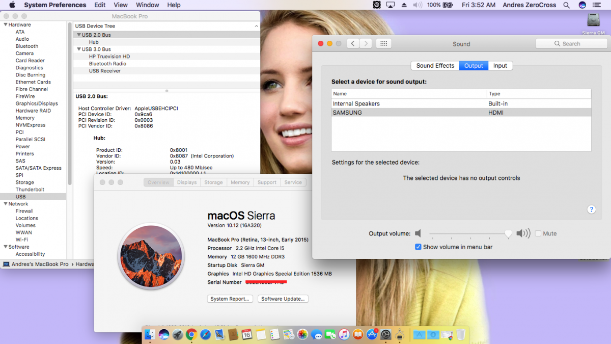

Sphinx777 Posted September 28, 2016 Share Posted September 28, 2016 Man... u finally found the answer! It really works using MatchOS! So simple and now full QE/CI! Thank u!!! Link to comment Share on other sites More sharing options...
Andres ZeroCross Posted September 28, 2016 Author Share Posted September 28, 2016 Man... u finally found the answer! It really works using MatchOS! So simple and now full QE/CI! Thank u!!! Glad to hear that,, you are welcome Link to comment Share on other sites More sharing options...

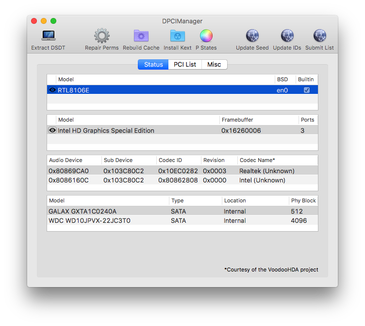

Andres ZeroCross Posted September 28, 2016 Author Share Posted September 28, 2016 Hi, I too have intel HD 5500 graphics card (BIOS LOCK DVMT), I managed to install the Sierra but I did not find kext for Intel HD Graphics 5500 and I have two problems. In About This mac I get written "Intel HD Graphics 5500 4 MB" and I have several problems like lag in login screen, in launchpad and safaris. Please help me solve. Sorry for my English Read this : http://www.insanelymac.com/forum/topic/310408-success-hackintosh-os-x-el-capitan-10114-beta-build-15e27e-at-hp-pavilion-15-ac169tx/ for macOS Sierra, you only need to add a new patch at kext to patch section Name : AppleIntelBDWGraphicsFramebuffer Find : 8945C839C7764F Replace : 8945C839C7EB4F And don't forget to use "0x16260006" as ig-platform-id Link to comment Share on other sites More sharing options...

Andres ZeroCross Posted September 30, 2016 Author Share Posted September 30, 2016 Use Clover Configurator and insert exactly as you can see here in your /Root/EFI folder. Important: inside USB installer never use ig-platformID = KP You are using an ig-platformID with 11 characters - too many zeroes (it`s wrong) Wow, you use 0x16260002??? i thought only 0x16160002 and 0x16260006 that can work with broadwell I use 0x16260006 as ig-platform-id 1 Link to comment Share on other sites More sharing options...
