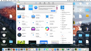

eelet Posted June 25, 2016 Share Posted June 25, 2016 Salve a tutti, come da titolo ho un Problema di download con App Store, ecco lo screen: Come faccio a fixarlo? Link to comment Share on other sites More sharing options...
gengik84 Posted June 25, 2016 Share Posted June 25, 2016 Controlla nelle info di sistema, che la ethernet sia in en0 Link to comment Share on other sites More sharing options...

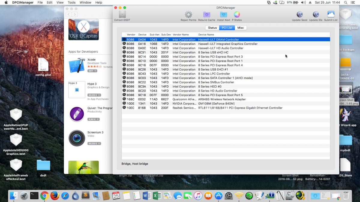

gengik84 Posted June 25, 2016 Share Posted June 25, 2016 male...la ethernet deve essere comunque configurata altrimenti non avrai accesso ad app store, ecc... Scarica dpci manager, fai una foto e postala alla sezione PCI list Link to comment Share on other sites More sharing options...
eelet Posted June 25, 2016 Author Share Posted June 25, 2016 Ecco qua: Link to comment Share on other sites More sharing options...
gengik84 Posted June 25, 2016 Share Posted June 25, 2016 Scarica qui, metti il kext in EFI Recati in Libreria/Preferences/SystemConfiguration Cancella: NetworkInterfaces.plist preferences.plist Riavvia, controlla che la ethernet sia riconosciuta e che sia in en0 2 Link to comment Share on other sites More sharing options...
