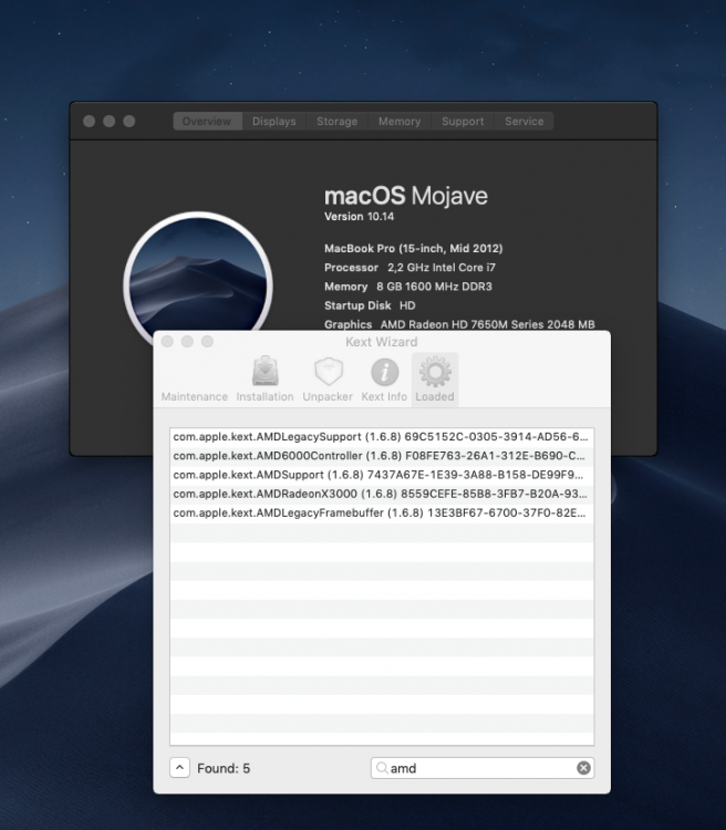

@vanantonietti   Made some progress, still no QE/CI, but at least all Radeon kexts are loaded that are needed for QE/CI. (As shown in the screenshot)  Next step, figure out why QE/CI won't activate(what else needs to be copied from HS to Mojave to force it to work) . Whole progress so far includes a dirty solution that involves adding High Sierra kexts that AMDRadeonX3000.kext depends on to Mojave ( weird thing is, seems that Mojave doesn't complain about High Sierra kexts, so thats a big plus). To test if QE/CI works one simply needs to open dashboard and try to add a new widget, if it's fast and smooth, it works, if not, it doesn't.
