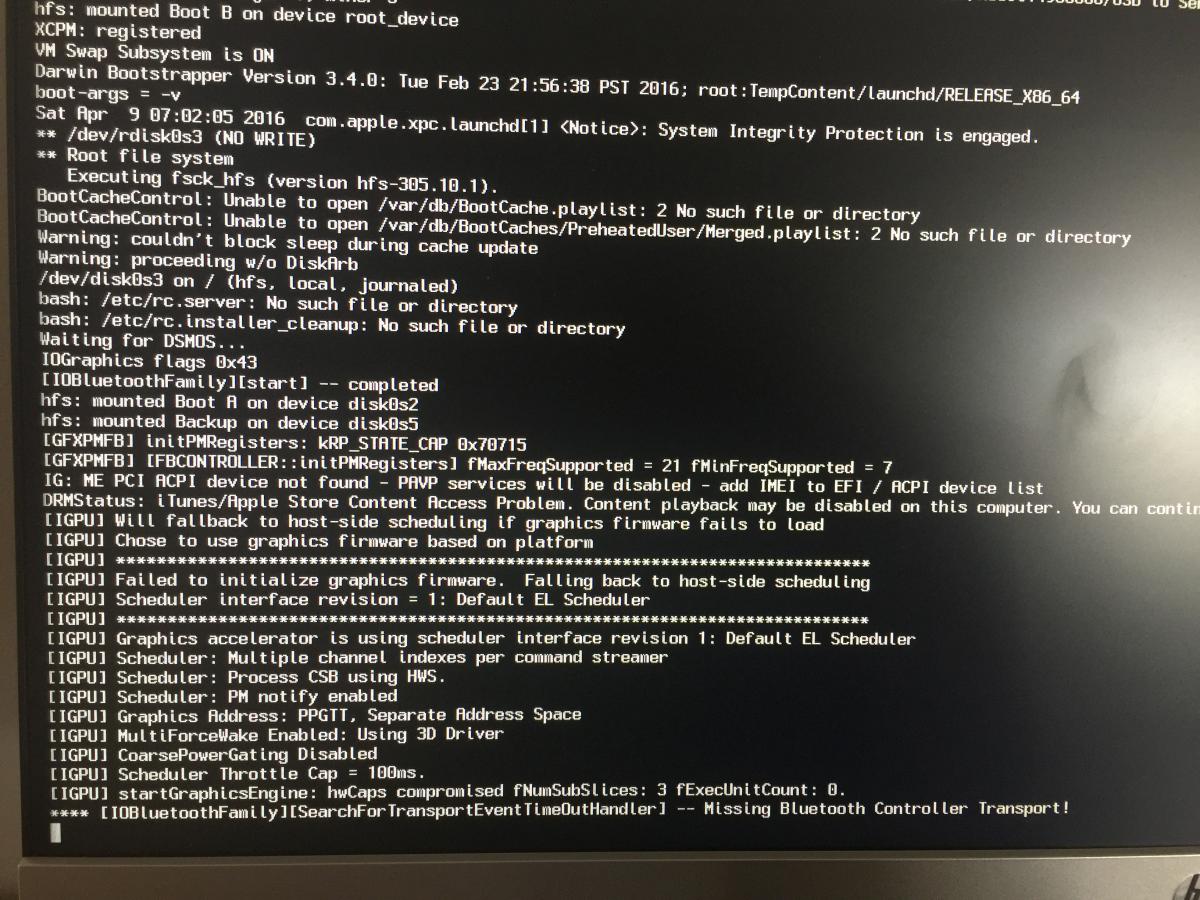

Denicio Posted April 9, 2016 Share Posted April 9, 2016 Greetings everyone, I have the following specs: El Capitan 10.11.4, Clover ASRock H170M ITX/ac Intel Core i3 6100 3.7GHz 16GB Kingston RAM I'm stuck with the following problem: My config.plist only has C States & P States enabled, AppleRTC. I would appreciate any feedback. Link to comment Share on other sites More sharing options...

Denicio Posted April 10, 2016 Author Share Posted April 10, 2016 Post your EFI, so we can see what is wrong. Inject Kexts wasn't set to "true" on Clover's config.plist, so "DSMOS has arrived" confirmation never appeared. After this resolution another problem appeared, I was stuck in the Apple Bootlogo screen. I could move the mouse but no activity was filling-in the progress bar. I had to disable VT-d from BIOS in order to solve this. Everything looks good now. Thanks for all the help. Link to comment Share on other sites More sharing options...
