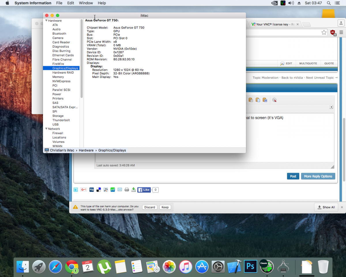

Derek12 Posted January 2, 2016 Share Posted January 2, 2016 I bought a new Asus 2GB DDR3 GT730 Video card to replace a older GT610 which worked OOB. It works fine on Windows 10 including games. In OSX it won't output signal to screen but video card is recognized OK and all acceleration works. System info says "Built-in display" is there a way to fix this? I don't have any DVI or HDMI screen Tried various smbios like imac, mac mini or Mac Pro, enabling/disabling injection, using nvda_drv=1 (otherwise it reboots) Thank you Link to comment Share on other sites More sharing options...
Derek12 Posted January 2, 2016 Author Share Posted January 2, 2016 System info taken thanks to VNC (after disabling nvidia injector now memory is shown properly but everything else is the same) EDIT: Plugged in an HDMI TV, it works perfectly. The issue is limited to VGA Can anyone help me? I am clueless about what to do (I don't want to replace my monitor right now) Link to comment Share on other sites More sharing options...
