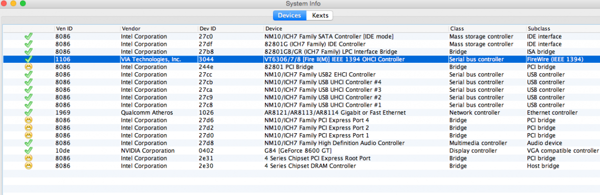

oshap Posted November 13, 2015 Share Posted November 13, 2015 Help me please - don't work PCI Fireware controller (noname), based on VIA VT 6307 chip. I can not find any kext... Yosemite started on following hardware: Asus P5P41T-LE/MSI 8600 GT/8 GB DDR3 Network and sound work perfect Link to comment Share on other sites More sharing options...
spakk Posted November 13, 2015 Share Posted November 13, 2015 install and start SystemInfo.app and load the image with the information of the installed hardware components (Vendor ID and Device ID) Link to comment Share on other sites More sharing options...
oshap Posted November 13, 2015 Author Share Posted November 13, 2015 this one... Link to comment Share on other sites More sharing options...
TheRacerMaster Posted November 16, 2015 Share Posted November 16, 2015 VT6307 should be native. Hotplugging requires DSDT edits. Link to comment Share on other sites More sharing options...
oshap Posted November 16, 2015 Author Share Posted November 16, 2015 I don't need hotplug. Sandisk fireware cardreader connected via this controller. CF memory card not accessible. Link to comment Share on other sites More sharing options...
