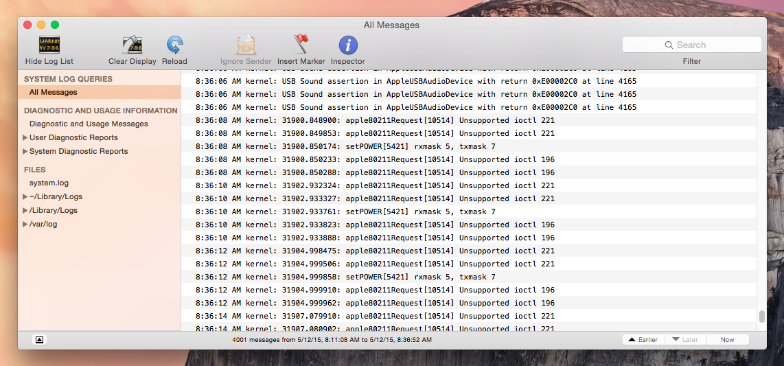

imsobored Posted May 12, 2015 Share Posted May 12, 2015 Hi guys, heres a little about my build. i7-5820k (not overclocked all stock settings) Asus R9 270x 2gigabyte GPU working well Used [url="http://www.insanelymac.com/forum/topic/279450-why-insanelymac-does-not-support-tonymacx86/"]#####[/url] to install Yosemite 10.10.3 w/ Clover + Clover Configurator wdn4800 tp link PCI wifi card Gigabyte UD3 x99 motherboard 16gb ddr4 2400mhz ram Everything works perfectly! I get the occasional spinning wheel with system freeze, I had a random log out the other day...where it just randomly logged me out, and all I had to do was just log back in. I looked in the console and I constantly see this over and over again... Please help! Link to comment Share on other sites More sharing options...

imsobored Posted May 14, 2015 Author Share Posted May 14, 2015 Well, never mind I guess I spoke too soon. Still the same messages in CONSOLE repeating. Unsupported IOCTL 221, Unsupported IOCTL 196. Also now my USB Audio interface Apogee Duet2 cuts out, forcing me to unplug usb cord, and plug it back in. Plays only for a few seconds and then cuts out again. Everything else is working fine. Please help rampage dev / anyone... Link to comment Share on other sites More sharing options...

imsobored Posted May 14, 2015 Author Share Posted May 14, 2015 I tried both USB 3.0 and USB 2.0 Right now I am on USB 2.0 This is the error I am getting in the console when it cuts out 5/14/15 6:10:04.000 AM kernel[0]: Sandbox: com.apple.WebKit(545) deny network-outbound /private/var/run/com.apogee.duetUSBDaemon/Socket Link to comment Share on other sites More sharing options...
imsobored Posted May 14, 2015 Author Share Posted May 14, 2015 Ok I found out the issue, and let me share it with anyone who may have the same problem with their USB audio dropping out. Don't use the Generic USB kext. Intel doesn't need it. Everything is working perfectly now! Cheers everyone! Link to comment Share on other sites More sharing options...
