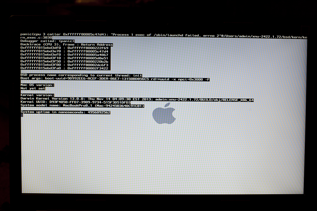

sharky9 Posted February 19, 2014 Share Posted February 19, 2014 Hi everyone, I was hoping I wouldn't run into issues installing Niresh's Mavericks image on my new Lenovo machine, but I don't get far into booting at all :-( I took care of all the normal stuff beforehand, bios setup, AHCI, legacy boot support as opposed to UEFI, etc.... Booting into the flash drive gets me the Niresh menu. Trying -v or -v -F -x and other flags gets me the same screen in a split second before it automatically reboots and goes back to the Niresh menu - it is really fast (2 seconds) so I had to take a picture with my camera for you all. I'm bummed out, this new laptop looks really neat, but I hate Windows 8 and don't want to use it that way. I have a fresh 1TB drive that I bought just for this Mac install :-( Any help would be appreciated from you gurus, I hope there is an easy fix to get the installer to actually load. Thanks, Larry Link to comment https://www.insanelymac.com/forum/topic/296193-lenovo-ideapad-z710-installer-reboots-quickly/ Share on other sites More sharing options...

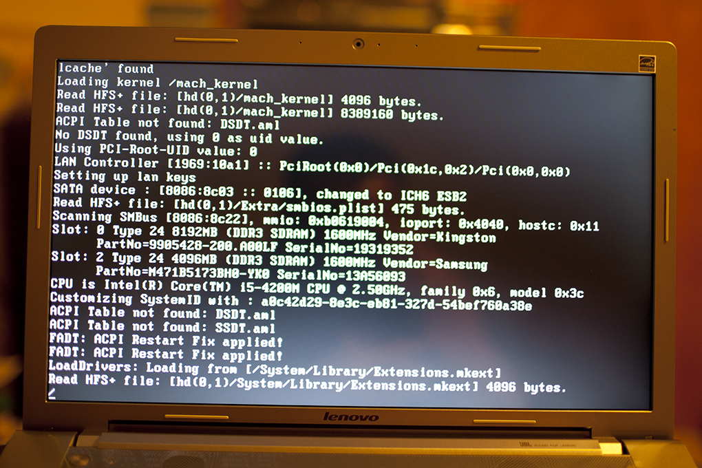

sharky9 Posted February 19, 2014 Author Share Posted February 19, 2014 One more addition since I saw another line at the bottom of the screen before it quickly reboots and my camera's shutter didn't get it in the picture I posted - it's about the same as the last line in the picture, but the byte size is different: [hd(0,1)/System/Library/Extensions.mkext] 15174552 bytes. That is the last line before it instantly reboots.....without the -v, I get to see the white screen with apple logo for 2 seconds before the reboot.... Link to comment https://www.insanelymac.com/forum/topic/296193-lenovo-ideapad-z710-installer-reboots-quickly/#findComment-1995384 Share on other sites More sharing options...

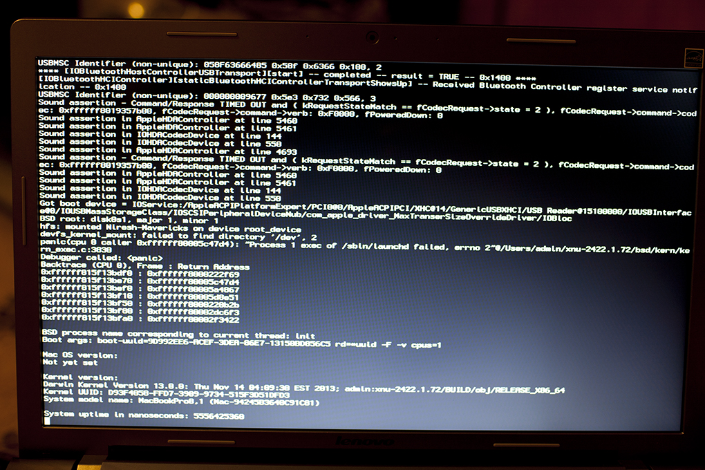

sharky9 Posted February 20, 2014 Author Share Posted February 20, 2014 I booted with the patched mach_kernel with flags "-v -f" ; it definitely got further and didn't instantly reboot. I saw misc errors on the screen as it scrolled, but it has been hung for the last 10 minutes at "Erp timer not specified, defaulting to 0x3840".....and nothing else has happened. Link to comment https://www.insanelymac.com/forum/topic/296193-lenovo-ideapad-z710-installer-reboots-quickly/#findComment-1995714 Share on other sites More sharing options...
Pimentel Posted February 20, 2014 Share Posted February 20, 2014 HelloOk let's patch your own kernelTurn on the old Power Mac G5, take off box kkkkkkk Follow this steps:Open the terminal and type: cd /Volumes/Name of USB stick, that have OSX Mavericks/ Now copy this perl code: sudo perl -pi -e 's|\x74\x6c(\x48\x83\xc7\x28\x90\x8b\x05..\x5e\x00\x85\x47\xdc)\x74\x54(\x8b\x4f\xd8\x45\x85\xc0\x74\x08\x44\x39\xc1\x44\x89\xc1)\x75\x44(\x0f\x32\x89\xc0\x48\xc1\xe2\x20\x48\x09\xc2\x48\x89\x57\xf8\x48\x8b\x47\xe8\x48\x85\xc0\x74\x06\x48\xf7\xd0\x48\x21\xc2\x48\x0b\x57\xf0\x49\x89\xd1\x49\xc1\xe9\x20\x89\xd0\x8b\x4f\xd8\x4c\x89\xca)(\x0f\x30\x8b\x4f\xd8\x0f\x32\x89\xc0\x48\xc1\xe2\x20\x48\x09\xc2\x48\x89\x17\x48\x83\xc7\x30\xff\xce)\x75\x99(\x5d\xc3)\x90{7}|\x74\x73${1}\x74\x5b${2}\x75\x4b${3}\x66\x81\xf9\xe2\x00\x74\x02${4}\x75\x92${5}|g' mach_kernel After that update cache: sudo touch /System/Library/Extensions This mini-guide can be found in my complete guide too: http://www.insanelymac.com/forum/topic/295587-power-management-for-sandyivy-bridgehaswell-cpus/ Link to comment https://www.insanelymac.com/forum/topic/296193-lenovo-ideapad-z710-installer-reboots-quickly/#findComment-1995716 Share on other sites More sharing options...
