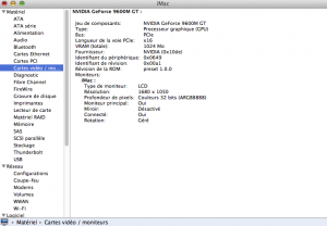

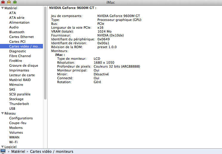

I've activated Apple Remote Desktop and i can connect to it.
The good news is that the system detects the Graphic Card correctly.
Here is the screenshot : Attached File  Capture d’écran 2013-06-07 Ã 20.18.31.png   83.95KB   24 downloads
I tried NVenabler but it looks like i get KP.
As i have the right informations in "system information", do i still need to look into Enabler like ATY init or NVenable or the problem is elsewhere?
Here is the bios of my card if someone knows what to do... http://www.techpower...024-081007.html
Also, i looked to this thread http://forum.netkas....pic,490.75.html and i'm a bit hopeless to solve my problem now...
Thanks.

Judging from the screenshot, the card is recognised, but doesn't work properly.
As far as far as I can understand from the screenshot, you have either Lion or Mountail Lion installed. Therefore you should definitely try what Rampage Dev suggests - install the official Nvidia OS X drivers. Since these work best with post Snow Leopard OS X versions. ATY init or NVenable are more for Snow Leopard Systems.

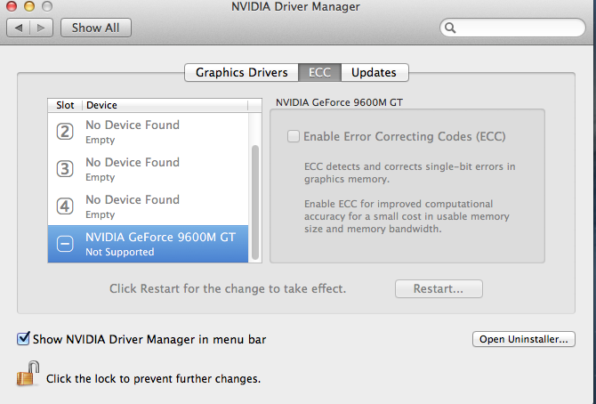

Finally i had time to try the NVidia Web drivers on my iMac8,1 with my NVidia 9600m GT but it did same, still a black screen.
Any other idea?
I'm about to buy a display port adapter to test if the video card send a signal. Maybe the video card and the screen doesn't know how to talk together ;-)
Attached File  Screen Shot 2013-06-18 at 08.48.20.png   91.65KB   8 downloads
Is there a way to be sure the drivers are loaded for my GPU?
Thanks.
