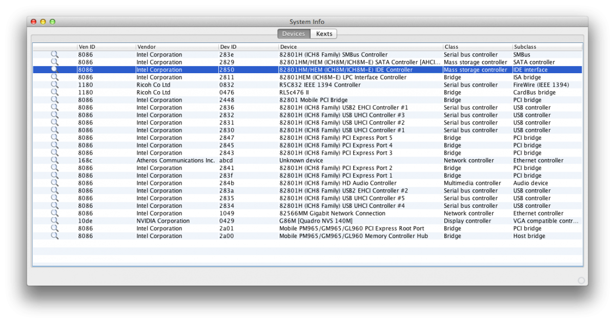

#5
Posted 26 April 2013 - 05:26 PM
hi,
I get this:
Ven ID: 168c
Vendor: Atheros Communication Inc.
Dev ID: abcd
Device: unknown device
Class: Network Controller
Subclass: Ethernet Controller
best regards
