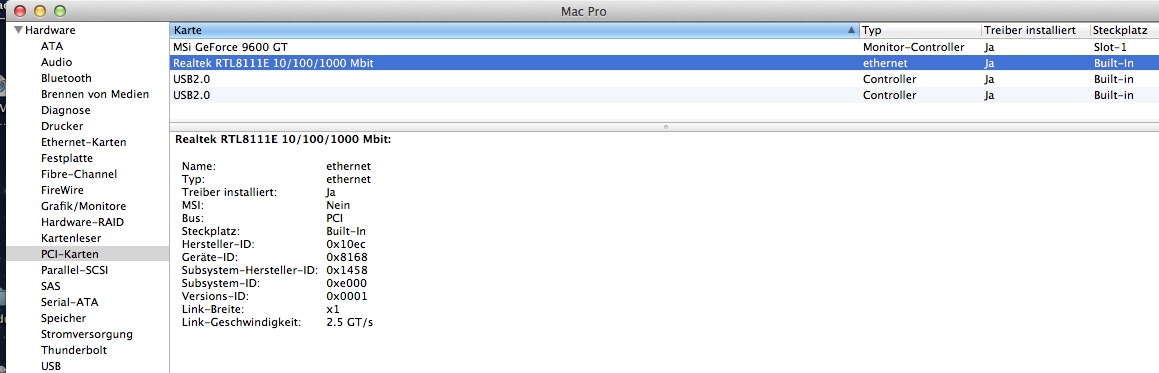

iLeopod Posted March 26, 2013 Share Posted March 26, 2013 What do you expect to achieve by that? To show up your card under PCI devices in system profiler u just need this: "AAPL,slot-name", Buffer (0x09) { "Built-In" }, "built-in", Buffer (One) { 0x01 }, "device_type", Buffer (0x09) { "ethernet" }, "model", Buffer (0x22) { "Realtek RTL8111E 10/100/1000 Mbit" } Link to comment https://www.insanelymac.com/forum/topic/287406-realtek-rtl81118168b-dsdt-lan0-injection/#findComment-1901061 Share on other sites More sharing options...
Lustral Posted March 26, 2013 Author Share Posted March 26, 2013 your code is also not working.. it shows me no information about my ethernet card in systemprofiler. but thx for your help !!! i try to get my ethernet to work with apple driver.. that's why i try to inject the code in my dsdt.aml but without success. Slice RealtekR1000SL 3.0.3 works perfect but i hope its possible to get ethernet to work without this kext. @ILeopod du kannst auch in deutsch schreiben wenn du willst. Link to comment https://www.insanelymac.com/forum/topic/287406-realtek-rtl81118168b-dsdt-lan0-injection/#findComment-1901080 Share on other sites More sharing options...

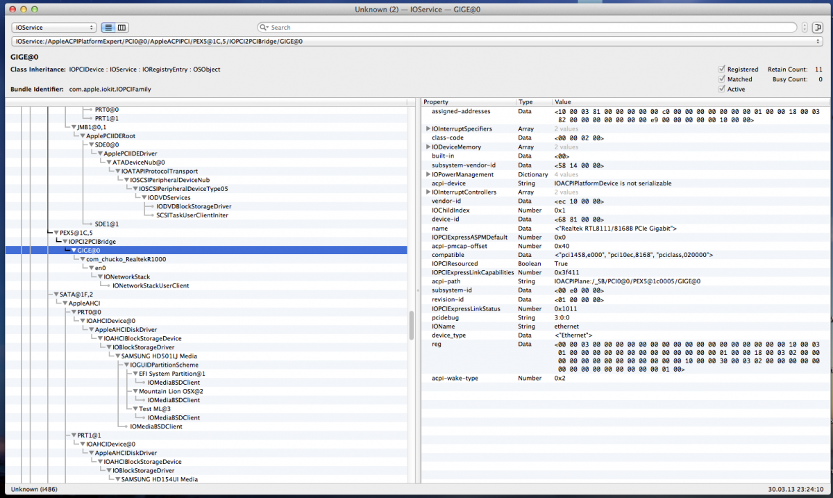

Lustral Posted March 26, 2013 Author Share Posted March 26, 2013 my board has a Realtek RTL8168B/8111B PCI-E Gigabit Ethernet Adapter (PHY: Realtek RTL8211/8212) PCI chip.. looks like not compatible with apple driver right ? but ioreg show under compatible (pci1458,000,pci10ec,8168, pciclass,02000) for me it looks like compatible with my ethernet chip but i can't get it to work .. very strange Link to comment https://www.insanelymac.com/forum/topic/287406-realtek-rtl81118168b-dsdt-lan0-injection/#findComment-1901122 Share on other sites More sharing options...
mitch_de Posted March 31, 2013 Share Posted March 31, 2013 At this stage of "worrying" you should poblably try to use an non Apple driver, like the great: Lnx2Mac's Realtek RTL81xx driver. I use that since 10.7 , now 10.8.3 - no probs at all. Speeds, sleep, wake - all works. Its better than the other (yours) driver. Be sure to remove the other before installing this one. Also Slice have an new driver in work. http://lnx2mac.blogs...osx-driver.html I agree thats the best to use native drivers - but sometimes, in this case its no prob to use such non Apple driver. Because they will never get overwritten (as AplpeHDA updates) you have no work with them for loooong time. PS: I use near same DSDT injection as posted here. The main thing is the build-in setting. Screensoout show that dsdt settings with Lnx2Mac driver, Gigabyte EP35 board (8168B). Link to comment https://www.insanelymac.com/forum/topic/287406-realtek-rtl81118168b-dsdt-lan0-injection/#findComment-1902438 Share on other sites More sharing options...
