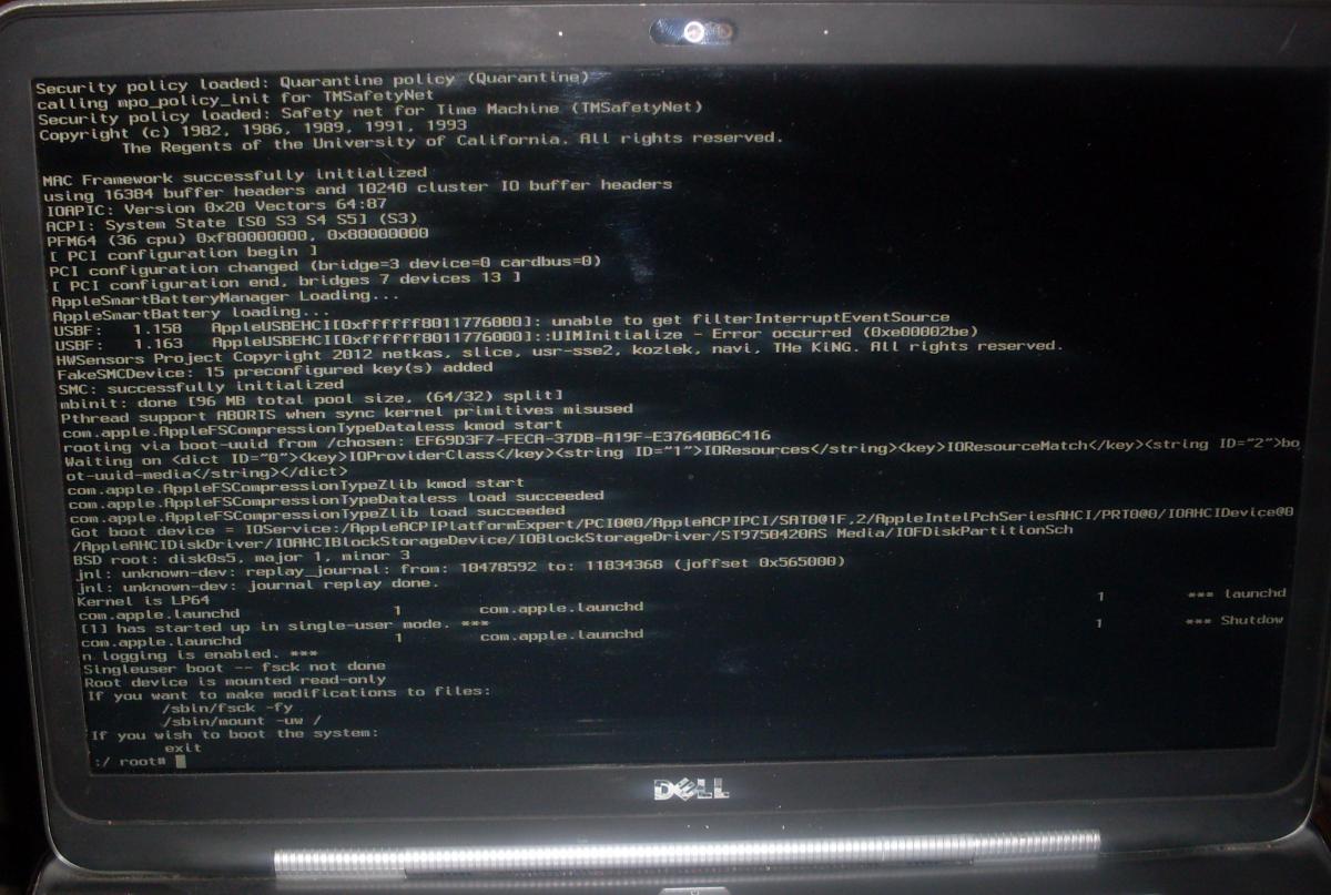

Hello,
I'm new to MAC .
This is my first time to install MAC on my PC or Dell Laptop .

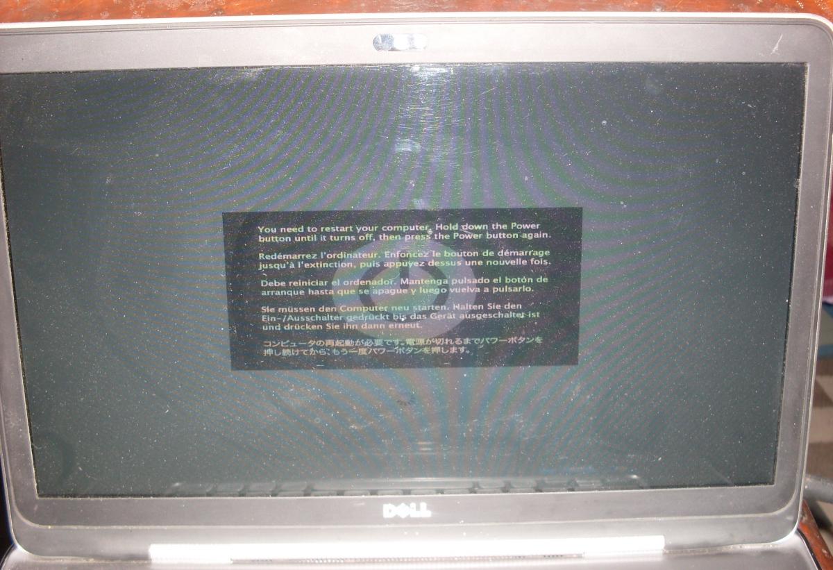

But every time i got the screen with system up time in nanoseconds
or you need to restart your computer !
I tried many version on PC and Laptop , but the same result with this error .
i attached an image to what i get ..
please help me
My Dell
DELL XPS 15z
Intel Core i7-2640M CPU@2.80 GHz
8GB Memory DDR3 1333
intell HD Graphics 3000 (GT2+)
sorry for poor English

Kernel panic: this is MAC OSX's version of the famous BSOD... you're using a iteration of OSX that's too old for your hardware.
Follow this guide: [Guide] The all-in-one guide to Vanilla OS X Mountain Lion + Chameleon + DSDT for beginners.

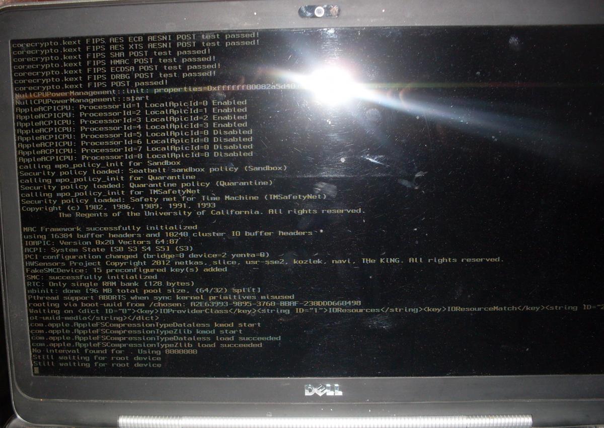

it is the new error with iAtkos ML2
Still Waiting for root device
i have restored the image in my USB flash 8 GB
Then when i boot from it that's what i get :(
please help

boot with UseKernelCache=No

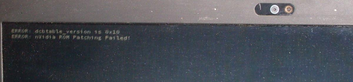

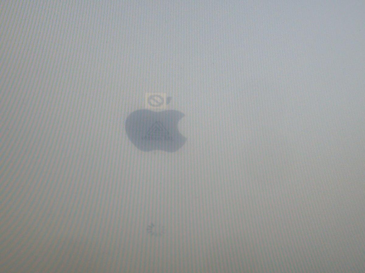

First thanks you
it worked fine with me till finish instillation then reboot
after that when i boot using USB flash

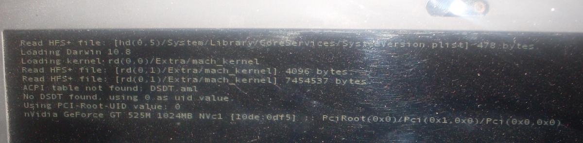

the error in image 1
error dcbtable version_0x10
nvidia rom patching failed
than get the apple logo loading then the error in image 2
but when i boot from cd (i boot 3.3) it give me the error in image 1
then just freeze on apple logo !
even when i try with UseKernelCache=No in both methods

boot wiht : -f -v -x GraphicsEnabler=No npci=0x2000

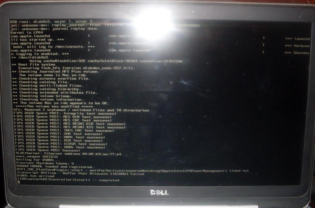

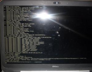

looks like it freezes here as in image from about 6 min in image SDC10100
it stops here in image SDC10101

Now use the same flags, but with GraphicsEnabler=Yes and post screenshots here, please.

the problem is your graphics kexts, try remove this., boot with -s

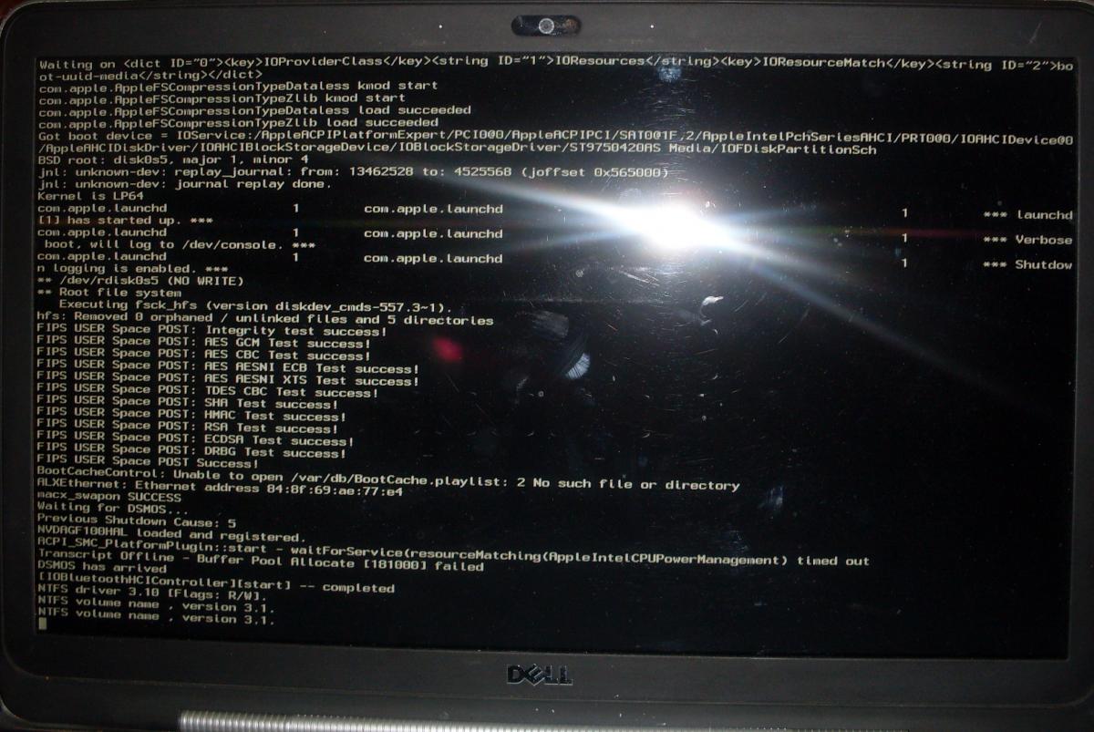

this image after boot with -f -v -x GraphicsEnabler=Yes npci=0x2000

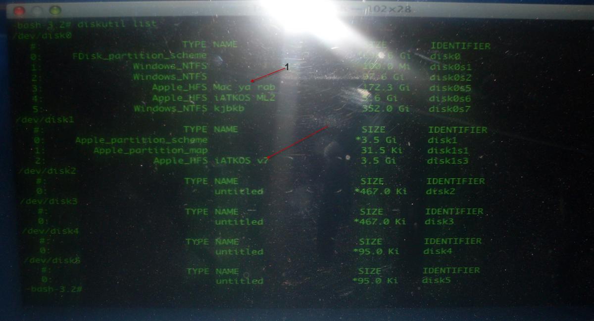

which one i mount ?
i mount here disk0s5
am i right ?
and
when i write
cd /Volumes/disk0s5
it told me
No such file or directory !
