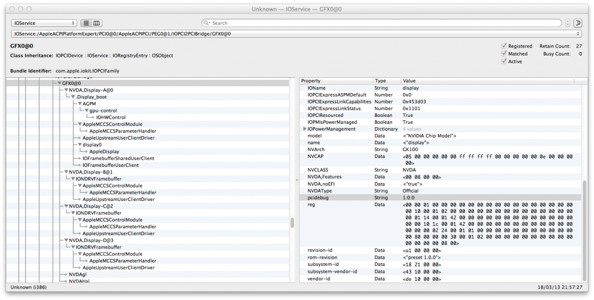

Hello,
I have a few questions about graphics on our gtx 660m, if someone can helpme .
After update my system to 10.8.3 and install cuda driver. I cant boot unless i remove NVDAResman.kext like others updates.
But if I look at IOReg I found that the four ports are detected (LDVS,HDMI,DP and VGA) ¿anyone have this ports detected ?
If I use the SMBIOS of jammest20 then apears AGPM under device(GFX0)
Same NVCAP like jamesst
NVgl and NVHal detect GK100 arch
I have a very very similar IOREG like jamesst20 but I have 3 BIG diferences:
Model
VRAM
IODisplayEDID
Well more than questions are my experience ;)
How can i inyect this values specialy EDID, all my attemps for doing this are fustrating.
