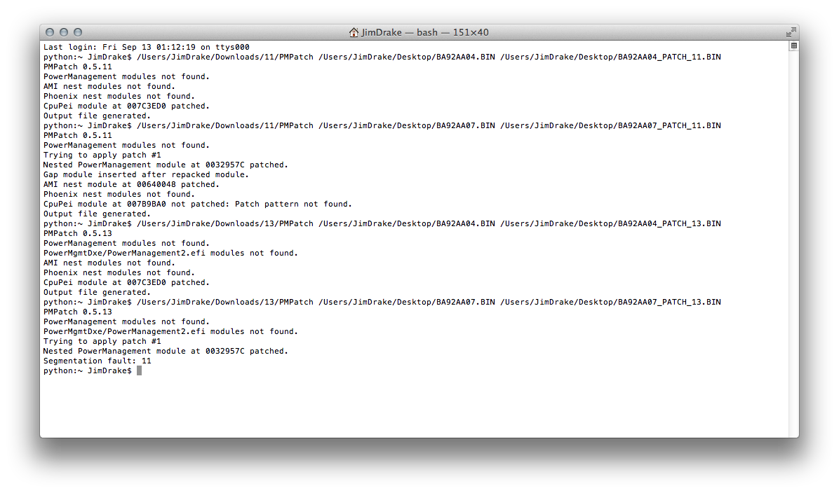

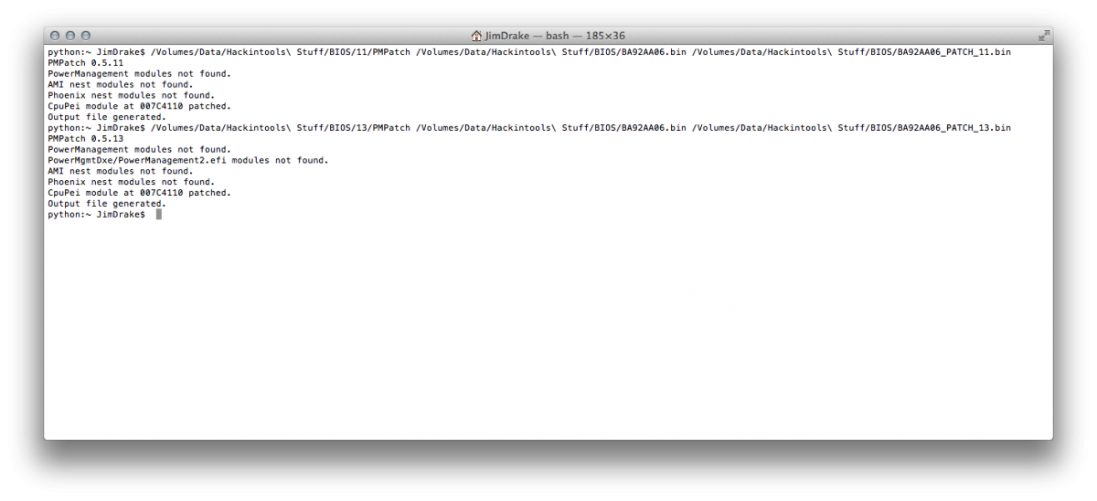

Hi,
First of all, many thanks for this tool.
Similar to genzai (back on page 23 http://www.insanelymac.com/forum/topic/285444-pmpatch-uefi-patching-utility/page-23?do=findComment&comment=1928839) I am playing with Pro Tools systems on the Jetway NAF92-Q67 motherboard.
I am currently using version 4 of their BIOS, but the latest available is version 7.
I tested your utility, downloaded from here: http://www.mediafire.com/?8866wtwhp4wi7
Both the 0.5.11 and 0.5.13 versions, running on OS 10.8.4 on my MacBook Pro.
I tried to patch both BIOS versions 4 and 7 for my motherboard.
Here is the output.
So it's interesting to see that Jetway changed something between the different BIOS versions, and your utility crashes only with one of the BIOS files.
I haven't tried to flash the BIOS yet :)

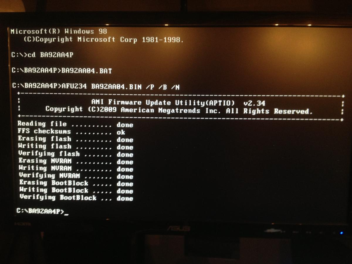

Interesting to note that using version 7 of the BIOS for the Jetway NAF92-Q67, the fresh download from their website, I am unable to flash my motherboard anyway! Version 7 was released to add support for Ivy Bridge CPUs so obviously there is a lot changed.
I ran your patch tool (both versions) again on my MacBook Pro running OS 10.8.4 with version 6 of my BIOS, and all seems OK.
So there is something strange about this BIOS version 7 file that won't flash on my motherboard and is crashing your patch tool.
And flashing the version 6 bios, patched with your tool, is OK.

Hi,
I patched this ROM for you, NAF92-Q67 ver 07 PM unlocked ROM download, extract to a DOS stick and execute flash.bat
should be no problem to flash this ROM ;)
