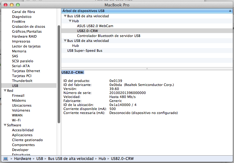

Hi friends!!!
I'm running Mountain Lion 10.8.2 in my K53SC.
All work fine except nVidia optimus and card reader.
I know optimus not have solution at the moment and does not worry me because HD3000 work fine, but need help with my card reader.
My card reader is a USB2.0-CRW from Realtek.
It have:
DivID: 0x0139=313
VenID: 0x0bda=3034
I have tried several methods to it work, but I did not succeed. (AnyCardReader, Voodoo, Add DivID&VenID).
The card reader is detected, but not configured.
Can anyone make me some suggestion about solving the problem?
I have added a picture for you can see the problem.
Thanx in advance!!!

i have the very same Card Reader as well, also tried many kexts file and still have no luck.
Have you managed to get any further?

No, no luck. apparently, the only solution is port the kext from Linux.
We hope that some privileged mind can do it.

I got that card reader to work by just inserting device ID and vendor ID into the plist of AppleUSBCardReader.kext inside AppleStorageDrivers.kext.
Reader is listet in sysprofiler under Card Readers and inserted cards show up as such in Finder.
Don't know if this info is still of use for the thread starter, but it may be for others using this device
I beg to differ, because I tried that with no luck. Can you put an image similar to the one in the first post to check the veracity of what you're saying?
Thanx in advance...
