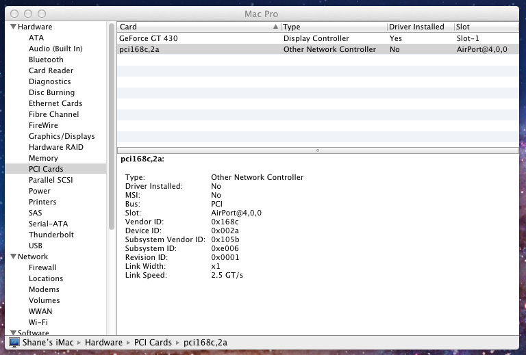

It is showing in system profiler now under PCI Cards but it says no driver installed.
Attached File  PCI.png   111.46KB   15 downloads

its your kext then. check the older kext 10.6.8 for 10.7
