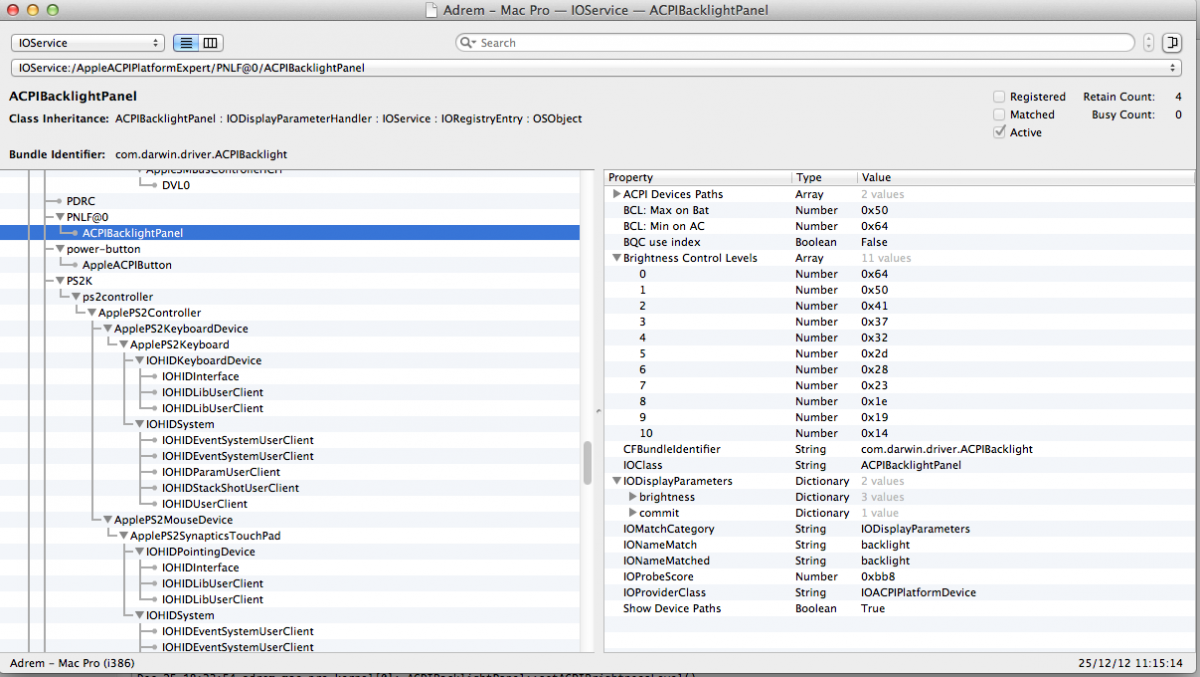

jeffc2009 Posted December 25, 2012 Author Share Posted December 25, 2012 Ugokind, I noticed in regeditorexplorer under ACPIBacklightPanel. BCL Min on AC is at max, and brightness control levels are backwards. And i read somewhere, we need to find a way for nvidia to release control for the slider to work. This is what I have so far in dsdt including the recompiled ACPIBacklight for ML. We need to find a dsdt for 9, 1 for MacBook Pro. I to find in ioreg LCDD/DPOD and change it. Device (PNLF) { Name (_HID, EisaId ("APP0002")) Name (_CID, "backlight") Name (_UID, 0x0A) Name (_STA, 0x0B) Name (_ADR, Zero) Method (_DOS, 1, NotSerialized) { ^^PCI0.PEG0.GFX0._DOS (Arg0) } Method (_BCL, 0, NotSerialized) { Return (^^PCI0.PEG0.GFX0.DPOD._BCL ()) } Method (_BCM, 1, NotSerialized) { ^^PCI0.PEG0.GFX0.DPOD._BCM (Arg0) } Method (_BQC, 0, NotSerialized) { Return (^^PCI0.PEG0.GFX0.DPOD._BQC ()) } } add in GFX0: "@0,backlight-control", Buffer (0x04) { 0x01, 0x00, 0x00, 0x00 }, Merry Christmas to everyone! Link to comment https://www.insanelymac.com/forum/topic/282499-g73sw-ml-1082-install/page/11/#findComment-1875735 Share on other sites More sharing options...
