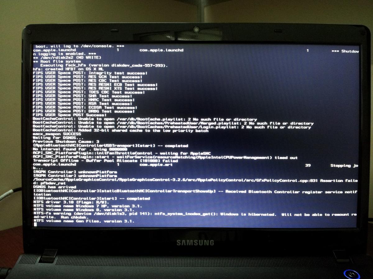

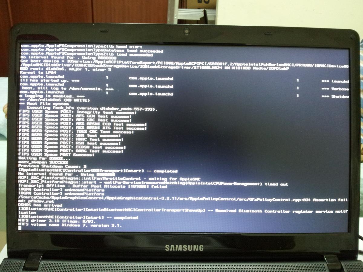

sniper9911 Posted August 23, 2012 Author Share Posted August 23, 2012 so far this is what I had accomplished regarding my triple boot system it seems that windows 7 can boot perfectly fine from a guid partitioned disk on a uefi motherboard but I wasn't able to get mac os x with or without dual booting to boot from my hdd I tried easy bcd 1.7.2 on my system and ended up doing repairing my boot manager via windows dvd oem disk I even tried another easy bcd version 2.1.2 and was able to achieve a stable boot manager to boot both windowses but the mac os x setting was out of order I checked its files in my c:\nst\boot\ and found two files mac os x.mbr file mac.iso image contains i386/boot0 and other files for booting and an extensions folder containing legacy kexts that doesn't work with my system the filenames could be different because I don't remember the exact filenames ok anyway I have to ask about partitions order on my hdd do I have to put mac os x partitions at the first of the hdd or whatever order I like ?? is it obligatory ?? second : mac os x guid partition booting didn't work with me even when I used three ways of installing the chameleon boot loader I used the pkg installer : not working (worked on mbr when I activated the partition after installation) I tried the manual munky way but it didn't work I also tried the script v3 for doing the boot files but this one caused so much damage to the windows boot manager that I had to repair the hole installation right now I am installing the mac os x ml on the first partition in the guid partitioned usb hdd disk (two partitions 40gb each) and I am planing on installing windows 7 with it on the second partition by the way I cannot change the active partition on this guid theme and I don't know how to I know that windows will take over the booting when I install it so I will have to try installing chameleon into the usb hdd before windows if anyone have some ideas that help please don't hesitate.......I need help ........ Link to comment Share on other sites More sharing options...
sniper9911 Posted August 23, 2012 Author Share Posted August 23, 2012 I finished installing ml on my usb hdd but then I shutdown then powered on my pc and then entered the usb boot menu and chose my ml hdd not in verbose mode (normal boot) and the same (you need to restart your computer appeared so I did restart my machine and got it working anyway I was curious enough to redo my installation in verbose mode and then boot in verbose mode and I was stuck at this point Link to comment Share on other sites More sharing options...

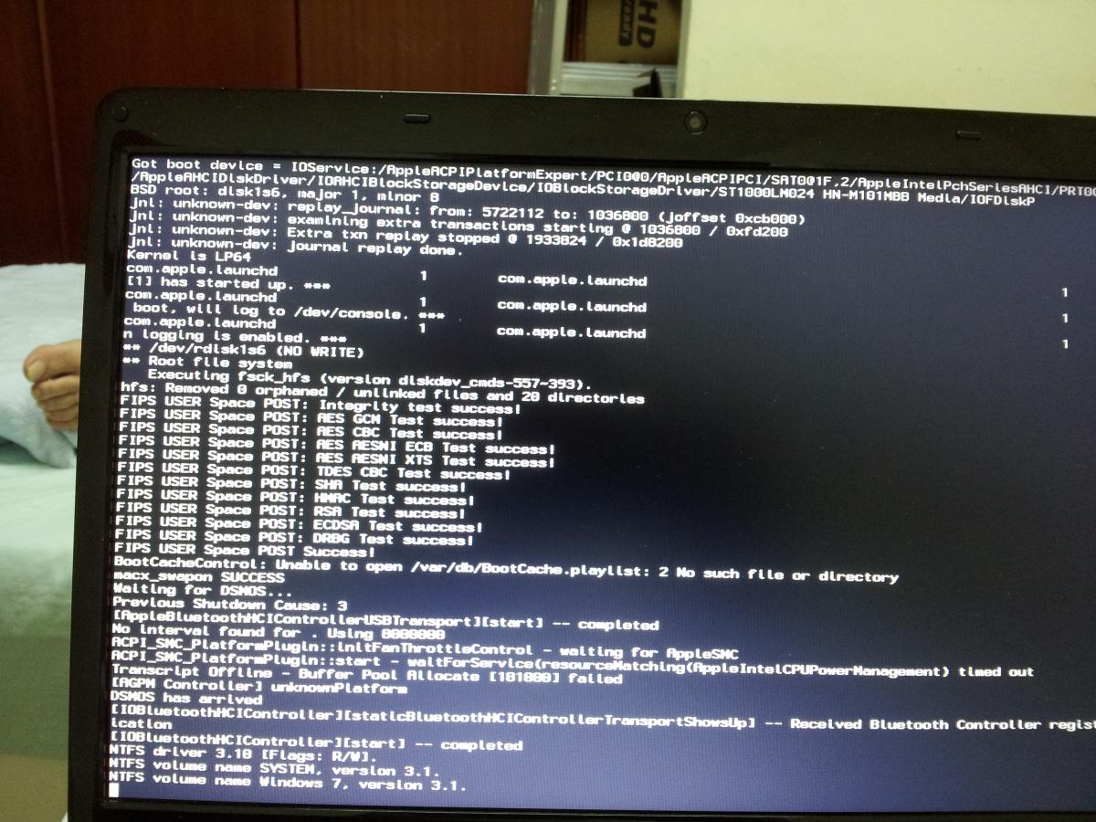

sniper9911 Posted August 24, 2012 Author Share Posted August 24, 2012 sorry for the tommorrow thing I didn't mean it ok now I tried it on a clean installation but it didn't work I was suspicious enough to mount efi partition to make sure it has the files as supposed but it was empty so I did another clean install and then I am going to install chmeleon one more time the manual munky way but I am not gonna format efi to hfs+ I will leave it as it is on fat32 Link to comment Share on other sites More sharing options...
eep357 Posted August 24, 2012 Share Posted August 24, 2012 why would you have reformatted EFI in the first place? what format is your usb stick in? probably a MBR with HFS+ volume, which obviously works fine. When installing chameleon manually, are you using dd if=x of=x command in terminal to copy boot0? if so and doing this along with setting partition active does not work, it may be a block size issue, where unmounting the hard disk before installing with dd command may be needed. Link to comment Share on other sites More sharing options...
sniper9911 Posted August 24, 2012 Author Share Posted August 24, 2012 I found the problem why I can't boot into chameleon bootloader the problem summerizes it self MY SYSTEM IS A UEFI SYSTEM apparently I chose the wrong boot loader to boot on a real gpt partitioned hdd I am sorry to bring this bad news but apparently someone else had this issue on an older samsung notebook also and the guys over there spared him the trouble and offered him the most suitable bootloader which is ta tata trata tata ta taaaa: CLOVER BOOT LOADER I am gonna try that bootloader this week and report to you when possible I am sorry for the inconvenience I made but I hope clover works with my situation Link to comment Share on other sites More sharing options...
eep357 Posted August 24, 2012 Share Posted August 24, 2012 no prob, Clover works great and has many different options to play with. Link to comment Share on other sites More sharing options...
