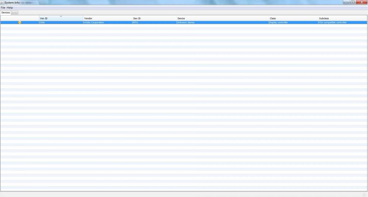

  • Pip
  • 8 posts
View PostiFIRE, on 11 August 2012 - 08:57 AM, said:
use this app from windows and post one screenshot of the yours devices
Attachment SistemInfo-Windows.zip
Attached screenshot.

umm, not sure, they are 10.8 kext
btw: That's quite the device list there :) thinking 282a prob not your device ID though, cause it would be ICH8M which is kinda old compared to the rest of your hardware. System info obviously didn't run properly there, see the post in New Hardware section for more info on running it with windows

n0rm4l
n0rm4l
    InsanelyMac Protégé
  • Members
  • Pip
  • 8 posts
hahaha I thought it was wrong and I looked around and don't know what I'm doing wrong with it.
