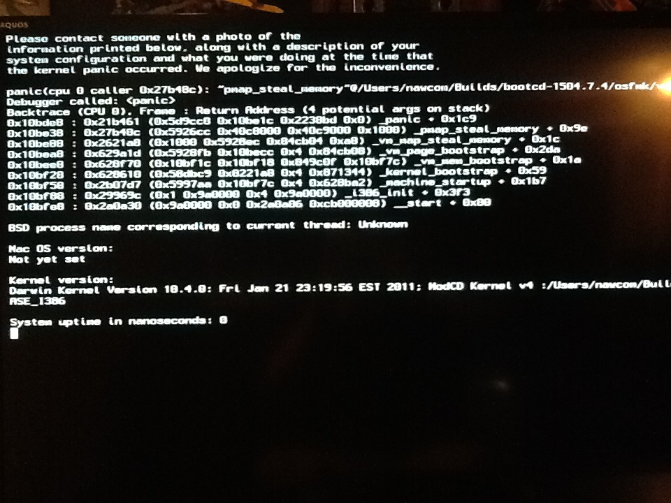

i have been trying unsuccessfully to install os x 10.6.3 on my pc my specs are as follows
Chipset: AMD Phenom ii x4 955
motherboard: ASUS M4A785T-M
ram: 8192 MB DDR3
video: NVIDIA GeForce 8800 GT
I have been following this thread to do the install [AMD] 10.6.8 Guide - written by Devout - InsanelyMac Forum
and once i type out the first line and hit enter some text flows on the screen asking me to hit enter again
then i get the following screen
Posted Image
any help would be awesome!!

I would rename modbin kernel to mach_kernel and boot normal see if that works

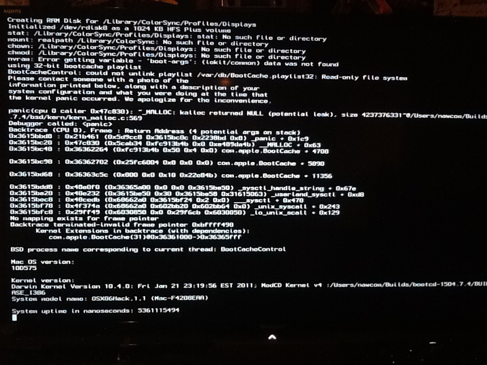

Tried that different error but still a kernel panic
I'm beyond lost lol only day one of all this.... Should I scrap trying snow leopard and go straight to lion??
Thanks

No, do not try going straight Lion. The legacy kernel for Lion is not very stable. For now, stay on Snow Leopard. I'd recommend doing a clean install of Snow Leopard using the ModCD. When booting, try adding
-force64
when you are at the boot screen.

If your still getting same error, since it's the boot cache that is causing the kernel panic, skip loading it by using boot flag -f

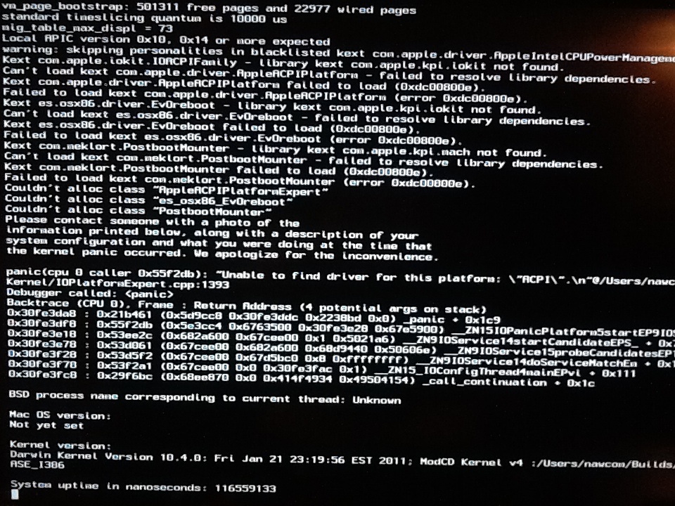

Tried that and am getting a new screen, here is what i typed prior to starting the load
rd(0,0)/extra/mach_kernel arch=i386 busratio=18 -v -f
rd(0,0)/extra/mach_kernel arch=i386 busratio=20 -v -f
rd(0,0)/extra/mach_kernel arch=i386 busratio=18 -force64 -v -f
rd(0,0)/extra/mach_kernel arch=i386 busratio=20 -force64 -v -f
rd(0,0)/extra/modbin_kernel arch=i386 busratio=18 -v -f
rd(0,0)/extra/modbin_kernel arch=i386 busratio=20 -v -f
rd(0,0)/extra/modbin_kernel arch=i386 busratio=18 -force64 -v -f
rd(0,0)/extra/modbin_kernel arch=i386 busratio=20 -force64 -v -f
After each attempt a lot of code scrolls by before it saying to hit enter here is what happens
The version of osx was restored from my retail Disk to a 40 gig USB as the pc I will be using does not have a cd drive do I possibly need some patch for the version since it was setup in disk management using the restore .dmg to drive function
Thanks all help is appreciated greatly
Just tried this rd(0,0)/extra/mach_kernel arch=i386 busratio=18 -v -f -x
Read it was a safe mode boot got this error (second pic)

Do you have fakeSMC installed?
And where is it saying hit enter?
Ok, obviously you don't have fakeSMC installed cause you haven't technically installed anything yet :), but I'm a little curious about your methods to make this USB from CD, is it real retail apple CD with picture of Snow Leopord on it and not a grey one? And how did you restore and also apply mod? I'll read that thread you linked too right now to get a better idea
OK, pretty straight forward as far as creating the installer, and I see you have evoreboot and a couple other non-apple kexts trying to load so you at least got most the mod stuff installed too. The entire family of ACPI and related kexts are failing to load atm, and once one fails, they all do. Normally I'd advise a roll back to 10.6.3 version, but that's what your running :) Sure you don't want an intel instead? Keep messing with it and I need to look into something. Also check bios settings for anything related acpi

Just noticed something, don't use rd(0,0) as that would be location for a DVD, which you arent using. If this is usb drive and you also have internal HD, it will proabably be 2,1 or 1,1
Or just leave that part out all together. See if that makes any difference

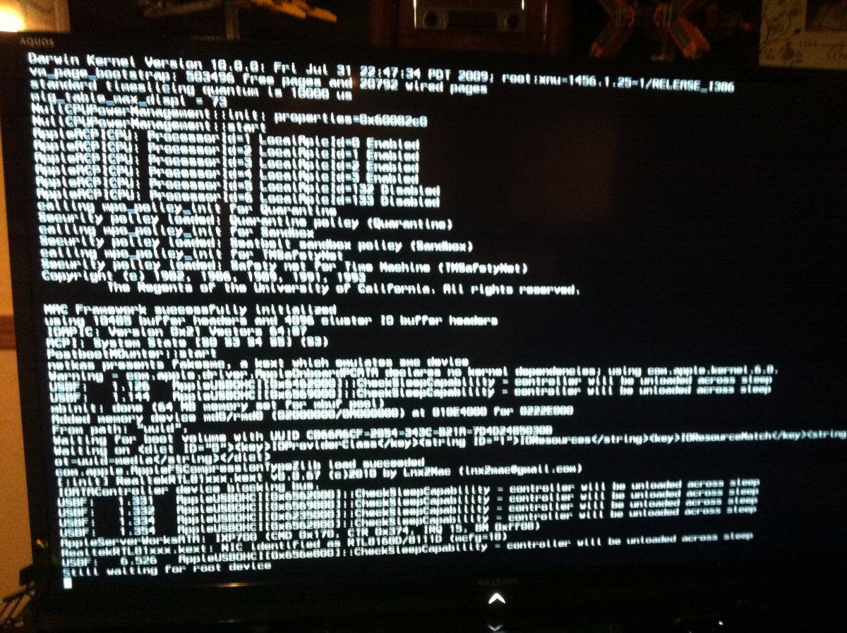

Hey so I have a DVD drive now, am using the latest nawcom bootcd.
After typing rd(0,0)/extra/modbin_kernel arch=i386 busratio=18 -v
The load starts but is now getting stuck at still waiting for root device.
The hdd is set up as GTP from windows disk management and formatted to fat32 the bios is set to AHIC for the hdd and for the cd rom IDE.  Here is a screen shot please help as I am lost

see here http://www.insanelym...howtopic=278075 , there are a number of reasons and possible fixes so may take a little fiddling
