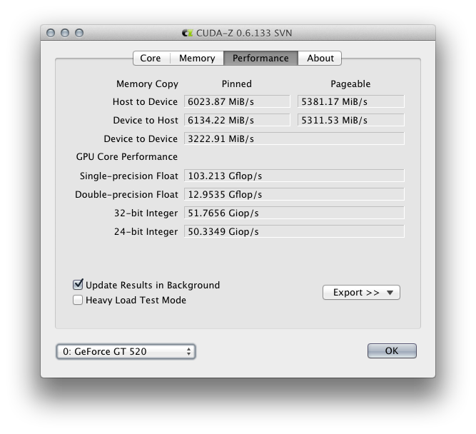

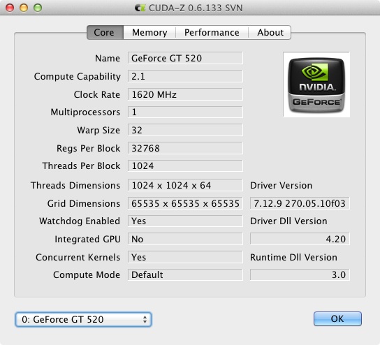

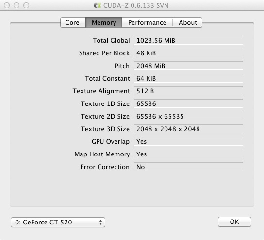

RobertX Posted April 23, 2012 Share Posted April 23, 2012 hey... i have the zotac gt 520(PCI-E(x16) version) however...not a great card apparently...except as a media centre...i overclock mine in win7...still only matches scores of OSX in opengl viewer(about 400 fps for cube test opengl 1.1-2.1)...the card runs mac very fast and smooth...but i hesitate to try any games...i get 44 fps in OpenCL OceanWave..here's a peek in the Cuda-Z app Link to comment Share on other sites More sharing options...

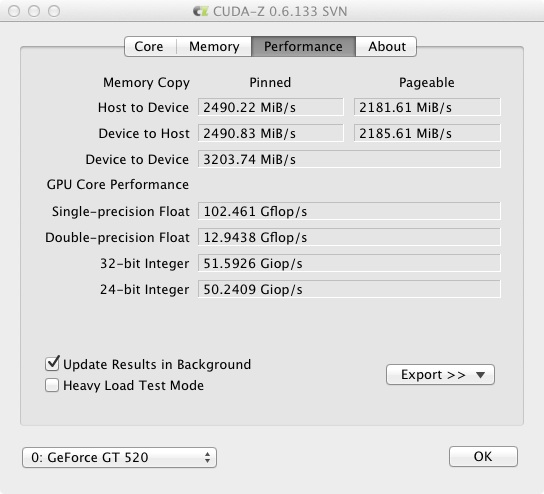

ampersAnd Posted April 24, 2012 Author Share Posted April 24, 2012 hey, thanks for the respond. I realize that this card is not the best one, but it's ok for the work now. But, I can't make it run smooth in user interface and any apps also. Mac runs "steppy", if You know what I mean. I tried a Cuda-z, and get the same result as yours for first two screens, but the third one differs. idk what does it mean Link to comment Share on other sites More sharing options...
