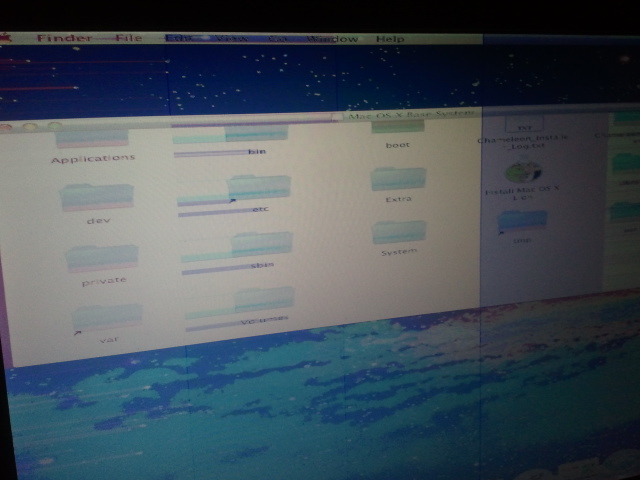

jfisher007 Posted February 22, 2012 Share Posted February 22, 2012 Hello all, I have prepared usb with lion using Maldon's guide. I installed chameleon and these files on the usb, allegedly specific to this laptop. It boot up nicely but the graphics were shifted to the right and distorted with pink colors (OUCH!!). I posted a picture (taken with phone) of what i'm talking about. It recognizes intel 3000 hd gpu with a bunch of resolutions to select but the screen is distorted and un usable. Any ideas how to fix this? Thanks Link to comment Share on other sites More sharing options...
slayher Posted February 26, 2012 Share Posted February 26, 2012 Look for the dsdt.aml from an Asus n73sv. Its basically the same laptop but with a 17" screen. Fixed my graphics right up. Just drop it in /Extra **Edited* Here, I attached mine. dsdt.aml.zip Link to comment Share on other sites More sharing options...
