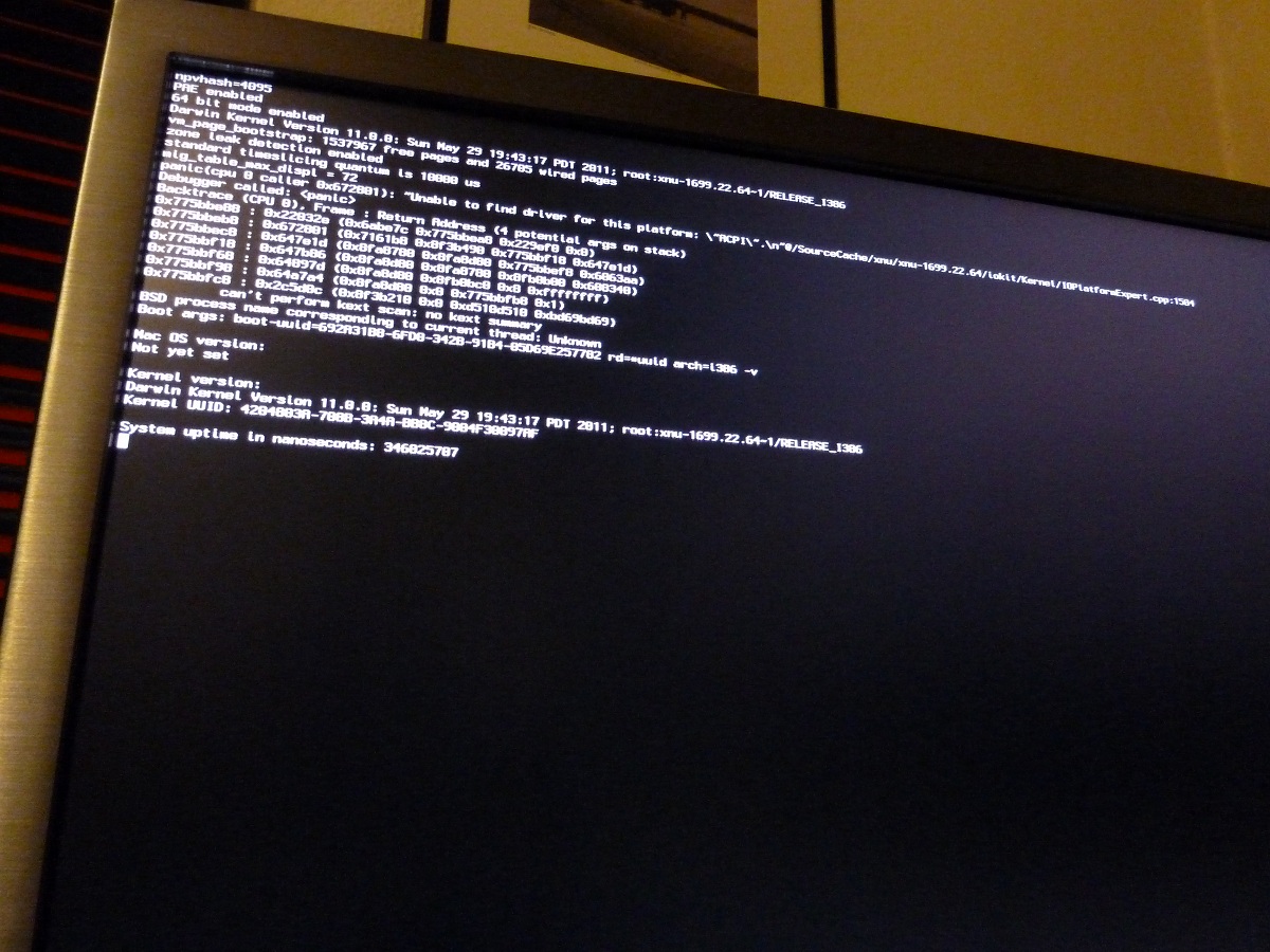

Guest Posted July 21, 2011 Share Posted July 21, 2011 Hello all, First, to make things clear, I currently have a fully working SL config, with a self-tuned and trimed-down DSDT, complete with all P-States aso. I managed to reduce the amount of kext loaded only to 'fakesmc.kext'. I have then created a Lion USB key as described in the sticky topic, just instead of using the Extra installer, I just copied mine, with my DSDT file. But once I am booting this USB key, I get a kernel panic stating: "Unable to find a driver for this platform: ACPI [blah-blah] in IOPlatformExpert.cpp:1504" My config is: - Asus Rampage II Extreme, bios 2002 - Intel Core i7 920 (no overclock) I have tried both 32 and 64 bit kernels, also replaced my /Extra with the one created by the installer, and even deleting the DSDT.aml itself, but everytime, same issue... (I made a screenshot of the KP and attached it to the post...) Link to comment Share on other sites More sharing options...

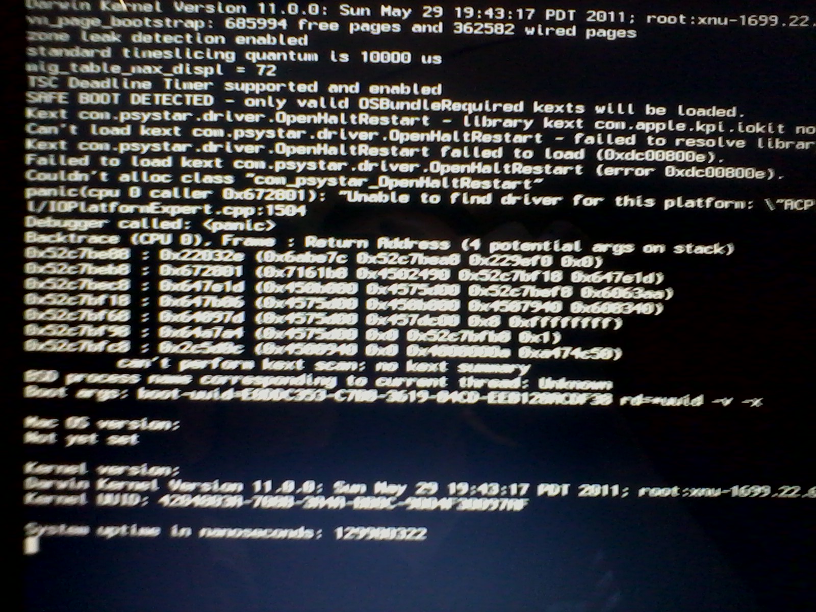

StigsHero Posted July 22, 2011 Share Posted July 22, 2011 Hello all, First, to make things clear, I currently have a fully working SL config, with a self-tuned and trimed-down DSDT, complete with all P-States aso. ... But once I am booting this USB key, I get a kernel panic stating: "Unable to find a driver for this platform: ACPI [blah-blah] in IOPlatformExpert.cpp:1504" I can't offer help just yet but I'm dealing with a similar situation with a Dell Precision 490 (HW very similar to a first gen MacPro) that works flawlessly on Snow Leopard. I've created a USB installer with Chameleon RC5-r1173 and my DSDT.aml that worked perfectly on Snow Leopard. Booting the installer consistently produces a "Unable to find a driver for this platform: ACPI" kernel panic. All I can find so far is some threads by people running Apple software RAID who are experiencing the issue post-install due to a bug in Chameleon. I get the impression that it's DSDT-related in their case, but I don't understand enough about DSDT patching to know why you'd wouldn't be able to carry over the same patched file from SL to Lion. I did my SL install about 18 months ago and have used the machine day-in and day out since then. I hand-patched my DSDT and had an intermediate-level knowledge of the process for about two days but quickly forgot everything I learned once I had a reliable system. I guess I need to find a DSDT tutorial and start reading... again. Link to comment Share on other sites More sharing options...
StigsHero Posted July 22, 2011 Share Posted July 22, 2011 I had access to another machine so I tried installing from the working system to a drive in an external USB enclosure. After it completed, I installed Chameleon to to the drive and copied over my Extras folder. Installed in the Precision 490, it boots up without a hitch. I just have to work out driver issues now as I have no audio or video... should be "easy" in comparison. Link to comment Share on other sites More sharing options...
indritkertusha Posted July 23, 2011 Share Posted July 23, 2011 I have the same problem.Followed the guide to install Lion to usb stick,did everything in order but i get this kernel panic. Link to comment Share on other sites More sharing options...
