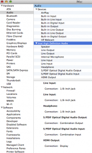

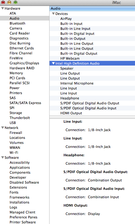

Using instructions I found elsewhere, I added the "Generic DSDT_HDMI_Audio_Edit" code from the thread's dsdt-hdmi_audio-v3.dsl into my DSDT.aml file. That then fully recognized my graphics card in "PCI Cards" and also added "HDMI Output" to my audio devices.
No edits were necessary to AppleHDA or AppleHDAController as my card's HDMI Audio Device_id, "30 aa", was already in the kexts.

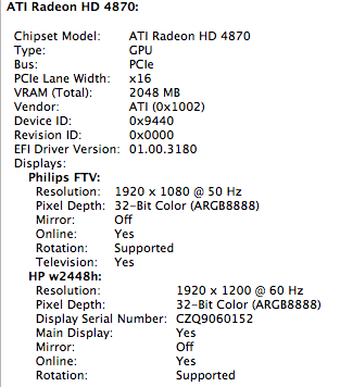

And my Graphics/Displays info from System Information. Nothing shows up under PCI cards, though I have not yet tried your HDMI output fix above.
ATI Radeon HD 4800:
Chipset Model: ATI Radeon HD 4800
Type: GPU
Bus: PCIe
PCIe Lane Width: x16
VRAM (Total): 1024 MB
Vendor: ATI (0x1002)
Device ID: 0x9460
Revision ID: 0x0000
Displays:
L227W:
Resolution: 1680 x 1050 @ 60 Hz
Pixel Depth: 32-Bit Color (ARGB8888)
Main Display: Yes
Mirror: Off
Online: Yes
Rotation: Supported
VGA Display:
Resolution: 800 x 600 @ 60 Hz
Mirror: Off
Online: Yes
Rotation: Supported
