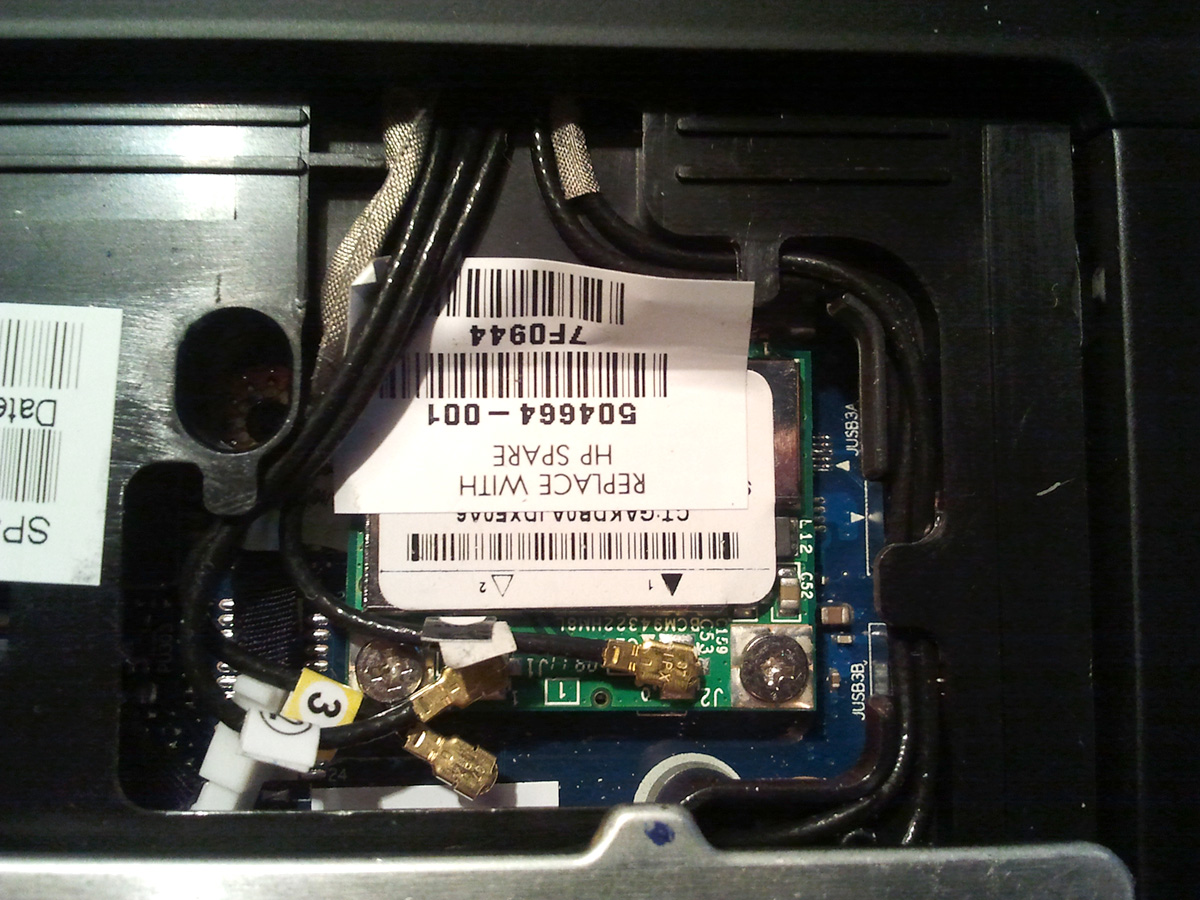

chofete Posted June 10, 2011 Share Posted June 10, 2011 But as far as I know that car only has two conectors... - What did you do with the thirth one? - How did you connect it? - Did you do anything extra? - Why are you selling 4 of them on ebay? - What is the exact model that works? - Could you post a link of the proper card that could work? Greetings. - I only connect the number one and number two, the third is not connected. These connectors are for the antenna, Intel 6300 has 3 connectors. - Connecting the card is very easy. First you must remove 3 screws from the bottom (the three screws with the keyboard drawing near them). Second you must get out the keyboard, there are some sliders between ESC and F1 keys, F4 and F5, F8 and F9, F12 and Insert. These sliders can be moved down very easy. After it, keyboard can be removed, but take care with it, there is sensitive cable, take care not to broke it. Down the keyboard there are two memory slots and.... WIFI CARD !!!! Removing the wifi is easy too, remove the three connectors, the two screws and the card goes up with an 45 degree angle. To put the newer one is the same but in inverse mode. - I didn´t do anything more, it is recognized at start like the airport, but i will make a newer install (right now i´m testing lion too). - I was selling (it overs yesterday, no one sold ) four or five cards but no one of them are the Broadcomm 94322 HALF mini Pci-e . The other cards i´ve got comes from other laptops i recently have and hack. I bought some cards from Hong Kong because i usually make hackintosh to friends and other people, and it spends three of four weeks to arrive from China to Spain. - Exact model is: Broadcom BCM 94322 HALF mini Pci-e . If you can found the one from HP i suppose it is better. The card must be HALF because the hole where it fits are only for half cards. All the cards i´m trying to sell are full cards, not half. I tried to connect them on the WWAN slot and in the WLAN slot (with the keyboard out) and no one works. On WWAN laptop starts but it isn´t recognized (included windows), on Wlan laptop gets error 140. - The link can be founded on ebay search, but it is hard. I found that this card works because i downloaded two weeks ago a HP dissasembly manual and inside this pdf i founded the three only wifi cards compatibles with the whitelist bios on 8540w. Link to comment Share on other sites More sharing options...

ed_co Posted June 13, 2011 Share Posted June 13, 2011 - I only connect the number one and number two, the third is not connected. These connectors are for the antenna, Intel 6300 has 3 connectors. - Connecting the card is very easy. First you must remove 3 screws from the bottom (the three screws with the keyboard drawing near them). Second you must get out the keyboard, there are some sliders between ESC and F1 keys, F4 and F5, F8 and F9, F12 and Insert. These sliders can be moved down very easy. After it, keyboard can be removed, but take care with it, there is sensitive cable, take care not to broke it. Down the keyboard there are two memory slots and.... WIFI CARD !!!! Removing the wifi is easy too, remove the three connectors, the two screws and the card goes up with an 45 degree angle. To put the newer one is the same but in inverse mode. - I didn´t do anything more, it is recognized at start like the airport, but i will make a newer install (right now i´m testing lion too). - I was selling (it overs yesterday, no one sold ) four or five cards but no one of them are the Broadcomm 94322 HALF mini Pci-e . The other cards i´ve got comes from other laptops i recently have and hack. I bought some cards from Hong Kong because i usually make hackintosh to friends and other people, and it spends three of four weeks to arrive from China to Spain. - Exact model is: Broadcom BCM 94322 HALF mini Pci-e . If you can found the one from HP i suppose it is better. The card must be HALF because the hole where it fits are only for half cards. All the cards i´m trying to sell are full cards, not half. I tried to connect them on the WWAN slot and in the WLAN slot (with the keyboard out) and no one works. On WWAN laptop starts but it isn´t recognized (included windows), on Wlan laptop gets error 140. - The link can be founded on ebay search, but it is hard. I found that this card works because i downloaded two weeks ago a HP dissasembly manual and inside this pdf i founded the three only wifi cards compatibles with the whitelist bios on 8540w. Hola Chofete, Yo también soy español. Hablaré en inglés por educación a los demás. There are several 94322 wifi cards. Could you please take a photo from yours in order to see what is exactly your card? Dissasembly the keyboard is a matter of 2 minutes, please. The error 140 is only when you connect the card in thw wwan or always? Cheers. Link to comment Share on other sites More sharing options...
ed_co Posted June 13, 2011 Share Posted June 13, 2011 - I only connect the number one and number two, the third is not connected. These connectors are for the antenna, Intel 6300 has 3 connectors. - Connecting the card is very easy. First you must remove 3 screws from the bottom (the three screws with the keyboard drawing near them). Second you must get out the keyboard, there are some sliders between ESC and F1 keys, F4 and F5, F8 and F9, F12 and Insert. These sliders can be moved down very easy. After it, keyboard can be removed, but take care with it, there is sensitive cable, take care not to broke it. Down the keyboard there are two memory slots and.... WIFI CARD !!!! Removing the wifi is easy too, remove the three connectors, the two screws and the card goes up with an 45 degree angle. To put the newer one is the same but in inverse mode. - I didn´t do anything more, it is recognized at start like the airport, but i will make a newer install (right now i´m testing lion too). - I was selling (it overs yesterday, no one sold ) four or five cards but no one of them are the Broadcomm 94322 HALF mini Pci-e . The other cards i´ve got comes from other laptops i recently have and hack. I bought some cards from Hong Kong because i usually make hackintosh to friends and other people, and it spends three of four weeks to arrive from China to Spain. - Exact model is: Broadcom BCM 94322 HALF mini Pci-e . If you can found the one from HP i suppose it is better. The card must be HALF because the hole where it fits are only for half cards. All the cards i´m trying to sell are full cards, not half. I tried to connect them on the WWAN slot and in the WLAN slot (with the keyboard out) and no one works. On WWAN laptop starts but it isn´t recognized (included windows), on Wlan laptop gets error 140. - The link can be founded on ebay search, but it is hard. I found that this card works because i downloaded two weeks ago a HP dissasembly manual and inside this pdf i founded the three only wifi cards compatibles with the whitelist bios on 8540w. Hola Chofete, Yo también soy español. Hablaré en inglés por educación a los demás. There are several 94322 wifi cards. Could you please take a photo from yours in order to see what is the model you own? I wanna make sure that I buy works. Dissasembly the keyboard is a matter of 2 minutes, please. The error 140 is only when you connect the card in thw wwan or always? One thing more, are you keeping the same usb3 KP from time to time or you solved it? Do you have any firewire problem in the logs after wake up (besides the keyboard)? Thanks and greetings. Link to comment Share on other sites More sharing options...

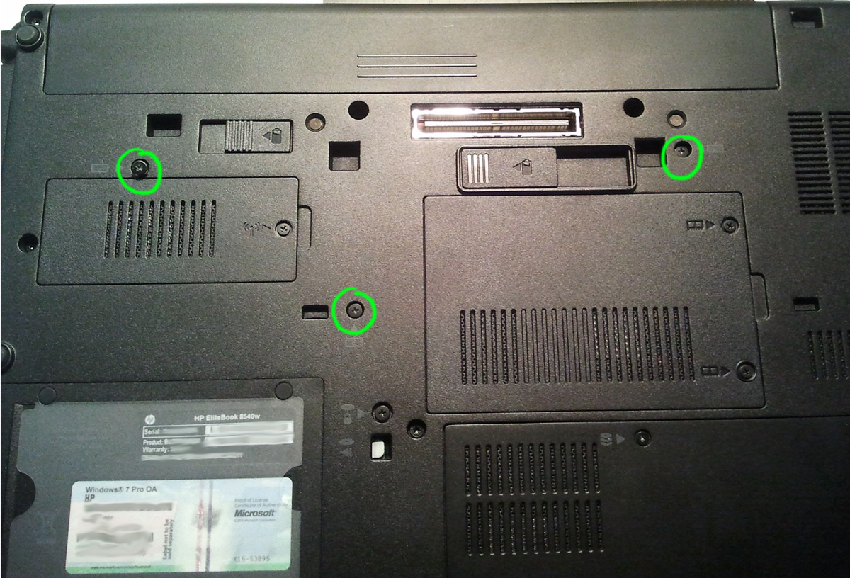

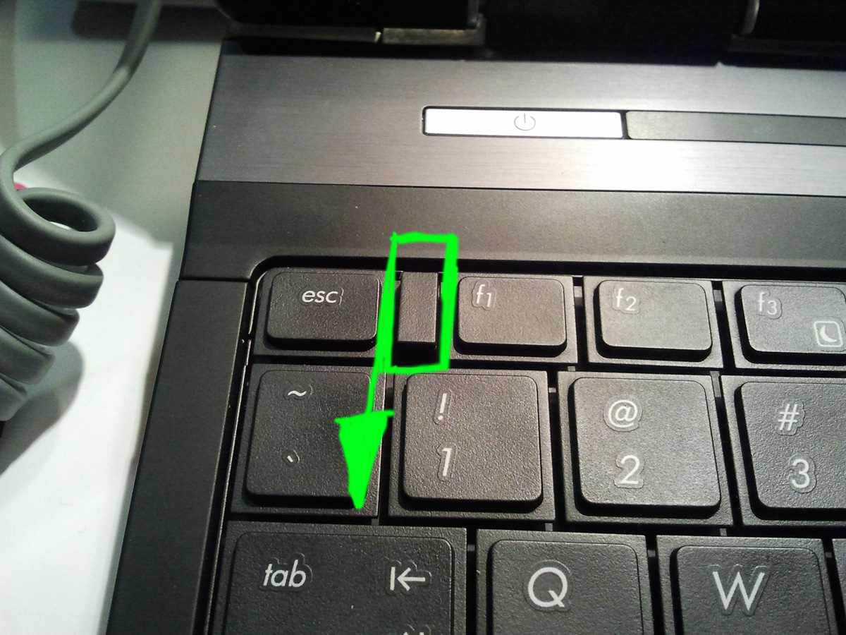

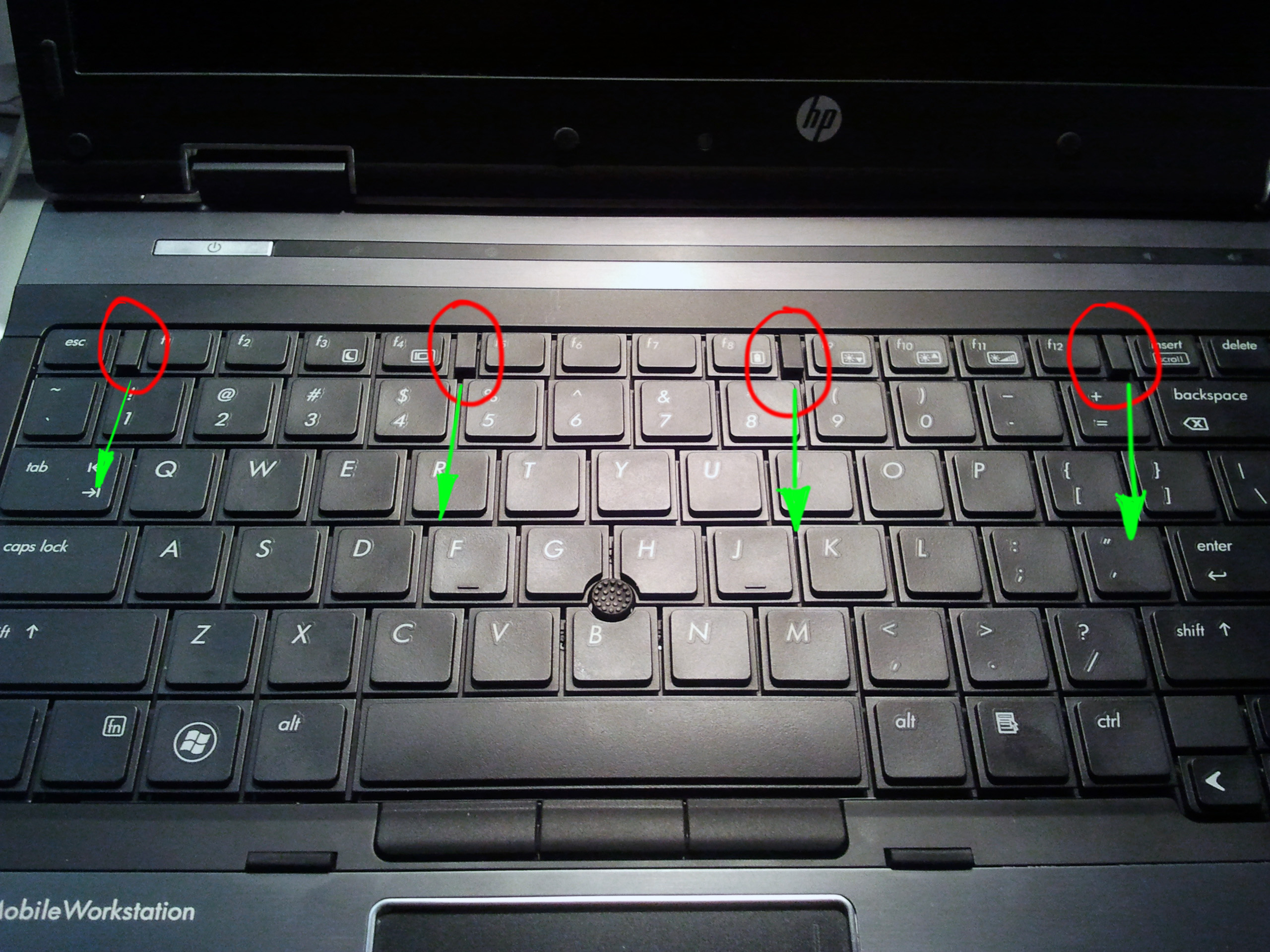

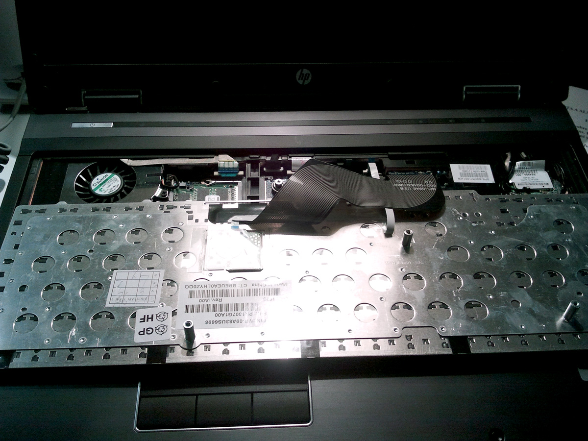

chofete Posted June 14, 2011 Share Posted June 14, 2011 I´m going to explain how to make wifi working on this laptop with a mini tutorial with photos (ed_co ask me to do it), so here i go. First of all is necessary to have a Broadcomm BMC 94322 a/b/g/n Half mini PCi-express wifi card. You can found it on eBay. (Photo of the card at the end). We need to put our laptop on the bottom side to unscrew the three keyboard screws. It is not necessary to unscrew to the end. Now we put the laptop on the top side and we open it. Now we must slide the four sliders between Esc and F1 keys, F4 and F5, F8 and F9, F12 and Insert. Now it´s time to remove the keyboard very carefully, i do it rotating it to myself. After it, now we can see the Intel 6300 wifi card at the upper right side, with three wires connected. Disconnect all the wires and unscrew the card. (On the photo i have the broadcom on it). Now it´s time to replace the Intel card with our new broadcomm and follow the steps back. P.D.: ed_co i tried to send you a mail but your inbox is full. Link to comment Share on other sites More sharing options...
ed_co Posted June 14, 2011 Share Posted June 14, 2011 I´m going to explain how to make wifi working on this laptop with a mini tutorial with photos (ed_co ask me to do it), so here i go. First of all is necessary to have a Broadcomm BMC 94322 a/b/g/n Half mini PCi-express wifi card. You can found it on eBay. (Photo of the card at the end). We need to put our laptop on the bottom side to unscrew the three keyboard screws. It is not necessary to unscrew to the end. Now we put the laptop on the top side and we open it. Now we must slide the four sliders between Esc and F1 keys, F4 and F5, F8 and F9, F12 and Insert. Now it´s time to remove the keyboard very carefully, i do it rotating it to myself. After it, now we can see the Intel 6300 wifi card at the upper right side, with three wires connected. Disconnect all the wires and unscrew the card. (On the photo i have the broadcom on it). Now it´s time to replace the Intel card with our new broadcomm and follow the steps back. P.D.: ed_co i tried to send you a mail but your inbox is full. First of all thank you very much. I knew how to dissasembly it, but maybe for some people should be really useful, that is great. You said the ebay card linked before is the same than yours. That's not true. See the conector one and two are inverted (your connector 1 is on the left, and in the ebay link is on the right). Maybe is not really important, but just in case. Another thing that I want to ask you is, are you in the USA? I mean, your card is the 504664-001, and 001 use to be the USA version and the 002 the european version... So, I am kind of confused why is working (if you are in Spain)... is it supposed that can't. Thanks again. Link to comment Share on other sites More sharing options...
chofete Posted June 14, 2011 Share Posted June 14, 2011 First of all thank you very much. I knew how to dissasembly it, but maybe for some people should be really useful, that is great.You said the ebay card linked before is the same than yours. That's not true. See the conector one and two are inverted (your connector 1 is on the left, and in the ebay link is on the right). Maybe is not really important, but just in case. Another thing that I want to ask you is, are you in the USA? I mean, your card is the 504664-001, and 001 use to be the USA version and the 002 the european version... So, I am kind of confused why is working... is it supposed that can't. Thanks again. I´m on Spain, on Madrid. I bought the laptop on eBay to a USA seller. I don´t know if it matters, but may be you are right. What i know is that it works well with all networks here on Spain and its recognized by my laptop. Right now i have received a Qualcomm WWAN and i´m trying it now, on Windows 7 it works but on Snow Leopard i can see it on About this Mac, i need to test it more to see if it works at the end (i suppose that it will not). EDIT: I have tried your config, i have needed to erase voodoohda from S/L/E. At first boot i saw a difference, you have orange icons (external hard drives), i mean that i have connected a external sata and it has orange icons. The solution is IOAHCIBlockStorage.kext. Other thing more is the nVidia fx 880, but i realized that the problem is not in Extra, it is on the boot file. I install latest chimera (new chameleon mixed), and now it is full recognized. I think this config is best than the other i was using. Battery well recognized. I just only miss the screen brightness control. I was looking but no lucky, i saw utilities to control brightness but it was a fake solution (like putting black transparent over the image). On your config i saw mouse (touchpad) works a little better (not too speedy). Audio works, but last night i play a youtube video with system audio muted and the video sounds. It was strange, so i will try later if it is doing it always. Link to comment Share on other sites More sharing options...
