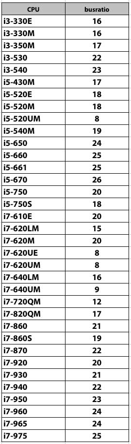

try adding the following switches:
cpus=1 busratio=XX
XX is a number - look at the image I attached <CREADITS 3rr0rists.net>
If iBoot not working well try other bootcd like Nawcom and Chameleon boot loader using an installer from windows.
1 more thing - Nawcom have USB booting method (i haven't tried), but i know for most of the bootloader works only WHEN THEY BURNED ON CD/DVD...

I don't own the particular PC you need help with, but I own a PC with a setup that matches a bit. I have the same CPU, 4GB RAM, ATI HD5650/Intel HD Graphics, and I use EmpireEFI Legacy Boot CD to get into the install DVD. At drive select, I mark Mac OS X Install DvD, and then type -v busratio=19 cpus=1.
That worked for me. Try it.

View Postdetri mental, on May 2 2011, 12:08 PM, said:
MSI GX660 i5 460M???
is it really 460M? or 430M?  anyway, using night_mare007's list get the right bus ratio and try this at boot "-v -x cpus=1 maxmem=2048 busratio=xx"
