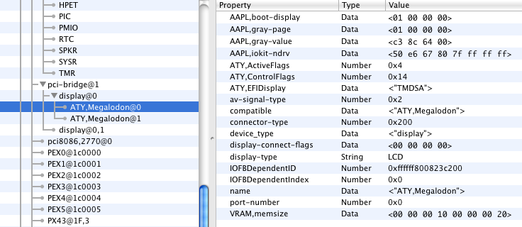

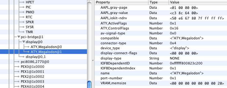

Your personality looks very close to mine. May I have your System Profiler output and ioreg dump?
I'd like to see how OS X detect your card.
Thanks.
my ioreg looks very similar to yours, but you can get HDMI, VGA working, Also you can get your LVDS working as a second VGA.
But bottom line is i will be very surprised if someone gets LVDS to work and recognize correctly without new version-ed drivers. just does not work, the support must not be there, even RadeonFramebuffer cannot load it so doing it manually wont work either. i guess we wait till further drivers and stick with dodgy way of doing it like me :rolleyes:

Attached File  110328_034231.jpg   403.44KB   33 downloads
Based on this picture, I know the controller or framebuffer kexts is not loaded (ATI6000Controller.kext ???). If possible, setup remote connection. Connect remotely via vnc & check whether controller & framebuffer kexts are loaded or not.
