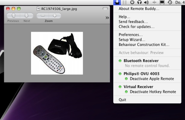

We all here wont to make our iHac´s to look and behave like original iMac as much as possible.
After perfect 10.6.2 install, I am focusing on Hardware now:
First step was case modding in one G5. Done!
Second one was Alu keyboard and Magic Mouse. Done!
As we all know that the newest iMacs have IrDA Receiver build in, to be able to use Apple iRemote,
I decided that would be my third step to do.
My company bought several iMacs last year and nobody use Apple iRemote, so I have just borrowed one!
I was lucky to find appropriate USB MCE Receiver in one secondhand shop for a few €!
After Software install, "Remote Buddy" recognized the MCE Receiver immediately as "Philips® OVU4003"
and was ready to use!
In System Profiler under USB, Receiver is recognized as "eHome Infrared Transceiver" with ProductID 0x0815,
and VendorID 0x0471 (Philips Consumer Electronics).
But, I must confess that I tried several USB IrDA Dongles with MCS7780 Chipset, but without success.
I am satisfied with "Remote Buddy" Software witch support a huge list of hardware:
http://www.iospirit.com/products/remotebuddy/hardware/
Now I can play not only the Front row, this software allows you to use it with fast all Mac Software!
One step closer to original, again!
Cheers
QuattroFX

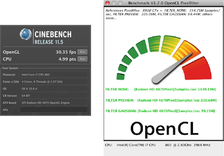

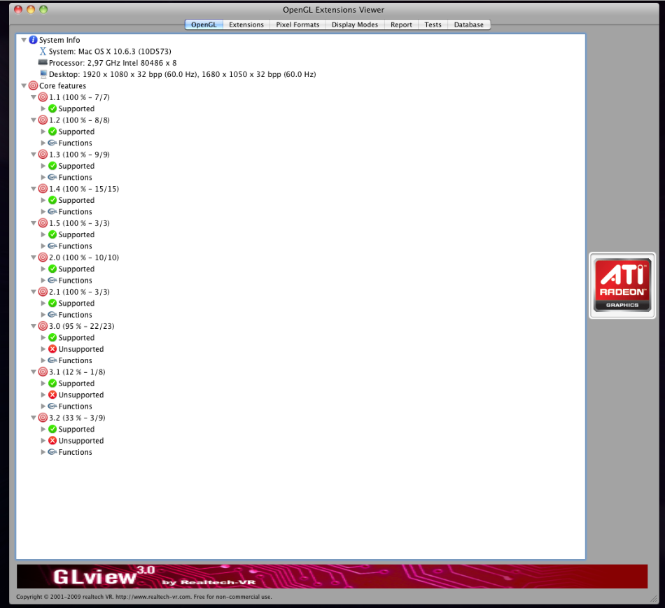

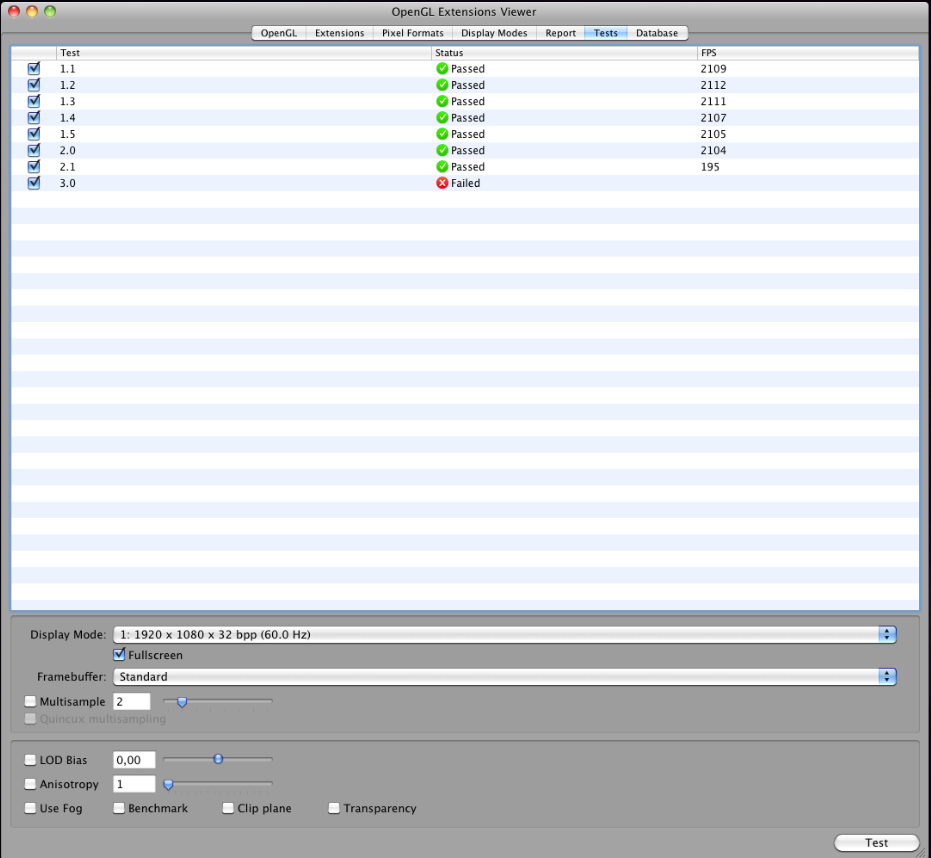

Phoronix posted interesting article on Netkas.org about OpenGL performance decreases in 10.6.3 comparing to 10.6.2, but a lot of people confirm that seams to be opposite!!!
In my case several Benchmark tests showing 20% increase! I am doing some more tests, will reply it later.

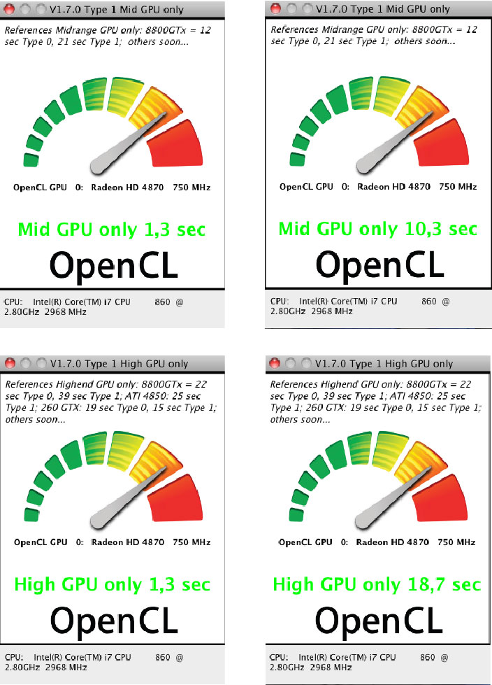

The Story begins now!!!
My insides:

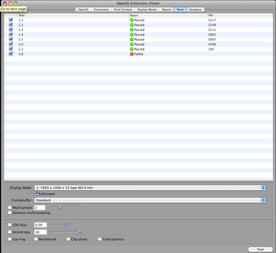

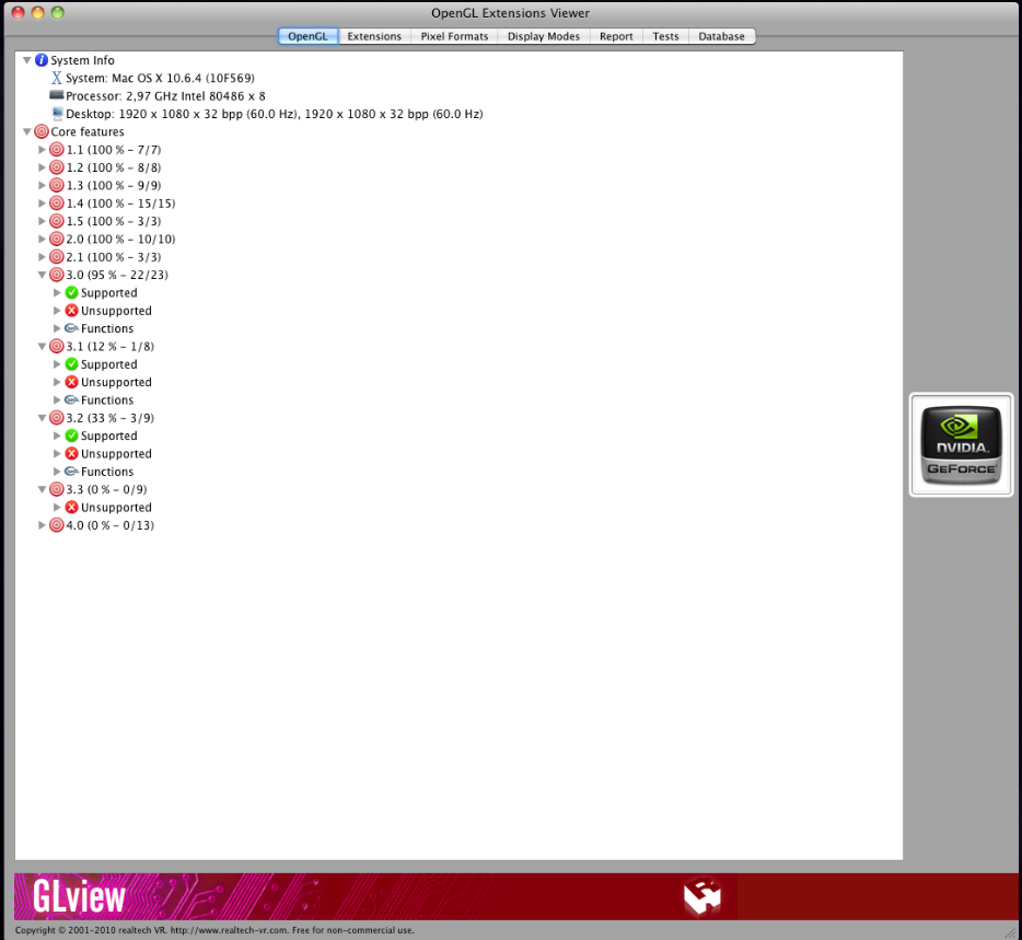

Ok, my system Snow 10.6.4 should already have a support for GTX 285, and I am using Netkas EFI 10.6 witch has already Efi strings inside. (To be sure, I have downloaded newest Nvidia drivers, NVInject64 and Cuda 3.1 drivers, maybe I will need it later...will see..).
I have just replaced Ati with NVidia and rebooted...... And, voila, everything works perfect!
Dual 24" Monitoring, all resolutions, System Profiler shows everything right! After log-in first thing was to make some Tests.... OpenGL first:
It was amazing! Scores from ATI was:

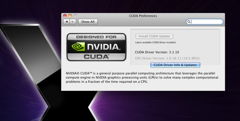

To be able to make some more tests, i need to install Cuda drivers:
I was so excited (leaved test for later) and started Premiere CS5! Opened my last Footage with 4 camera Sequence
where my good old ATI HD 4870 was already overloaded, and? No need to render, everything playing smooth and easy! Every layer has Keying effect! Line is still yellow!
Wonted to be sure, under the Project preferences was chosen: "Mercury Playback engine Hardware Accelerated" !!!
As it should be! I have just started to play with this project adding more effects to see where will be the border of RT -

I installed Snow Leopard Graphics Update 1.0
It updates the Nvidia drivers from 19.5.8f01 to: 19.5.9f02 and CUDA will prompt for an update with these drivers (if you have CUDA installed) but an update is not available yet. This issue is well known on NVidia Forum but till now
without solution.
In my case I loose hardware accelerated Mercury playback engine in Premiere CS5. And need to reinstall Aperture.
After that I reverted to old 19.5.8f01 Apple driver and everything is OK as before.
Good news!
Aperture Update is out and Newest CUDA Driver 3.1.14 is out!
So I installed Graphics Update 1.0 again and updated Aperture & CUDA. After Update
everything works OK, but after some more tests no significant increase noticed. :o

Updated my System on 10.6.5 over Software Update without problems. As usual only AppleHDA needs to be reinstalled.
I have made some TESTS and can confirm a small increase in performance comparing to the state before:
http://www.insanelymac.com/forum/index.php...t&p=1539683
State now:
http://www.insanelymac.com/forum/index.php...t&p=1581361
Cheers
QuattroFX
