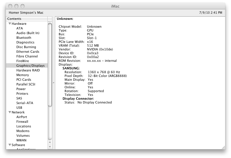

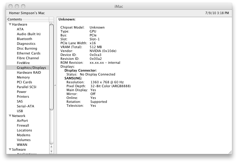

Hey all I have the drivers installed and am using a Palit GT240 512MB Nvidia card. What I dont see in the about this mac info, see pics (left DVI to HDMI in) (right HDMI to HDMI in), is that it is a recognized chipset or vendor?. Also HDMI out to my Samsung Television just gives me a blue screen?
Does anyone have any ideas on how to get the about this mac stuff straight or doesnt it really matter? Is it just cosmetic? Also the blue screen I get when I connect HDMI out to HDMI in on my Tele?
EDIT EDIT EDIT: Stopped working had to revert back to 7600GT. Lost nearly all resolution options, does anyone have any tips for installing the above mentioned card?
