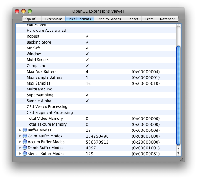

Hmm. I am using the G210M in my ASUS laptop and it has a different device id (0x0a74).
Although according to http://en.wikipedia.org/wiki/GeForce_200_S...82xxM.29_series we have the same core, so it shouldn't matter.
Before your EFI string, the resolution on my laptop is correct, but it doesn't recognize my external monitor. I couldn't tell about QE/CI: menus were transparent, but the usually effects were somewhat laggy.
Are you using ATY_init or not? Are you booting in 32 or 64 bit?
In any case, your EFI string didn't change my position.
As a side note, this card worked on Leopard with QE/CI, but caused frequent crashes.
When QE/CI works, your menu bar will also be transparent and blur your desktop picture behind it. I'm in 64 bit now without ATY_init anymore, but you could try running in 32 bit with ATY_init and see if you get anything. That would be a place to start I think.
I have gotten the translucent menubar, CI and QE in Leopard working at the right resolution. However any time I put the screen to sleep or use OpenGL in anyway, I get artifacts all over the screen and my ASUS with a G210M freezes up and I have to force reboot it. If I run a OpenGL test using "Apple Software Renderer" everything is fine, if I use "NVIDIA GeForce G210M OpenGL Engine" the computer freezes as I mentioned. I am using ATY_init.
External video also doesn't work. I have gotten it to partially work by plugging in both a VGA and HDMI cable at the same time, but the computer locks up within 10 seconds of showing the desktop.
I can always still move my mouse, but I can't do anything (changing windows, type etc)
Any advice?
edit:
When looking at the "Pixel Formats" tab of OpenGL Extensions Viewer, it says that I have 0 Total video memory.
