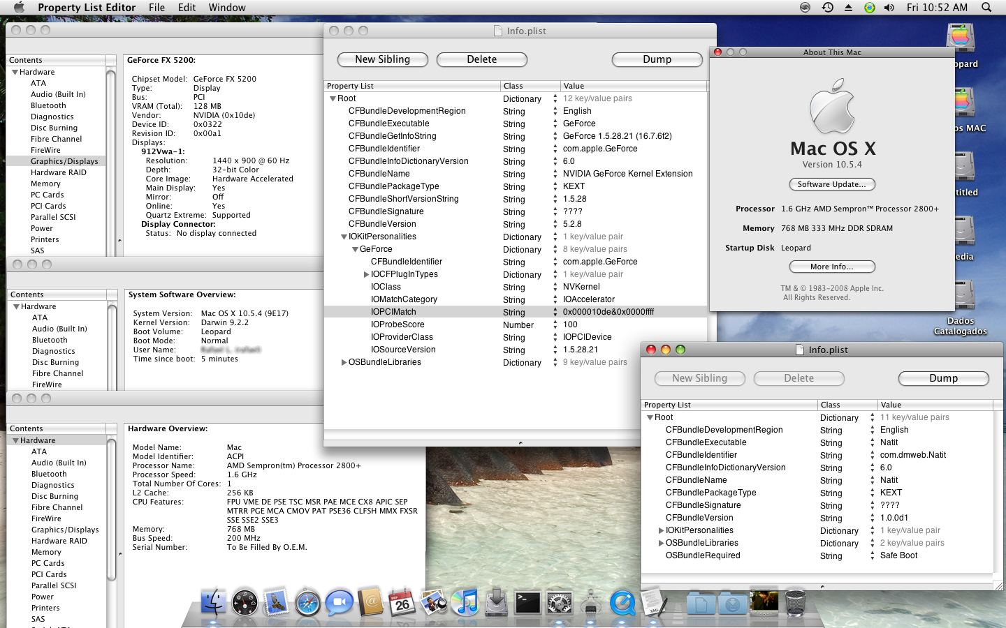

In this picture you can see my configs...
