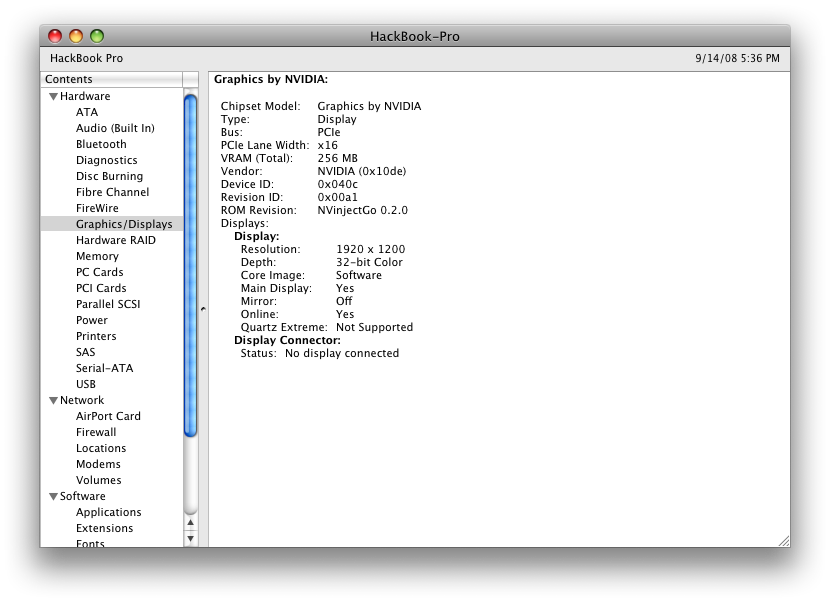

Stuikka Posted September 13, 2008 Share Posted September 13, 2008 Ok, NVinjectGo 0.2.0 seems to support 570m partially... I'm able to switch resolution from Display options, even got the full 1920x1200, but no CI/QE. Any ideas? Link to comment Share on other sites More sharing options...

b:z Posted October 15, 2008 Author Share Posted October 15, 2008 I load the same NVinject kext NVijectGo.0.2.0, however i just get resolution 1680 x 1050 and 32MB of VR ram, also no CI/QE supported Anyone got FX570 fully work? Link to comment Share on other sites More sharing options...

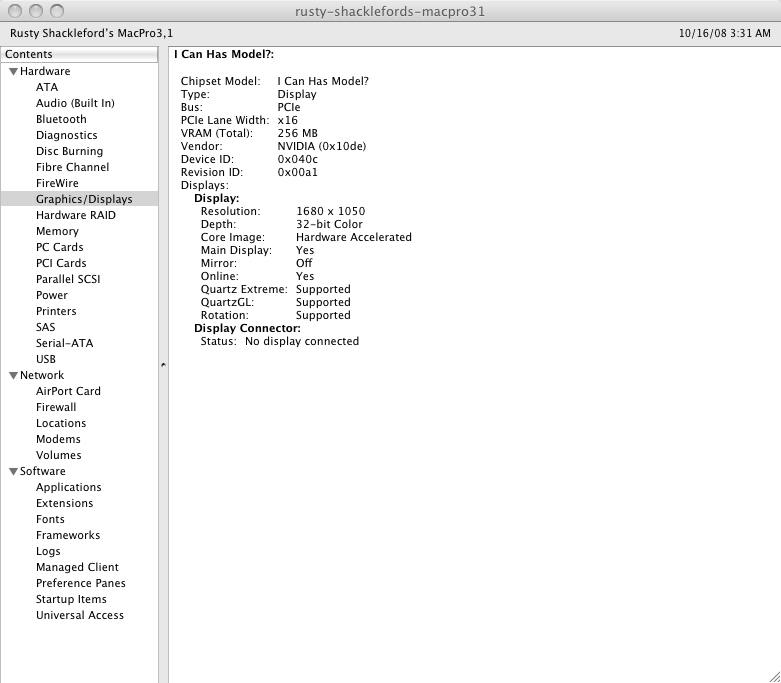

robstah Posted October 16, 2008 Share Posted October 16, 2008 Hey guys. I have been running my HP 8510p with the 570m for some time now. I was able to swap the graphics card out for the Quadro, and also swapped out the Intel wifi for Broadcom, which got the wireless working. Right now, I have full support with the video card (CI/QE/resolution change) and have yet to try plugging in a monitor for the HDMI or VGA port. Now, the main issue I run into is closing the lid. Doing so freezes the laptop. It doesn't change the monitor source, it physically freezes it. I do not see any evidence in the logs either. Maybe if we work together and figure this out, we can get everything working. I am leaning towards a mix of incorrectly detected display and possible ACPI kext issues. To get to my stage, install iDeneb v1.1 10.5.4. You can either use the NVinjectGo that is bundled with it, or skip it and install NVkush. Both seemed to get me the full hardware support. Link to comment Share on other sites More sharing options...
