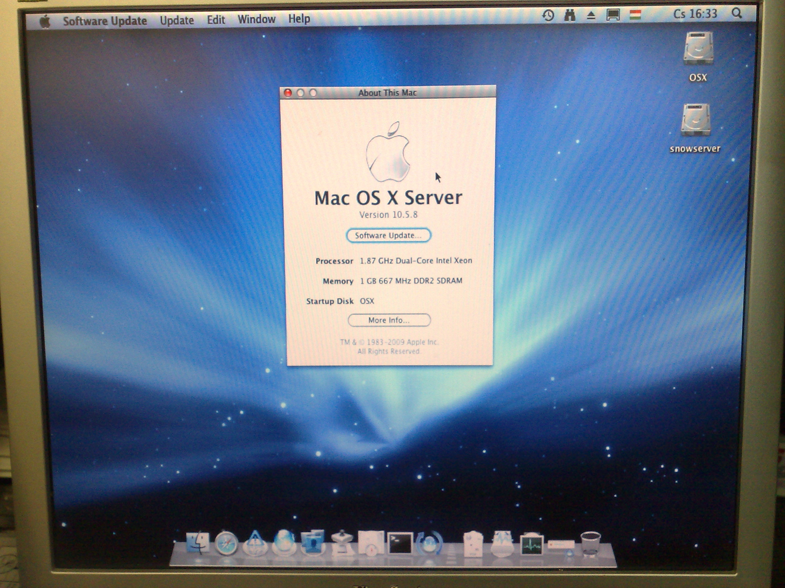

splonk Posted October 1, 2009 Share Posted October 1, 2009 The guide I posted in Tutorials is taking a while to appear, so here is the first part of the guide I knocked together for getting Leopard/Leopard Server up and running on the HP Proliant m110 G5. If you have a different model, this is not guaranteed to work. If you want Snow Leopard/Snow Leopard Server, then head over to the 10.6 forum where I have uploaded the second part of the guide. This guide assumes some basic knowledge of both OSX and OSX86, so won't go into details about installing Chameleon or creating Boot-132 disks. There are ample guides on this forum for that. Tech specs: HP M110 G5 with Dual-Core Xeon 3065 (2.33GHz) ICH9 motherboard based on Intel 3200 reference (I think) Onboard Matrox G200e VGA out 2GB EEC DDR Ram Broadcom NetXtreme Gigabit Network port (BCM5722) 3 free PCIe x8 slots and 1 PCI 3.3v slot Additional Hardware added: Gainward GeForce 8400GS low profile PCIe passively cooled. PCIe x16 to x8 adapter riser card 2GB EEC DDR2 Ram Marvel Yukon 8053 Gigabit Ethernet PCIe PART ONE: Leopard Client/Server Required: Boot -132 disk. Generic will do. Add updated AppleIntelPIIXATA.kext to Extensions for faster install. Leopard Server Retail Disk (10.5.4 used) Leopard Client Retail Disk (10.5.6 used) Internet connection through ethernet needed to complete server setup. The HP M110 G5 is an oddity in that it has 3 PCIe x8 slots and one 3.3V PCI slot, so you have to make some compromises in selecting hardware if you also want to use this as a workstation. The onboard graphics is a Matrox G200e which is useless (even under Windows) so a graphics card is a must. The onboard ethernet is not supported in OS X and nobody has succeeded in making it work so far. It appears to use different RAM addresses from BCM5721, which does work, so none of the quick fixes is enough to get this work. Source code for the Linux driver is available and I have compiled it to work under Ubuntu back in the day. If you fancy your chances as an OSX driver developer, be my guest. The problem with the x8 slots is that they are not open ended so your choice of graphics card is further limited. I had an old PCI FX5200. This works but is an ageing card and needs a hack to work (the full NVkush package). It does not prevent graphical glitches, such as dark areas in System Preferences, but might do if you only want to use this as a server. Note that Apple has removed support for FX5xxx cards in Snow Leopard, so you will have to upgrade it sooner or later I invested about £10 in a PCIe x16 to x8 adapter riser card This lifts the card a tad, so you need to look for a suitable low-profile card. I found the Gainward GeForce 8400GS, which had the added bonus of being passively cooled, thus keeping noise levels down. Eventually, I tired of the instability of the wobbly card and drilled a notch in the card so it would slot into the motherboard directly. Note that the server bios will automatically clock all PCIe graphics cards detected to x1 speed regardless. It is a server. If you want to use it primarily for gpu intensive workstation tasks (e.g. games), you need to look at other hardware. After failing to install via Kalyway etc, using boot 132 proved surprisingly easy. However, Leopard Server Install DVD causes a kernel panic, so the trick is to install the client and then the server packages on top. The newest server disk is two updates behind the client, but this caused no problems whatsoever. Just make sure before you start that you have a working internet connection via ethernet as installation will not complete without it. Installation: Boot from the Boot-132 disk and install Leopard client. I used a GUID partition on mine. So far, so good. Note that my boot disk linked here contains the EFI string for the 8400GS 512MB. If you have a different card, you might get some problems with your screen resolution. Now to install the server packages. Mount your Server Install DVD and then Cmd+Shift+G in Finder. Type /Volumes/Mac OS X Server Install Disc/System/Installation/Packages to navigate to the individual packages. install in this order: a) ServerEssentials.pkg ServerAdminTools.pkg c) ServerSetup.pkg d) QuicktimeStreamingServer.pkg (if you need it) Don't be tempted to try MacOSXServerInstall.mpkg. It will not work. Make sure your internet connection is up and running then reboot from the boot CD selecting your newly installed server. On starting go through the server setup including entering your serial number. You need the internet connection for this to be validated otherwise you will be stuck in a loop. Once past this point, select Software Update and you should see all the updates you need to proceed to version 10.5.7. Update away as none of the updates broke my installation. Shutdown and reboot work fine. Sleep doesn't at the moment, but servers probably are not designed for nodding off. Install Chameleon (I did it to an EFI partition) and use your boot CD's Extra folder for a permanent boot solution without swapping disks. Note that ServerAdminTools.pkg is also a free download from Apple directly if you want to administer your server remotely from any Apple client. for Leopard: Server Admin Tools 10.5.7 Link to comment Share on other sites More sharing options...
pretke Posted October 13, 2009 Share Posted October 13, 2009 Working!!! + update 10.5.8 + sec update.... all Thanx Link to comment Share on other sites More sharing options...

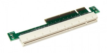

blouis79 Posted November 13, 2009 Share Posted November 13, 2009 The HP M110 G5 is an oddity in that it has 3 PCIe x8 slots and one 3.3V PCI slot, so you have to make some compromises in selecting hardware if you also want to use this as a workstation. I guess HP chose the low end expansion to stop a cheap server being upgraded to a workstation for a lot less money than a retail workstation. I got the bottom rung E2160 Pentium and swapped the CPU for a E8400 Core2Duo EVGA makes an 8400GS PCI card which works fine for h.264 HD content on Win7 and Linux. As far as I can find, it is the only one on the market that will decode h.264 on a PCI card. ML110 G5 specs are here - note 2 of the x8 slots are only x1 speed. http://h18000.www1.hp.com/products/quicksp...a/12867_na.HTML Expansion Slots: Slot 1: PCI 32-bit/33MHz at 3.3V Slot 2: PCI-Express x8 connector with x1 link Slot 3: PCI-Express x8 connector with x1 link Slot 4: PCI-Express x8 connector with x8 link Thanks for the tutorial - need to buy more cards now... Link to comment Share on other sites More sharing options...
splonk Posted November 29, 2009 Share Posted November 29, 2009 Just bear in mind that even the x8 slot, where I currently house my graphics card, will be clocked down to x1 if the bios detects a gpu. HP does not want workstations on the cheap, it seems. Link to comment Share on other sites More sharing options...
