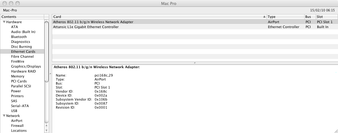

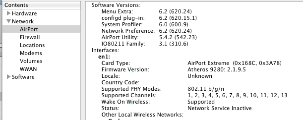

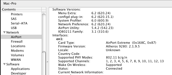

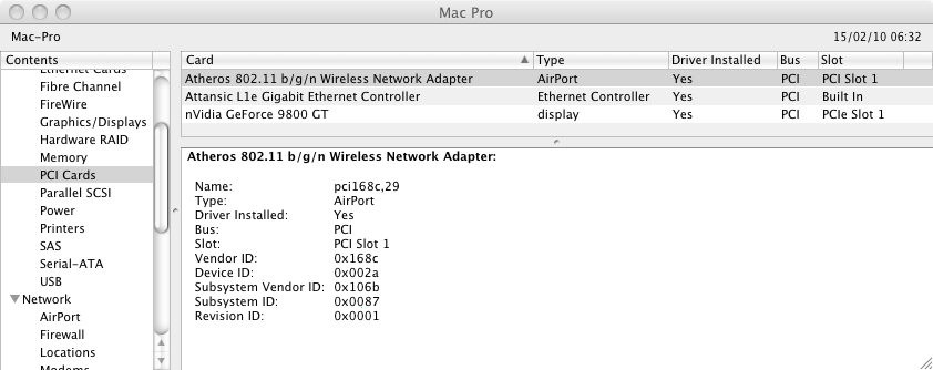

System Profiler:
Edit:

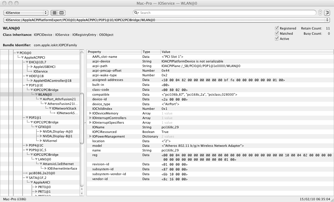

Done it with DSDT, no kext, but TheKing had already done here
so code working on my mobo is
                Device (WLAN)
                   Name (_ADR, Zero)
                   	Store (Package ()
                   		"AAPL,slot-name", Buffer () {"PCI Slot 1"},
                       	"class-code", Buffer () {0x00, 0x80, 0x02, 0x00},
                       	"device-id", Buffer () { 0x2A, 0x00, 0x00, 0x00 },
                       	"device_type", Buffer () { "AirPort" },
                       	"model", Buffer () {"Atheros 802.11 b/g/n Wireless Network Adapter"},
                       	"subsystem-id", Buffer () {0x87, 0x00, 0x00, 0x00},
                       	"subsystem-vendor-id", Buffer () {0x6B, 0x10, 0x00, 0x00},
                       	"vendor-id", Buffer () {0x8C, 0x16, 0x00, 0x00}
                       }, Local0)
                   	Return (Local0)
post-530549-1266211698_thumb.png post-530549-1266211766_thumb.png post-530549-1266212509_thumb.png post-530549-1266212327_thumb.png
My card is under P0P1, add the device where needed in DSDT.
