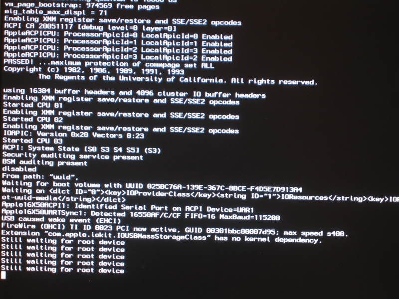

Digital Primate Posted April 2, 2008 Share Posted April 2, 2008 Hey all, Having trouble booting off Kalyway DVD 10.4.10. After setting up the bios, and booting from DVD, its hanging in Darwin. Heres a picture: http://i33.photobucket.com/albums/d66/katalys7/IMG_4642.jpg Its hanging on an extension.. "com.apple.iokit.IOUSBMassStorageClass" has no kernel dependency could it be the kext on that certain extension being corrupted? We've tried unplugging the USB keyboard/mouse and switching USB ports for keyboard and no luck. PLEASE HELP! EDIT: Heres our system specs.. Shuttle XPC SP35P2 Intel Core 2 Quad Q6600 LGA775 2.4GHz ASUS Silent 512MB GeForce8600GT 4GB RAM Link to comment Share on other sites More sharing options...
Digital Primate Posted April 2, 2008 Author Share Posted April 2, 2008 answering my own post here! HA! we got it working.. turns out the shuttle motherboard is a JMicron motherboard... the Kalyway ISO came with a Extensions.mkext JUST FOR JMicron! for anyone who has the same problem, heres what I did. extracted Extensions.mkext thats for JMicron/ICH8 mounted the ISO file thru terminal with -readwrite replaced Extensions.mkext reburned/rebooted and BAM! it booted Link to comment Share on other sites More sharing options...
