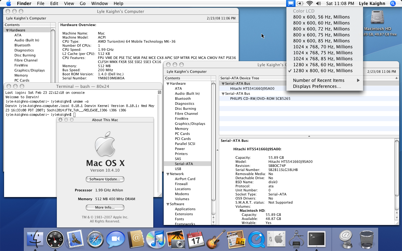

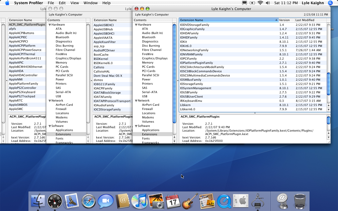

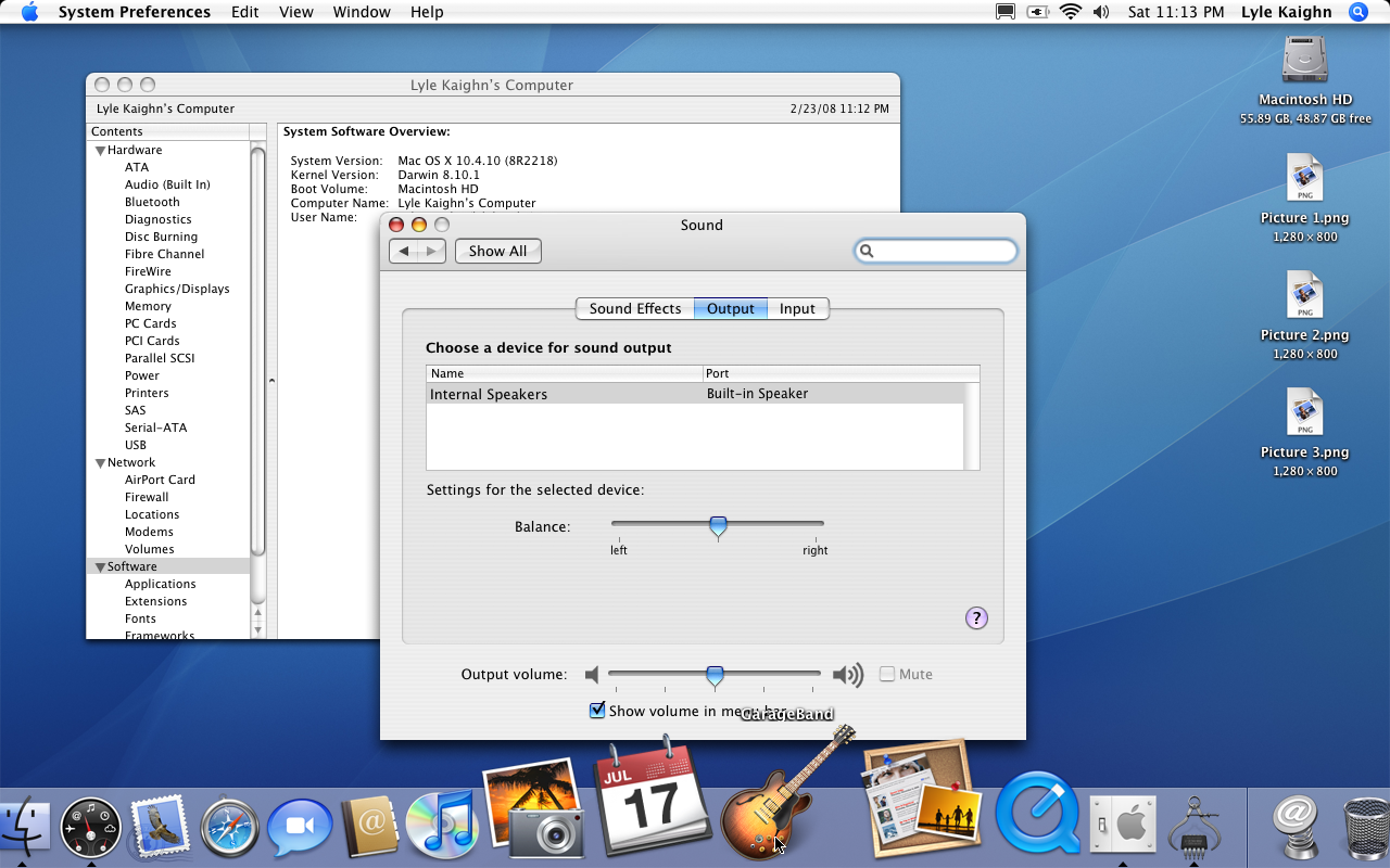

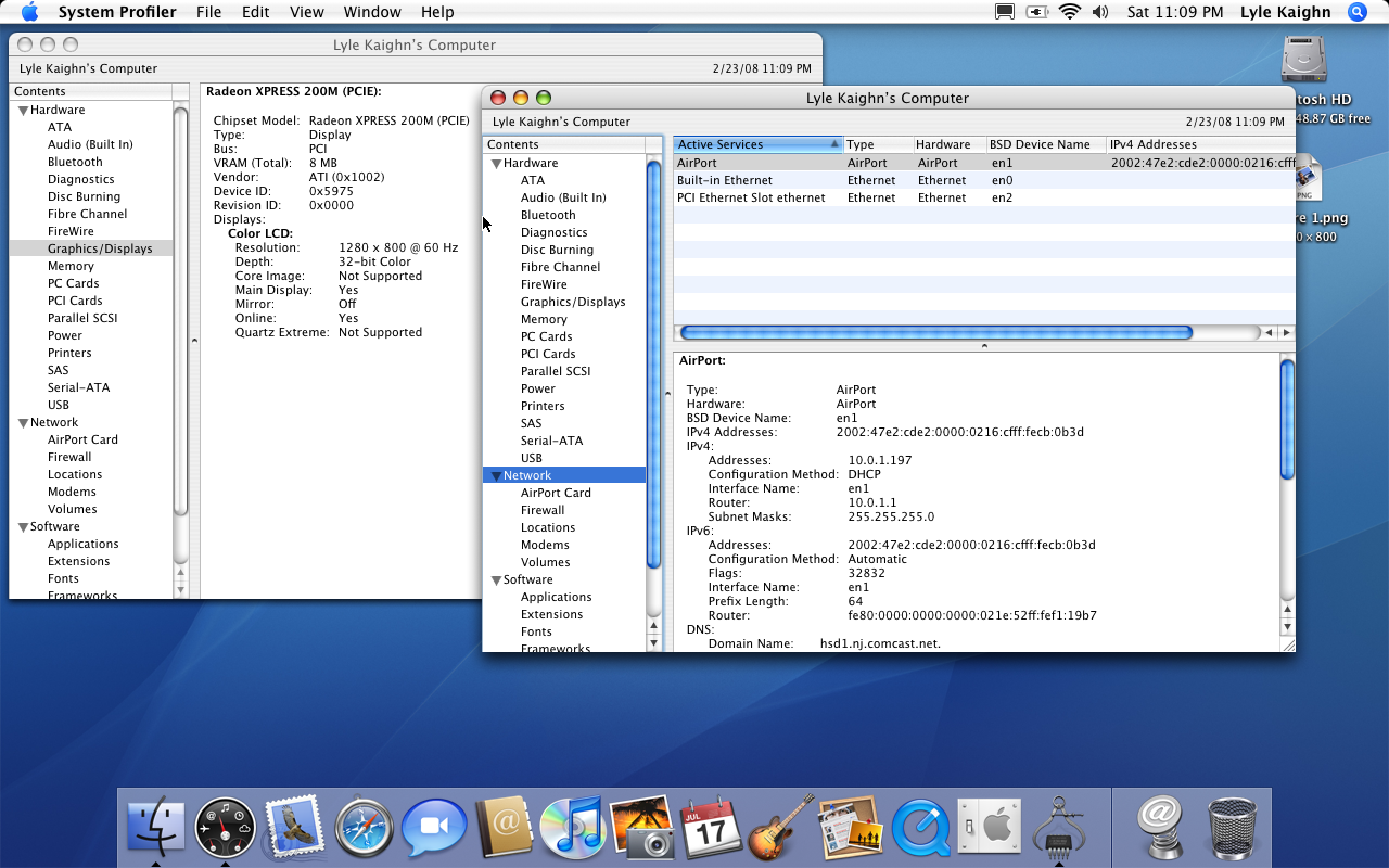

Slinger2g Posted February 24, 2008 Share Posted February 24, 2008 I have my friend's Dell Inspiron 1501 with everything working including SATA!!! That's right, sata. The only thing I don't have right now is QE/CI, which I am going to work my hardest to get working. Also, I have Photo Booth with a logitech quick cam communicate stx fully working. Posted screen shot's below: Link to comment Share on other sites More sharing options...

Slinger2g Posted March 2, 2008 Author Share Posted March 2, 2008 I installed it on a usb hdd first. Booted off that. Then moved AppleVIAATA.kext into IOATAFamily.kext. I had to add the dev/ven ID's to the VIA kext for the sata controller. Did the whole chown/chmod thing, and deleted mkext kextcache thing. Rebooted and bam! I then partitioned the internal hdd to MBR. Did a disk restore off the usb hdd to the internal hdd. Activated the partition in terminal and that was it. ~Sling Link to comment Share on other sites More sharing options...
