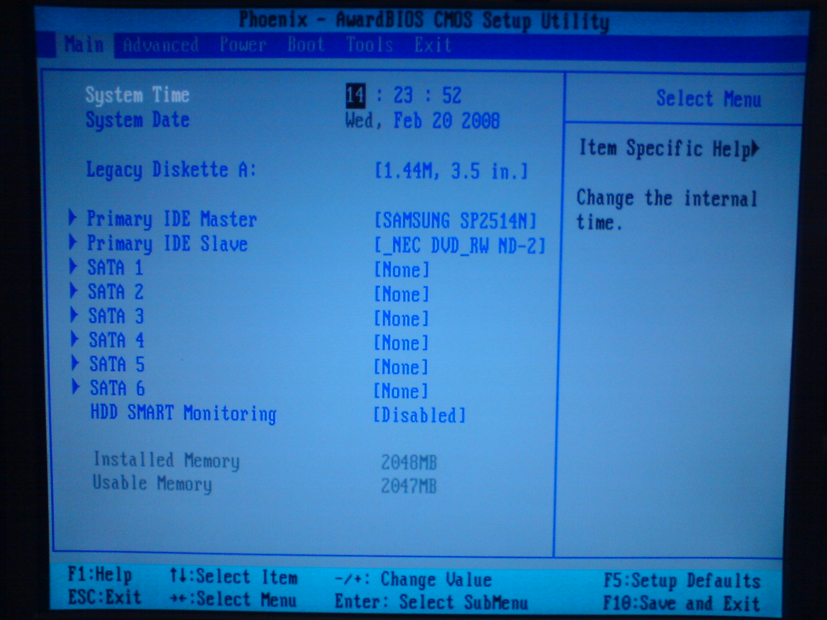

bigjoe Posted February 19, 2008 Share Posted February 19, 2008 Hello again everybody... i have got some problems installin osx 10.5.2 amd on my pc.... I have got: Motherboard: ASUS M2N -SLI DELUXE processor:Amd duocore 5000+ graphix card :Nvidia gforce 8600gts 1 ide harddrive so.. i loaded the dvd image an burned it 1x (slowest) when i iert the disk to instll leo (just pressing enter) there is no white screen like i saw it in some videos.... i know that it is possible with m mainboard..... the problem is , that its sometimes saying that it has a firewire error....it says: Error: FireWire unable to determinate security mode; defaulding to full secure ....after that it says that its a bad burned dvd...whats impossible...i burned it twice with differend programms.....on differend dvds......i made a video of my booting...... maybe thats more information video sorry for quality i hope u can help me...... Link to comment https://www.insanelymac.com/forum/topic/88672-need-some-help/ Share on other sites More sharing options...

Skyper Posted February 19, 2008 Share Posted February 19, 2008 Take a picture of ur bios Link to comment https://www.insanelymac.com/forum/topic/88672-need-some-help/#findComment-633054 Share on other sites More sharing options...
bigjoe Posted February 20, 2008 Author Share Posted February 20, 2008 so i made some: 1 2 3 4 i hope its enough to say what i have to change,.....and where Link to comment https://www.insanelymac.com/forum/topic/88672-need-some-help/#findComment-634006 Share on other sites More sharing options...

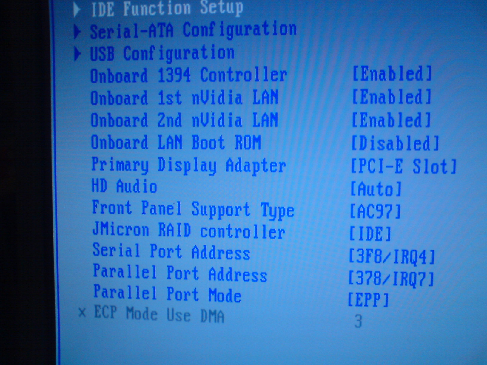

Skyper Posted February 23, 2008 Share Posted February 23, 2008 Ok go to Advanced tab and then go to ONBOARD device configuration. And then if you can plz take another pic. Link to comment https://www.insanelymac.com/forum/topic/88672-need-some-help/#findComment-639192 Share on other sites More sharing options...
bigjoe Posted February 24, 2008 Author Share Posted February 24, 2008 there you go ^^ Link to comment https://www.insanelymac.com/forum/topic/88672-need-some-help/#findComment-640651 Share on other sites More sharing options...
riiga Posted February 24, 2008 Share Posted February 24, 2008 Set OnBoard 1394 Controller to Disabled then Save to CMOS and you're done! Link to comment https://www.insanelymac.com/forum/topic/88672-need-some-help/#findComment-640753 Share on other sites More sharing options...
