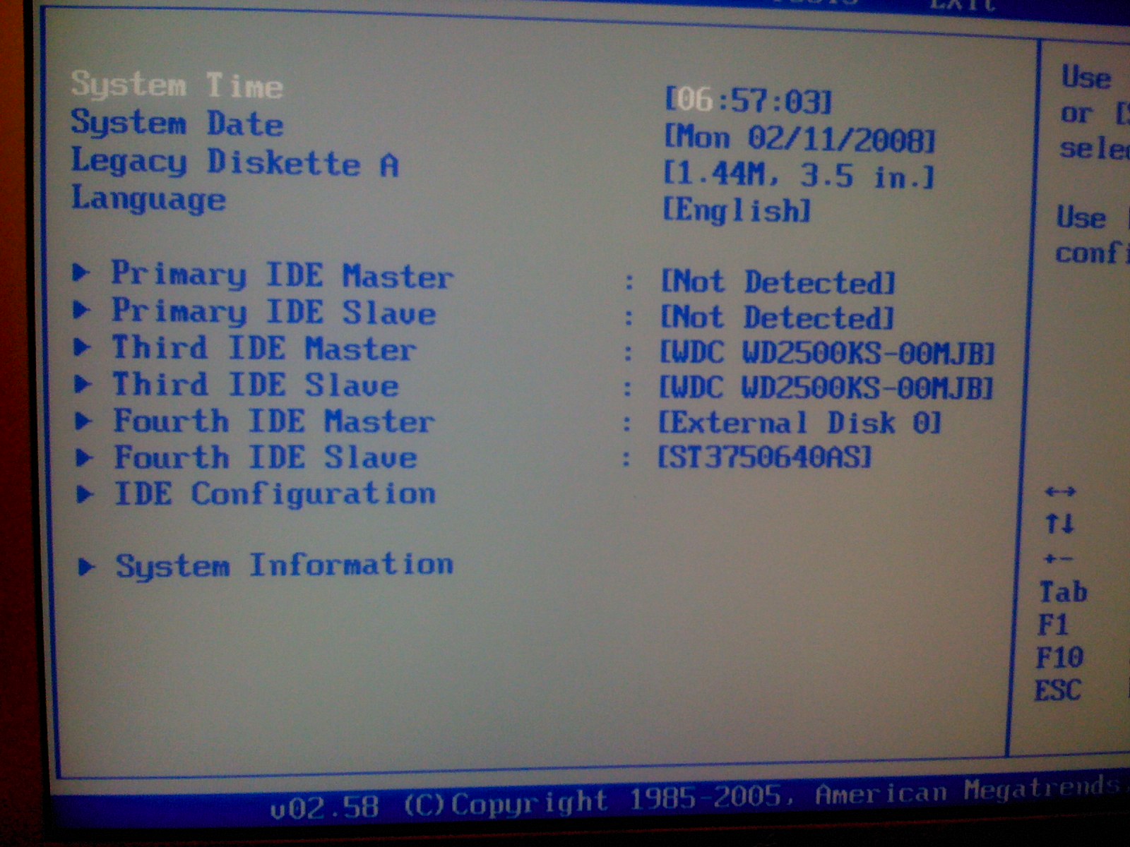

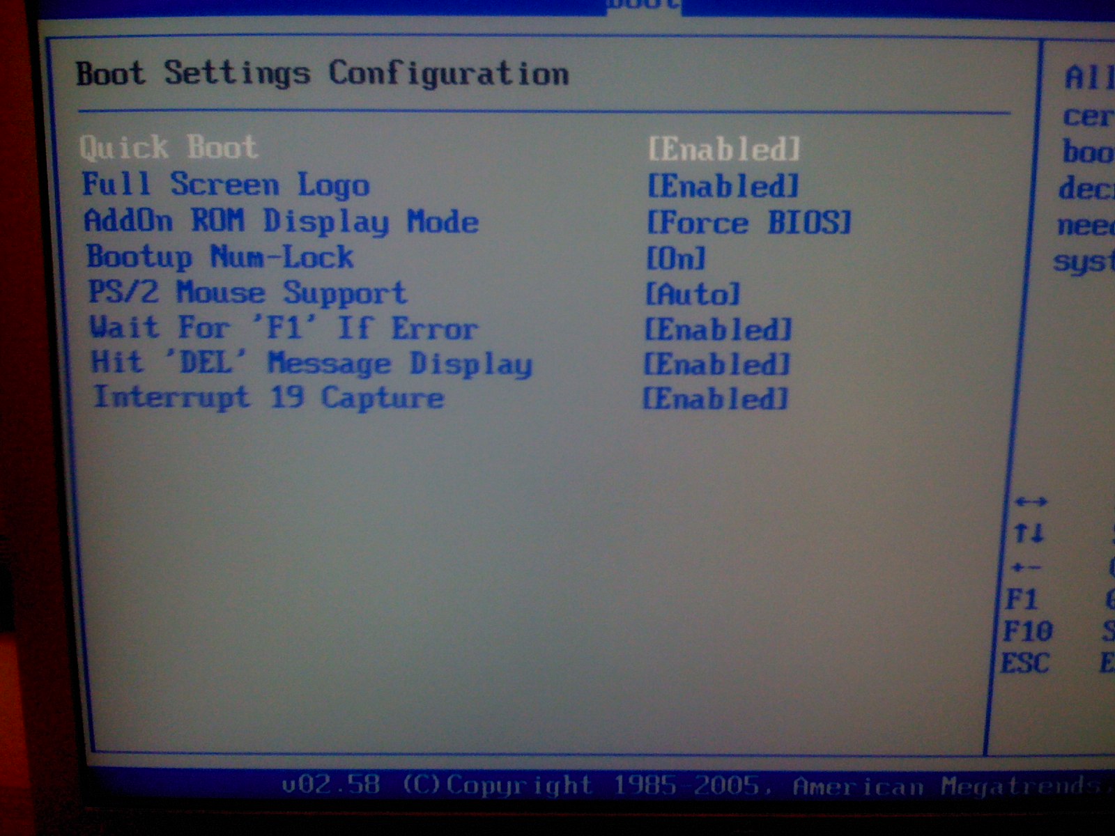

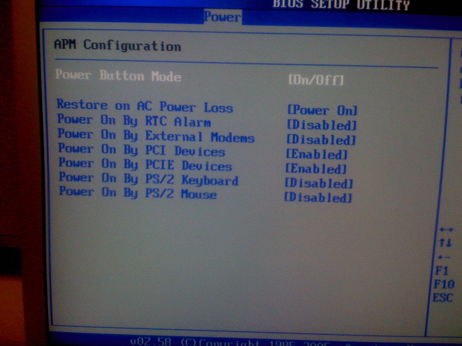

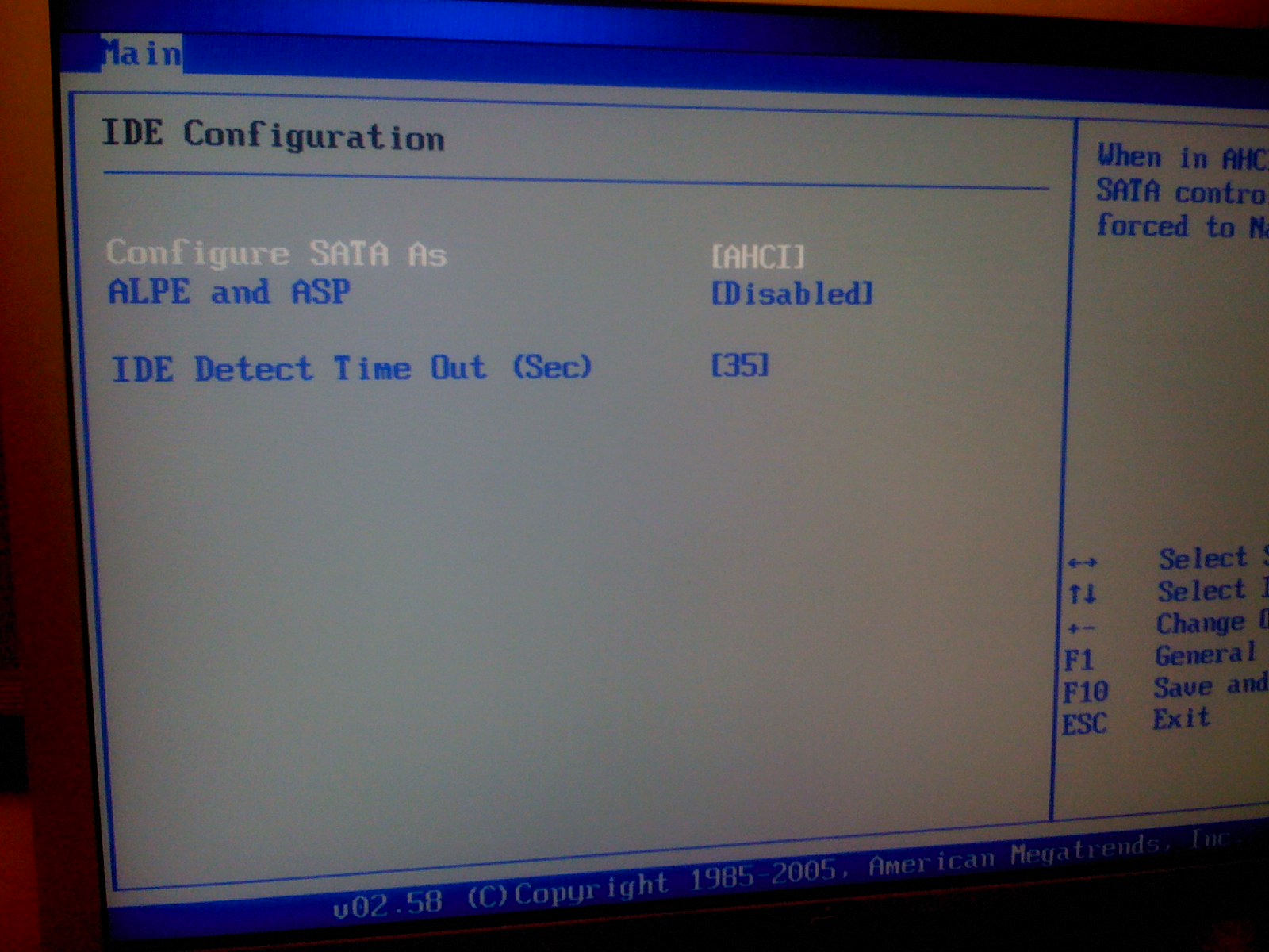

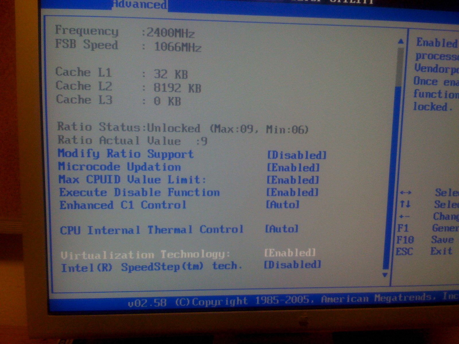

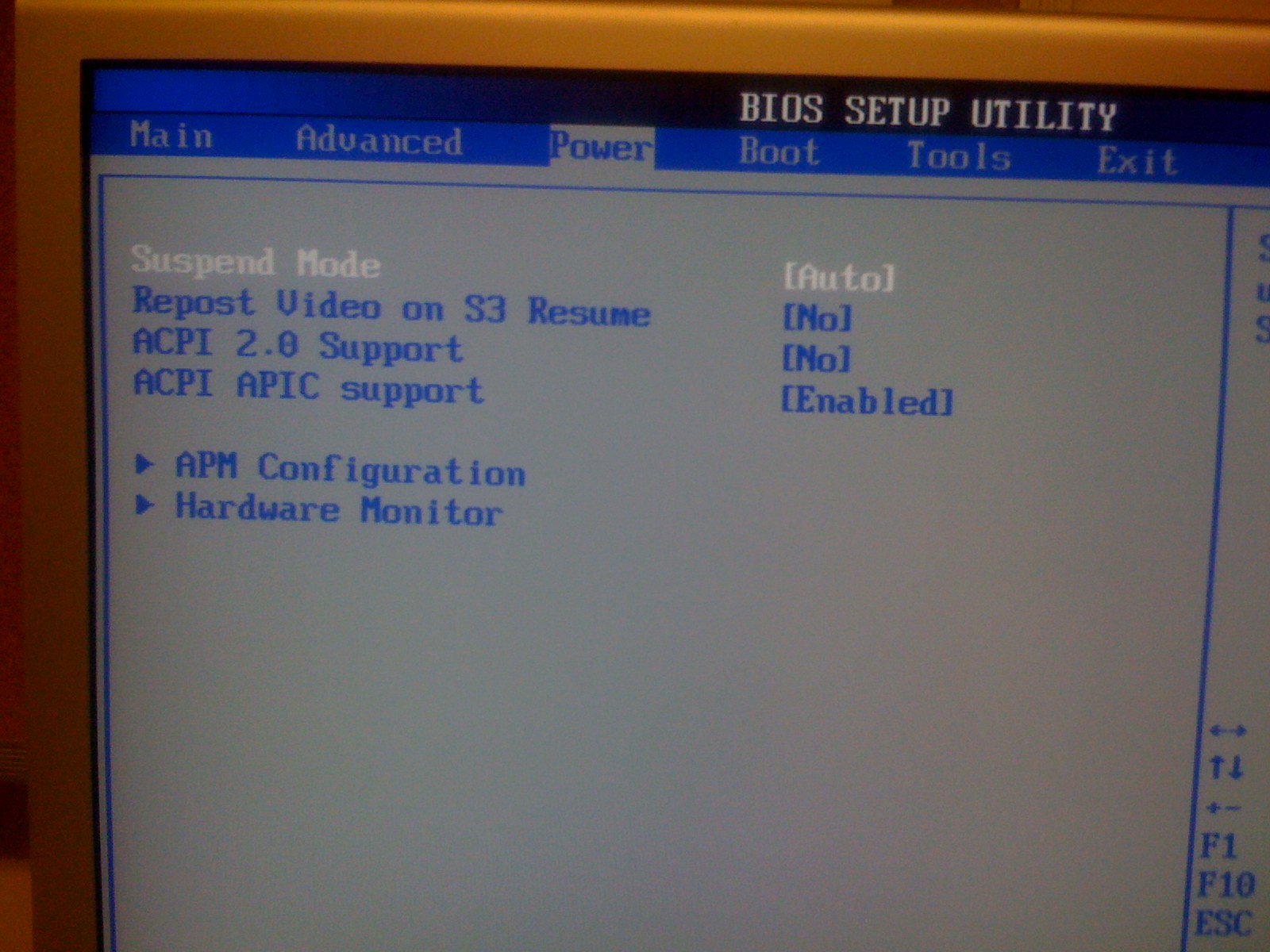

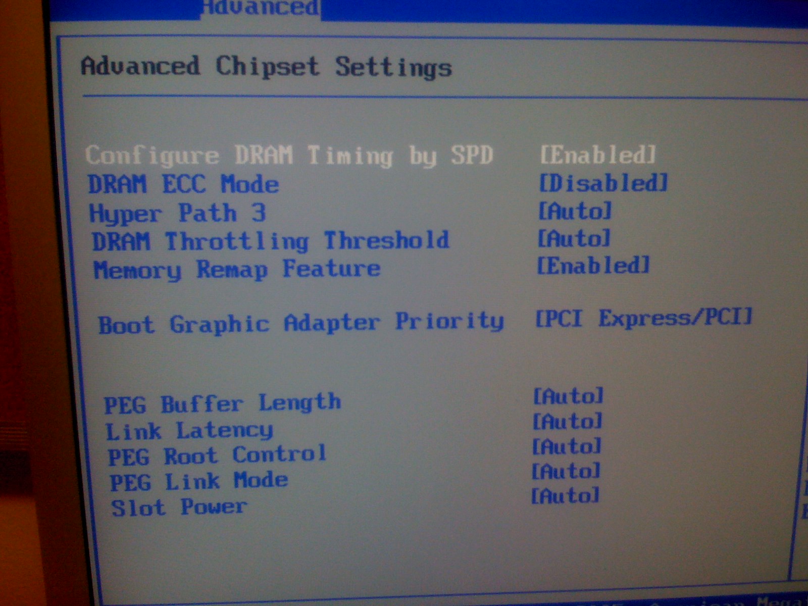

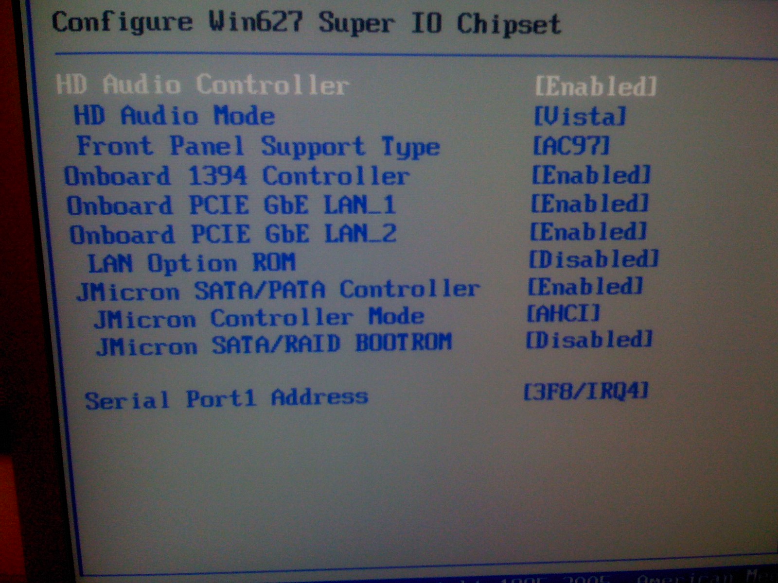

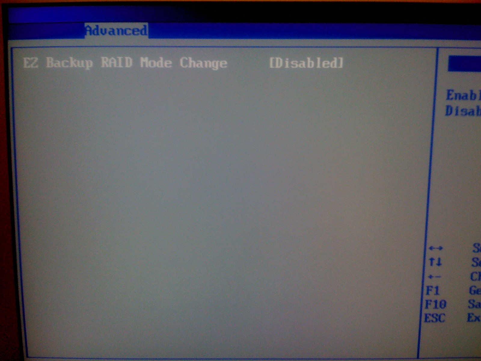

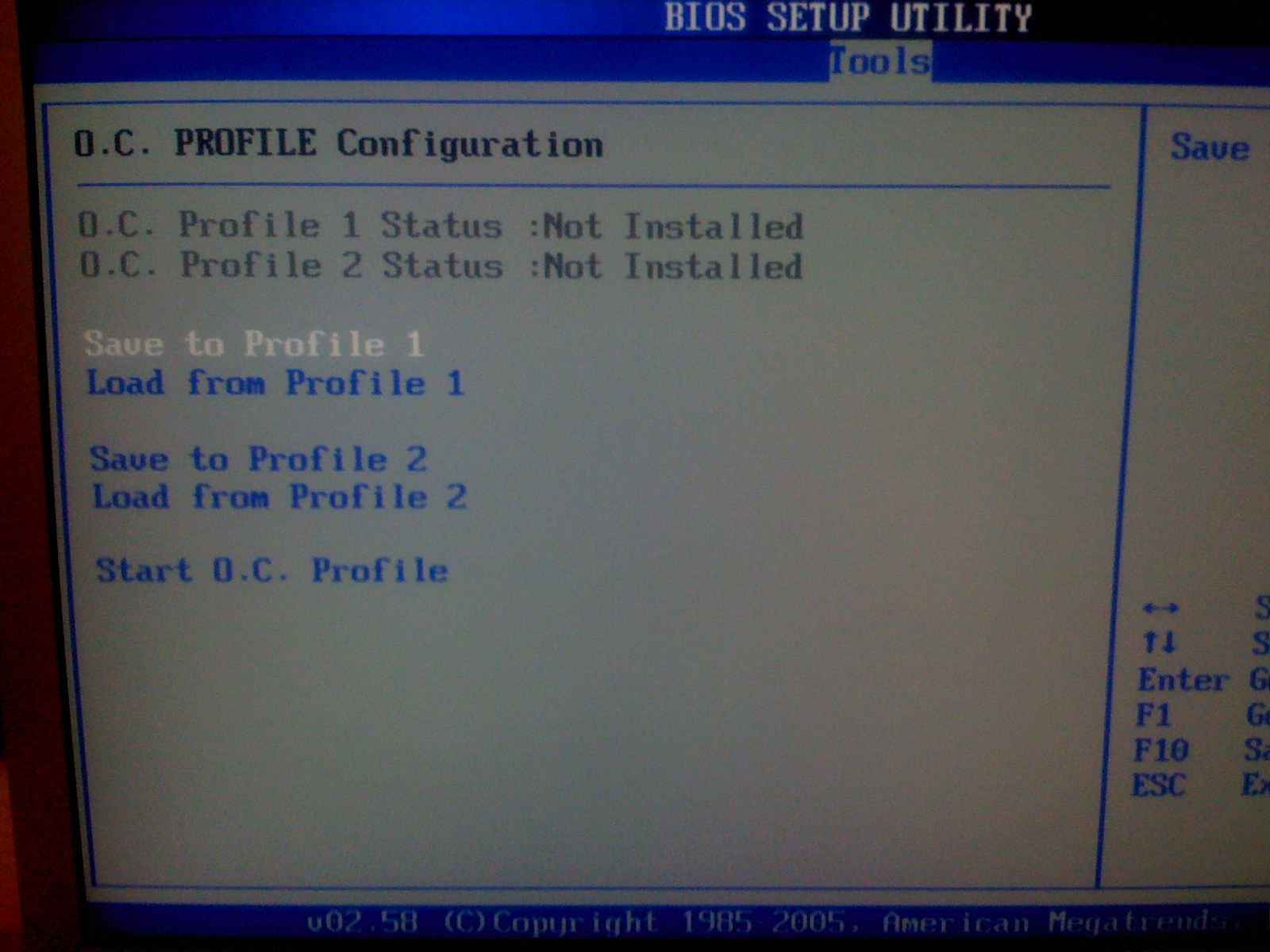

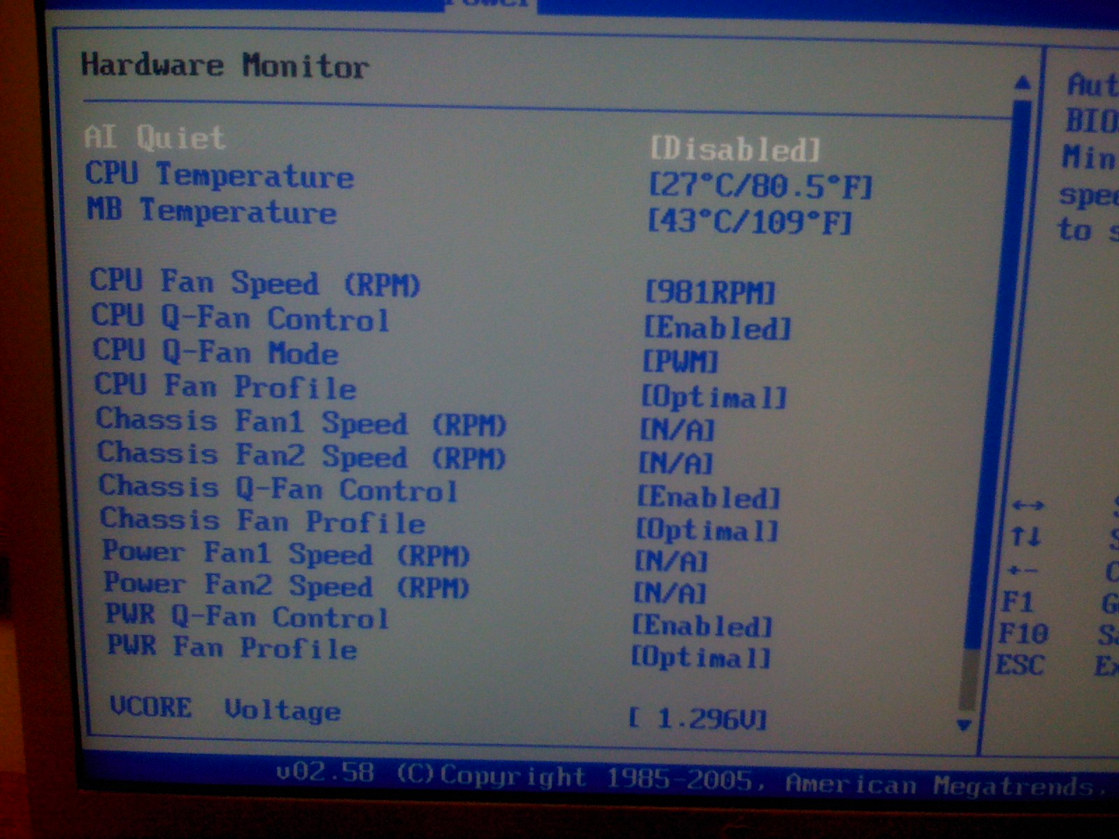

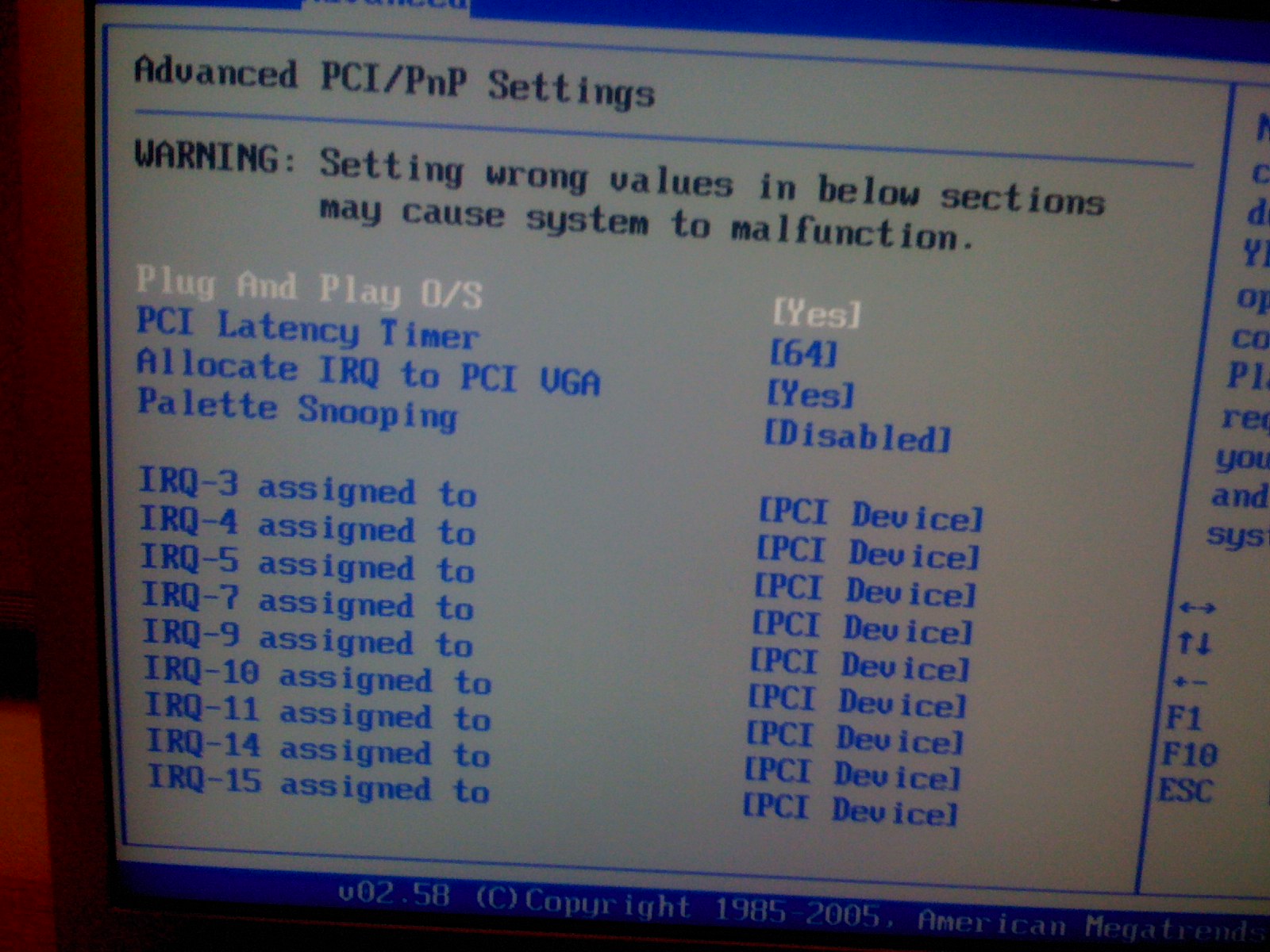

shah123 Posted February 11, 2008 Share Posted February 11, 2008 Be sure to update your BIOS to the latest rom. Things were a lot easier after the update. Here are my BIOS settings: Also I ended up in a boot loop after installation like many others. I tinkered every possible BIOS setting to get it to work. So if you encounter problems have patience and try to modify your BIOS settings. Link to comment https://www.insanelymac.com/forum/topic/86393-asus-p5w-dh-deluxe/#findComment-617667 Share on other sites More sharing options...
