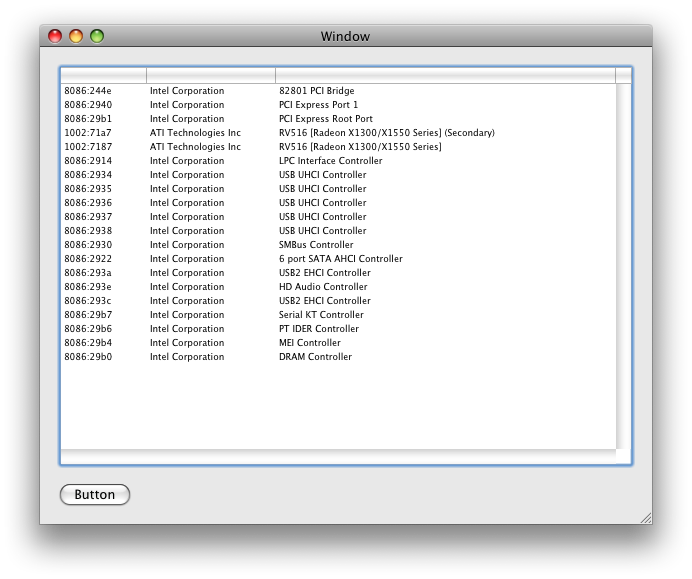

Riotz Posted June 26, 2008 Share Posted June 26, 2008 I dont think its possible to use a riser card in the SFF model. I have been successful with Kalyway 10.5.2. Installed with Vanilla 9.2 kernel with no Audio, NIC or Video drivers. deselected Nforce chipset and no 3rd party software, also netkaslastsmbios. I put in an ATI x1300 Low Profile card to get vid and used the Natit x1300 installed to get it working perfectly full qe/ci with all resolutions. I disabled NIC in the BIOS as that will not work for some time. I am using a belkin USB to Ethernet device with the pegasus OSX driver. For audio I am looking here for hope that our AD1984 Chipset will get a patch soon. Here is a screen shot off my Optiplex 755 that shows the Device IDs of my machine. If anyone sees anything that may not be driven please let us know Riotz Link to comment https://www.insanelymac.com/forum/topic/85167-kalyway-on-dell-optiplex-755/#findComment-797160 Share on other sites More sharing options...
