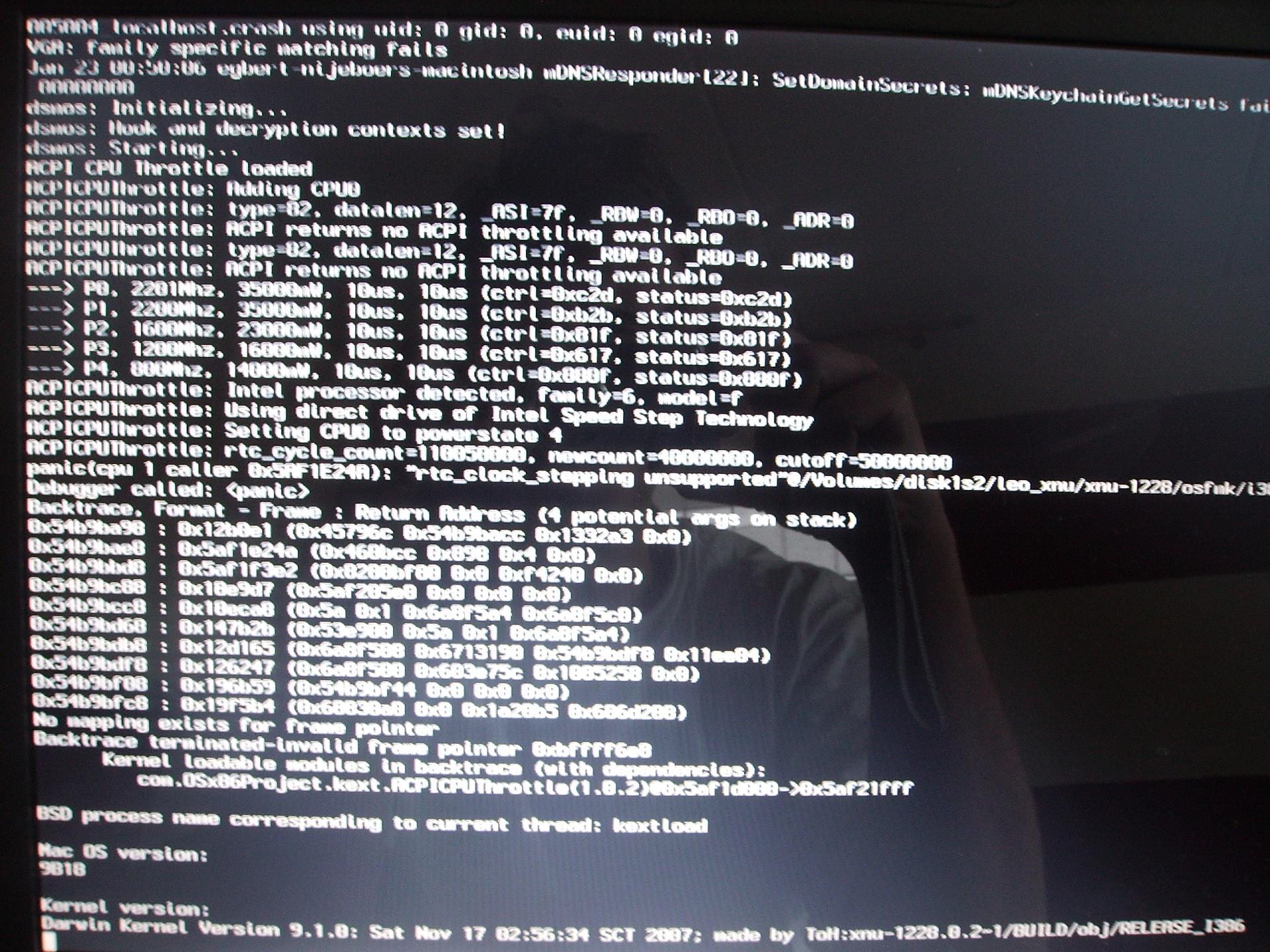

After installing MacOSX Leopard 10.5.1 MacOS is working fine, it bootes and i can enter the os without any problems. When i reboot my notebook and try to startup MacOS again i get the following error: "You need to restart your computer. Hold down the Power button for serveral seconds or press the Restart button."
I tried to reinstall it a few times but after the first reboot I get the same error everytime.
I hope someone can help me with this.
Iatkos v1.0i r2
Intel Core2Duo T7500
4096 MB DDR2
=====Update=====
I've searched on the forum and googled and I found the following to resolve the problem:
/library/SpeedStep
sudo mv ACPICPUThrottle.kext ACPICPUThrottle.kext.pos
After renaming this file the os booted with no further problems, are there any disadvantages at this solution?
