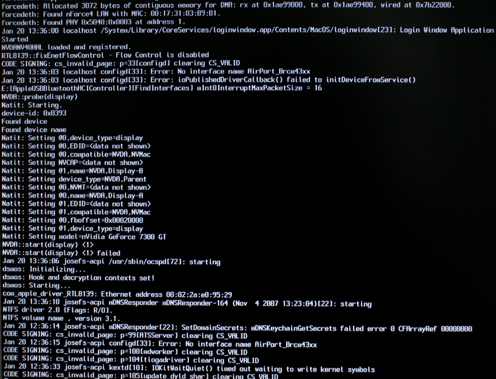

nemesispandor Posted January 20, 2008 Share Posted January 20, 2008 Hi, installed "Mac OS X Leopard 10.5.1 for AMD SSE2/SSE3 (32bits)" several days ago. Left me sleepless since then. The installation has some Geforce, Nvidia and ATI kexts included. Those cause a kernel panic, so i removed them all after the installation. Since demonoid is down, i couldn't find the necessary kexts anywhere but in this post. So i edit the DevIds and copy the following files in my Extensions folder: GeForce2MXGLDriver.bundle GeForce3GLDriver.bundle GeForce.kext GeForceFXGLDriver.bundle GeForceGA.plugin GeForceVADriver.bundle Natit.kext NVDANV40Hal.kext NVDAResman.kext In Terminal i enter this sudo chown -R root:wheel /System/Library/Extensions/GeForce.kext ; sudo chmod -R 755 /System/Library/Extensions/GeForce.kext . . . sudo rm -f /System/Library/Extensions.mkext sudo rm -f /System/Library/Extensions.kextcache diskutil repairpermissions / After reboot I can change my res but no QE/CI. I've tried with other natit (also nvinject) versions, they either gave me the same or even a kernel panic. Did I do something wrong? Or is this just a common Leo problem? The HCI says that there should be no problem... I attached a shot from my bootscreen, maybe that helps. Thanks a lot for your help! Link to comment https://www.insanelymac.com/forum/topic/82741-any-thoughts-natit-qeci-geforce-7300gt-resists-in-leopard/ Share on other sites More sharing options...
