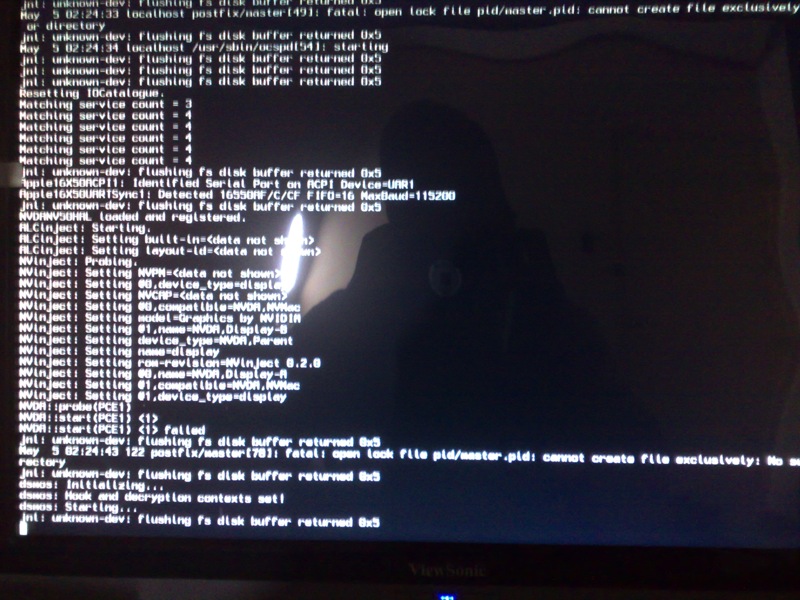

chipinoy Posted May 5, 2008 Share Posted May 5, 2008 Hi thanks for helping me out... I tried what you said and still no go, btw, what does the change in string means? from 0x040210de to 0x00a20402 & 0x040200a2? what does the "00a2" means? some other tuts said to remove "&0xfff0ffff" in the strings, did that and still nada. i am attaching the pic on the errors, maybe it could give you a clearer picture on what is going on... --- Edit --- Link to comment https://www.insanelymac.com/forum/topic/82080-got-my-nvidia-8600gt-working-updated-9-18-08/page/2/#findComment-736041 Share on other sites More sharing options...
bf2loser Posted May 5, 2008 Author Share Posted May 5, 2008 Hmm I'm not sure what those errors mean. I believe those are hexadecimal strings. If you go in windows and right click my computers, then go to properties open up device manager and click properties on your video card underneath the display adapters menu. Then click the details tab at the top and in the dropdown box click hardware id's you will see the two numbers. Like mine says PCI\VEN_10DE&DEV_0402&SUBSYS_C7503842&REV_A1 so my device id would be 0x040210de (take the second number and use it as the first half) Link to comment https://www.insanelymac.com/forum/topic/82080-got-my-nvidia-8600gt-working-updated-9-18-08/page/2/#findComment-736359 Share on other sites More sharing options...
