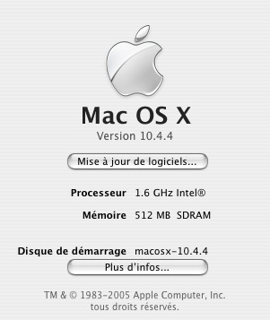

VaiOSX Posted February 26, 2006 Share Posted February 26, 2006 As far as i know : Pentium M @900Mhz (code named "Banya") doesn't have PAE at all (it is really broken). It only supports SSE2, which is enough to run 10.4.1. (forget 10.4.3 and more) Pentium M @1.6Ghz (code named "Dothan") doesn't have "officially" PAE. It's not true because i can successfully install all the OS X Intel versions from 10.4.1 to 10.4.5. In fact the PAE is broken but (for a reason that only Jas and Maxxuss could answer) it seems that it is not really disabled. If you have a Dothan version of the Pentium M, you will be able to install OS X 10.4.3 and more, only in Native Mode (VM Ware says that it has no PAE, even if it's already activated in VMWARE vmx prefs or boot.ini /PAE). Link to comment https://www.insanelymac.com/forum/topic/7356-pae-or-no-pae-that-is-the-question-need-help/#findComment-63785 Share on other sites More sharing options...

antrunix Posted February 26, 2006 Share Posted February 26, 2006 My Dothan according to Everest has to PAE enabled. But in reality it has according to FreeBSD system. So, I installed 10.4.4...fairy tale, isn't? Link to comment https://www.insanelymac.com/forum/topic/7356-pae-or-no-pae-that-is-the-question-need-help/#findComment-63798 Share on other sites More sharing options...
