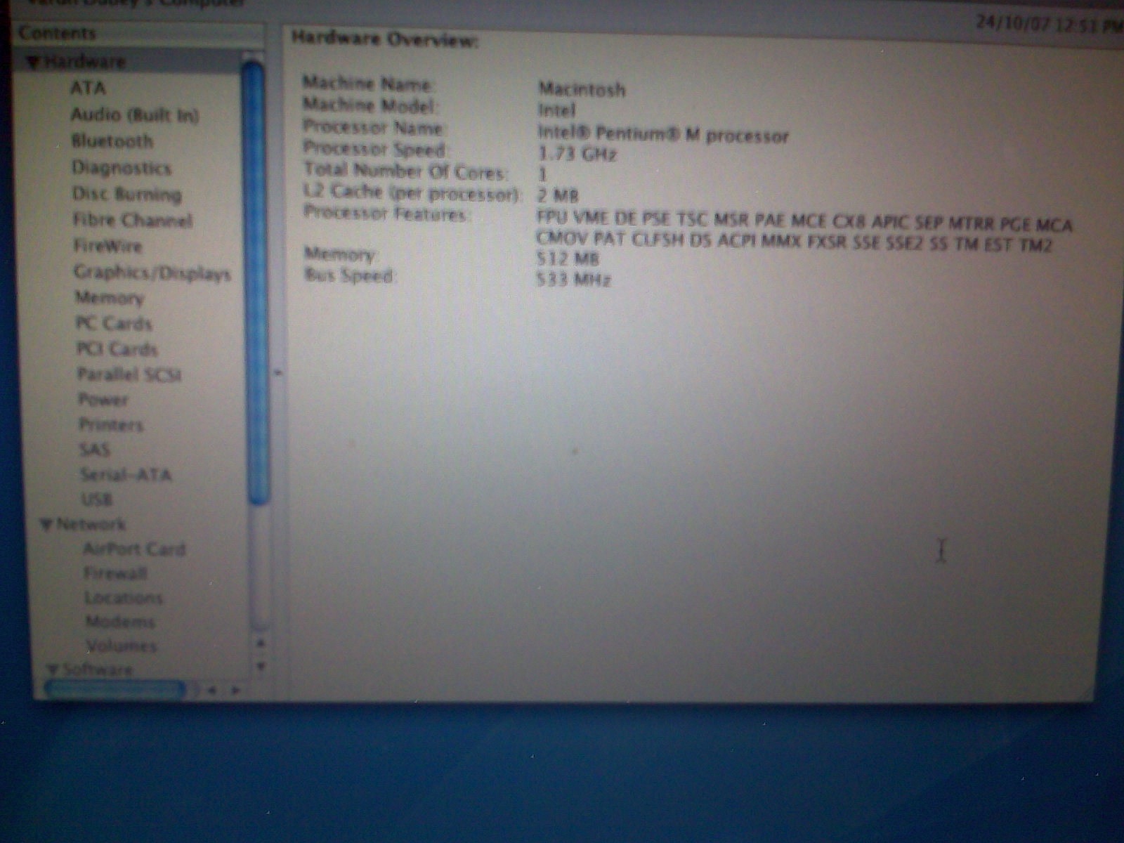

randomgyan Posted October 24, 2007 Share Posted October 24, 2007 After half a night, I have managed to install OSX 10.4.9 on my Compaq PResario V4000 Spec: Intel Pentium M 1.73GHz Intel GMA900 (native driver selection in the install) ICH6 and ICH8 (native driver selection in install) Broadcom wifi Integrated audio (which works fine with the native drivers) ethernet (again works fine with the native drivers) the problem i have is - i cannot get wifi running because i have no idea what broadcom chip i have. Is there a way to figure that out in OSX or in bios or at boot or something? If anyone with the V4000 can tell me what broadcom wifi chip is inside, it would be awesome! Further - strangely enough, i do have bluetooth and it shows up in the finder bar on top! The hardware button seems to work as well when i switch it off, the bluetooth gets disabled, when i switch it on, the bluetooth is enabled. But no wifi. Is there ANYWAY to fix the wifi? Thanks! Link to comment https://www.insanelymac.com/forum/topic/67510-presario-v4000-almost-works-no-wifi/ Share on other sites More sharing options...
