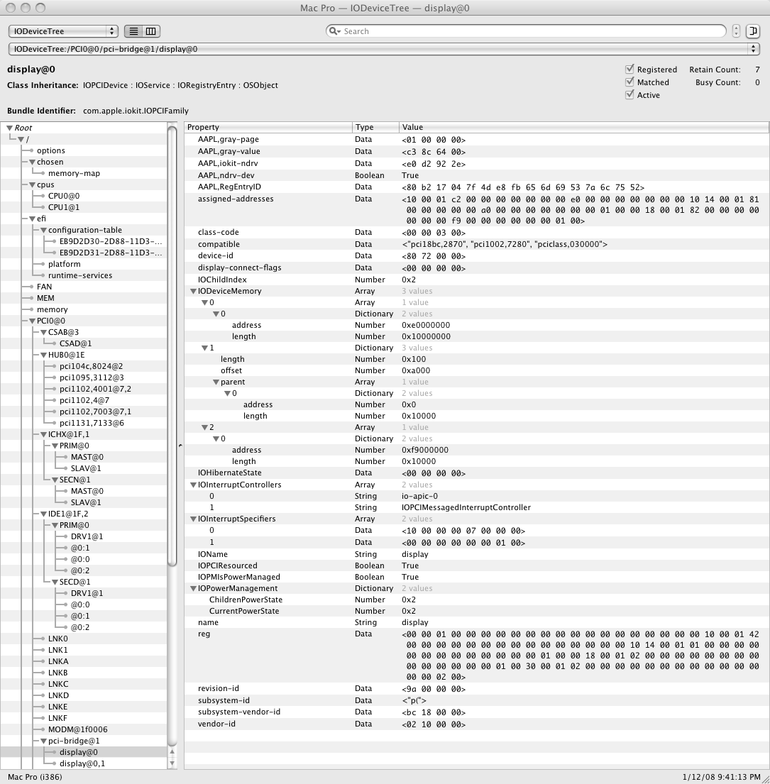

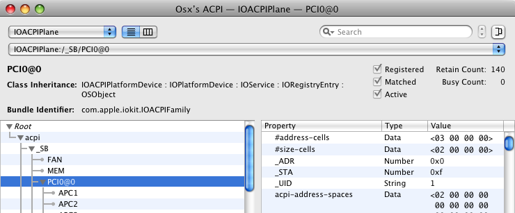

Bronya Posted January 9, 2008 Author Share Posted January 9, 2008 Does anyone managed to get an efi GFX String for the x1950pro (Device ID 7280) ? Yes !!! In me work efi on amd x1950 !!! If you IOACPIPlane:/_SB/PCI0@0 <-- UID=1 , then PciRoot(0x1)/Pci(0x.....) !!! If you IOACPIPlane:/_SB/PCI0@0 <-- UID=2 , then PciRoot(0x2)/Pci(0x.....) !!! My info in IOREG : _UID=1 IODeviceTree:/PCI0@0/XVR0@E/display@0 <--- PciRoot(0x1)/Pci(0xe,0x0)/Pci(0x0,0x0) <-- 02010c00d041030a0100000001010600000e0101060000007fff0400 My system on AMD : ATY,RadeonX1950GT pro: Chipset Model: ATY,RadeonX1950GT pro Type: Display Bus: PCIe PCIe Lane Width: x16 VRAM (Total): 256 MB Vendor: ATI (0x1002) Device ID: 0x7280 Revision ID: 0x009a ROM Revision: 113-A52027-140 EFI Driver Version: 01.00.140 Displays: BenQ FP2092: Resolution: 1600 x 1200 @ 60 Hz Depth: 32-bit Color Core Image: Hardware Accelerated Main Display: Yes Mirror: Off Online: Yes Quartz Extreme: Supported QuartzGL: Supported Rotation: Supported Display Connector: Status: No display connected 1950.txt <-- gfx-string for com.apple.boot.plist for AMD ! Work TV-out ! DUAL DVI work ! Enjoy ! P.S. I try boot_1950_efi without gfxstring(com.apple.boot.plist) ! Work ! For PciRoot(0x1)/Pci(0xe,0x0)/Pci(0x0,0x0)...boot_1950_efi.zip The boot_1950_efi version 6 for MBR ! No guid table ! Link to comment https://www.insanelymac.com/forum/topic/58988-work-x1950gt-pro-dev_id-0x72801002-and-0x72881002/page/33/#findComment-572982 Share on other sites More sharing options...
Kevin Email Posted January 10, 2008 Share Posted January 10, 2008 Bronya should I remove Natit.kext / ATI Drivers before trying the new boot_1950_efi? The EFI stuff has always been a wee bit confusing for me Link to comment https://www.insanelymac.com/forum/topic/58988-work-x1950gt-pro-dev_id-0x72801002-and-0x72881002/page/33/#findComment-574019 Share on other sites More sharing options...
Bronya Posted January 10, 2008 Author Share Posted January 10, 2008 Bronya should I remove Natit.kext / ATI Drivers before trying the new boot_1950_efi? The EFI stuff has always been a wee bit confusing for me If in your IORegistryExplorer show how IODeviceTree:/PCI0@0/XVR0@E/display@0 , yes delete natit.kext and flash boot_1950_efi ! If in your IORegistryExplorer no show how do me , you flash boot_8v and test gfxstring in com.apple.boot.plist ! Link to comment https://www.insanelymac.com/forum/topic/58988-work-x1950gt-pro-dev_id-0x72801002-and-0x72881002/page/33/#findComment-574042 Share on other sites More sharing options...
Kevin Email Posted January 10, 2008 Share Posted January 10, 2008 I think Mine is IODeviceTree:/PCI0@0/P0P2@1/display@0 This is for a X1950PRO on Intel Machine... The efi did not work for me but going to try your GFX string but I think maybe will need to make my own? Link to comment https://www.insanelymac.com/forum/topic/58988-work-x1950gt-pro-dev_id-0x72801002-and-0x72881002/page/33/#findComment-574096 Share on other sites More sharing options...
Bronya Posted January 10, 2008 Author Share Posted January 10, 2008 I think Mine isIODeviceTree:/PCI0@0/P0P2@1/display@0 This is for a X1950PRO on Intel Machine... The efi did not work for me but going to try your GFX string but I think maybe will need to make my own? Yes. You found _UID = ? IODeviceTree:/PCI0@0/P0P2@1/display@0 <-- PciRoot(0x???)/Pci(0x1,0x0)/Pci(0x0,0x0) "???" <-- _UID = ?. You found _UID in ioreg in /PCI0@0 , if _UID=0 , then PciRoot(0x0)/...... Link to comment https://www.insanelymac.com/forum/topic/58988-work-x1950gt-pro-dev_id-0x72801002-and-0x72881002/page/33/#findComment-574122 Share on other sites More sharing options...

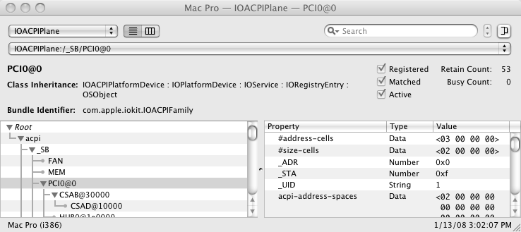

Bronya Posted January 13, 2008 Author Share Posted January 13, 2008 Alex HQuest , your string PciRoot(0x???)/Pci(0x1,0x0)/Pci(0x0,0x0)Your what UID = ???If UID=1 , then PciRoot(0x1)/Pci(0x1,0x0)/Pci(0x0,0x0) ...And you edit 1950.plist and convert to HEX !In 1950.plist you can replace ATY,Prionace to ATY,Alopias ...etc... Then this is the end.AGP sucks. I should buy a new PC.Yeah .You can delete natit.kext and checkup - work or no work QE/CI !!!??? Link to comment https://www.insanelymac.com/forum/topic/58988-work-x1950gt-pro-dev_id-0x72801002-and-0x72881002/page/33/#findComment-577601 Share on other sites More sharing options...
Jaime5 Posted January 13, 2008 Share Posted January 13, 2008 I hi need the drivers for version 10.4.8 His x1950pro 256mb Thanks Link to comment https://www.insanelymac.com/forum/topic/58988-work-x1950gt-pro-dev_id-0x72801002-and-0x72881002/page/33/#findComment-577821 Share on other sites More sharing options...
Alex HQuest Posted January 13, 2008 Share Posted January 13, 2008 Alex HQuest , your string PciRoot(0x???)/Pci(0x1,0x0)/Pci(0x0,0x0)Your what UID = ???If UID=1 , then PciRoot(0x1)/Pci(0x1,0x0)/Pci(0x0,0x0) ...And you edit 1950.plist and convert to HEX !In 1950.plist you can replace ATY,Prionace to ATY,Alopias ...etc...Yeah .You can delete natit.kext and checkup - work or no work QE/CI !!!??? I'm afraid I can't use your boot_1950_efi, because 1) I am not running AMD system and 2) have efi_v8 installed already. So I am trying to figure out what to do to generate a new hex string for my Intel processor. Either way, I am still trying to make this x1950pro AGP card to work. I do not have QE/CI yet. Link to comment https://www.insanelymac.com/forum/topic/58988-work-x1950gt-pro-dev_id-0x72801002-and-0x72881002/page/33/#findComment-577883 Share on other sites More sharing options...

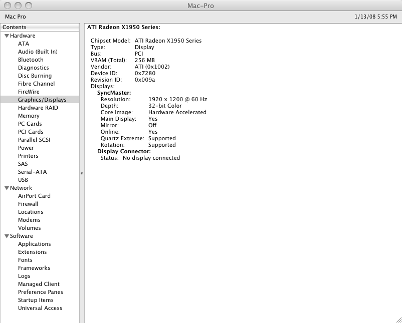

Alex HQuest Posted January 13, 2008 Share Posted January 13, 2008 HOLY SH*T, IT WORKS!!!!!11eleven What I have done? Thrown Kalyway 10.5.1 disc on DVD drive sudo bash cd /System/Library/Extensions rm -fr ATI* cp -r /Volumes/Leopard_Install_Osx86/System/Library/Extensions/ATIRadeonX1000* /System/Library/Extensions cp -r /Volumes/Leopard_Install_Osx86/System/Library/Extensions/ATIRN* /System/Library/Extensions cp -r /Volumes/Leopard_Install_Osx86/System/Library/Extensions/ATIN* /System/Library/Extensions cp -r /Volumes/Leopard_Install_Osx86/System/Library/Extensions/ATIRadeon.kext /System/Library/Extensions diskutil repairpermissions / (then reboot) Thrown a MSDOS disk with both ATIFlash and a PowerColor X1950Pro AGP 256Mb BIOS (got both from TechPowerUP!) and flashed my crappy GeCube with PowerColor BIOS Plugged my LCD cable on lower DVI port (the one nearest motherboard) Back on Leo, installed again ATI_X1950_Leo drivers from first post (id 0x7280) on this thread Make sure I was able to connect using VNC/SSH from another machine Restarted, ZOMFG IT WORKS!!! I still need to do some workings on it. When I got it to work at the real very first time, it was on 1600x1200 (24" Samsung screen), and I chose 1920x1440. Instantly I got the nasty blue screen with black mouse pointer. However, I could connect to Leo using VNC. Then I tried SwitchResX, no lucky. Removed Natit and got another one (Natit_edited) from Natit thread on X Labs, put in place, booted with -f -v and it is working at 1920x1200. That's OK as IIRC this is the same resolution I am running back on WinXP (although before I got all whistles and bells I was running 1920x1440 in software mode). What I think it was causing all this mess is: 1) DVI Connector: Most of the time I was using secondary DVI connection. This *can* explain why I was getting the black screen. 2) Kalyway's ATI Drivers: IDK which drivers is this disc installing by default. I copied again from DVD (got this tip somewhere in this topic) and gave another try. 3) VGA BIOS: I have no idea if this is what solved or not my issue. Card is working as expected, I played at least one Heroic instance in WoW while was testing card on WinXP, and now it is working also on Leo. Still, there are TONS of questions floating around. Either way, I can celebrate for being persistent. Thanks all. Special thanks for Bronya for not killing me for all the time I bother him. Link to comment https://www.insanelymac.com/forum/topic/58988-work-x1950gt-pro-dev_id-0x72801002-and-0x72881002/page/33/#findComment-578002 Share on other sites More sharing options...
Bronya Posted January 13, 2008 Author Share Posted January 13, 2008 Alex HQuest , great job ! Your string PciRoot(0x1)/Pci(0x1,0x0)/Pci(0x0,0x0) !!! You not use my boot_1950_efi , because you have boot_v8 ! Link to comment https://www.insanelymac.com/forum/topic/58988-work-x1950gt-pro-dev_id-0x72801002-and-0x72881002/page/33/#findComment-578120 Share on other sites More sharing options...
