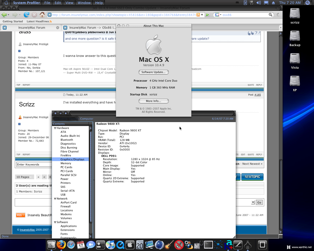

Scrizz Posted June 14, 2007 Share Posted June 14, 2007 Yes you should probably use older kexts, I myself did not have that problem b/c i used jas 10.4.9 update this is what I did for 10.4.8: Had to add device ID to ATIRADEON9700.kext Later used Callisto 008 for res switching, follow callisto faq to get res switching and QE CI. Plus installed QuartzSimple to enable Quartz2DExtreme Link to comment https://www.insanelymac.com/forum/topic/53863-ci-qe-on-ati-9800-xt/#findComment-384759 Share on other sites More sharing options...

Scrizz Posted June 15, 2007 Share Posted June 15, 2007 well callisto didn't give me QE CI, editing the info.plist in the ATIRADEON9700.kext did. Callisto was used to enable res switching. I personaly used the Jas 10.4.8 sse2/sse3 version and didn't have to replace any kexts. This is what I did: Step 1: edit info.plist from ATIRADEON9700.kext Step 2: intall callisto added CallistoFB to ATIRADEON9700GA.kext (make sure you follow the callisto instructions and the faq.. don't skip steps. Step 3: Repair permissons Step 4: Watch a movie, lol Hope this works for you! Link to comment https://www.insanelymac.com/forum/topic/53863-ci-qe-on-ati-9800-xt/#findComment-386282 Share on other sites More sharing options...

Scrizz Posted June 16, 2007 Share Posted June 16, 2007 ohh srry only sse3, just stick with jas 10.4.8 sse2/sse3 Qe/CI should work with method decribed above Link to comment https://www.insanelymac.com/forum/topic/53863-ci-qe-on-ati-9800-xt/#findComment-386949 Share on other sites More sharing options...
