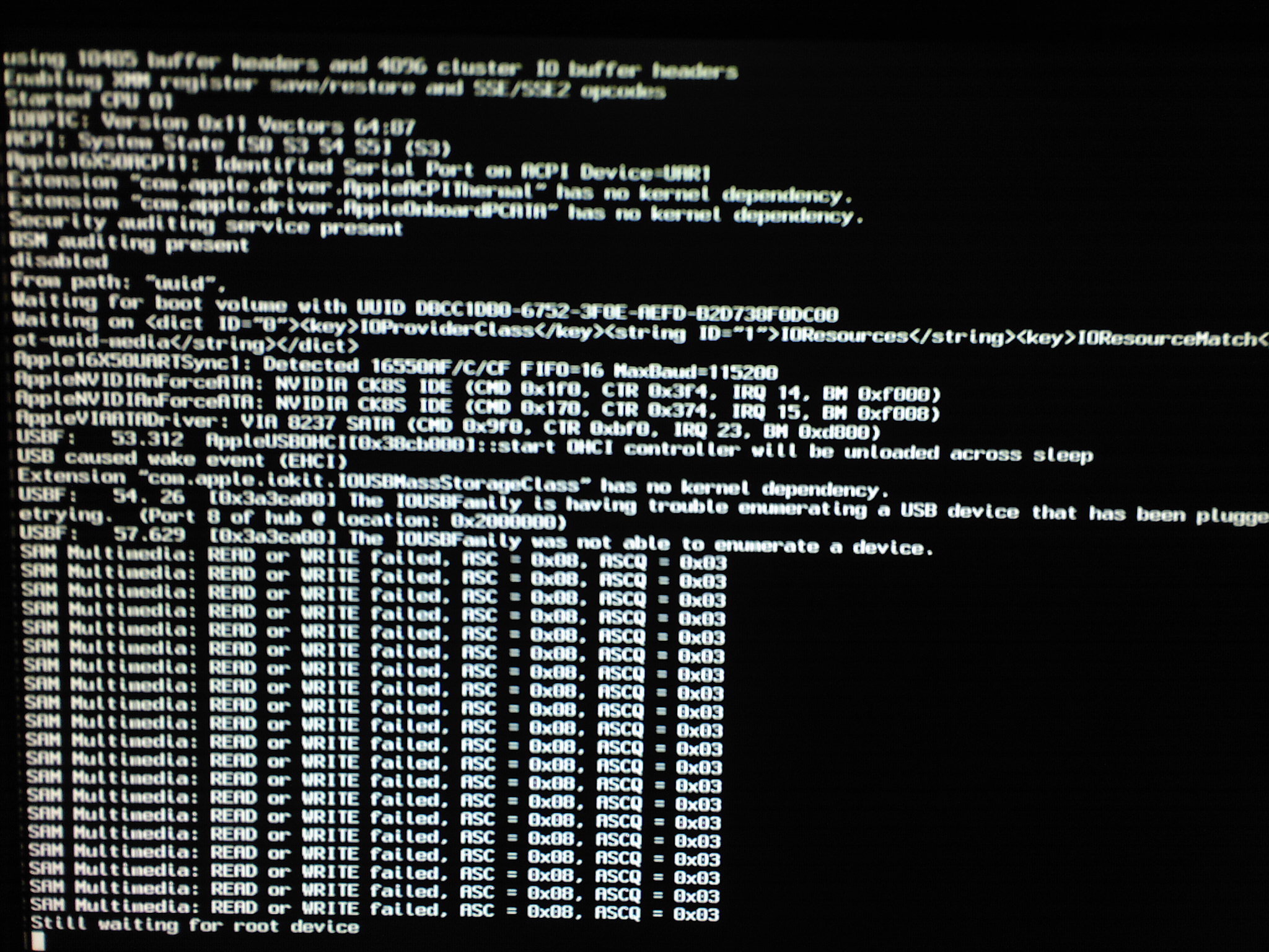

ChurChing Posted June 5, 2007 Author Share Posted June 5, 2007 Ok so I changed my FAT32 partition on my IDE to a Ext2 and OSX still can't find it. I get the same problem every time. I took a picture of the screen where it says "still waiting on root device" if anyone wants to look at it and has a clue what it might mean or why it's doing this. PLEASE HELP! Thanks! Link to comment Share on other sites More sharing options...
ChurChing Posted June 5, 2007 Author Share Posted June 5, 2007 This is the picture of my screen when it gets stuck.... It says there are some USB errors. Do I need to remove some a usb expansion that I added to my asus motherboard? also whats this SAM multimedia read or write failed? Is that my problem. Link to comment Share on other sites More sharing options...
Johndoe60914 Posted November 5, 2007 Share Posted November 5, 2007 I had the Sam Read write Stuff going on fixed that by moving ide cables and jumpers it works now with DVD-RW as Master and IDE HDD as Slave not using any sata stuffs, the usb errors i fixed by turning off usb in bios. however its still waiting for root device using Tubgirls 10.4.10 test 1 Link to comment Share on other sites More sharing options...
