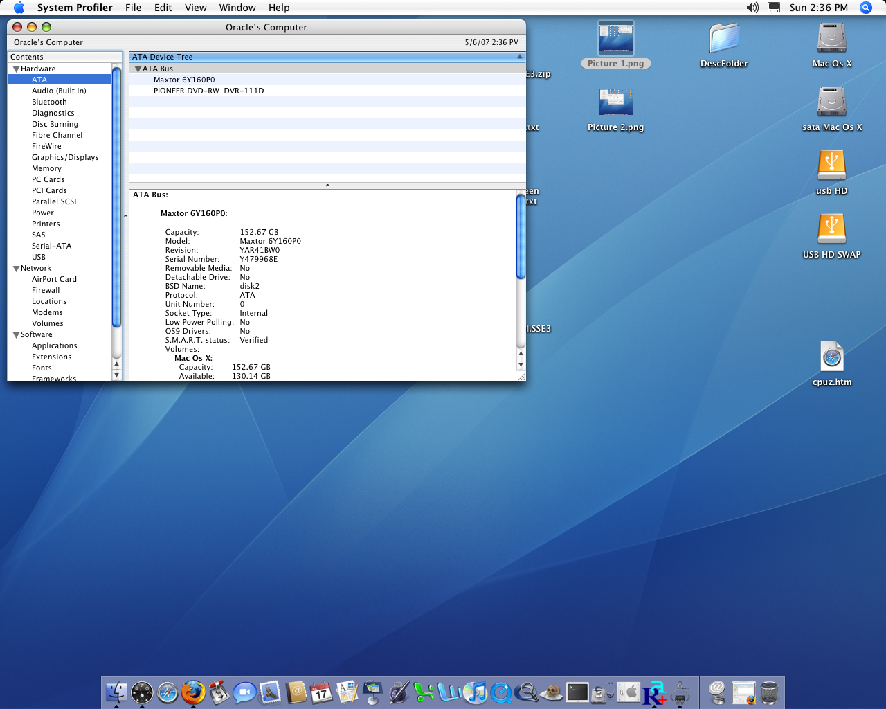

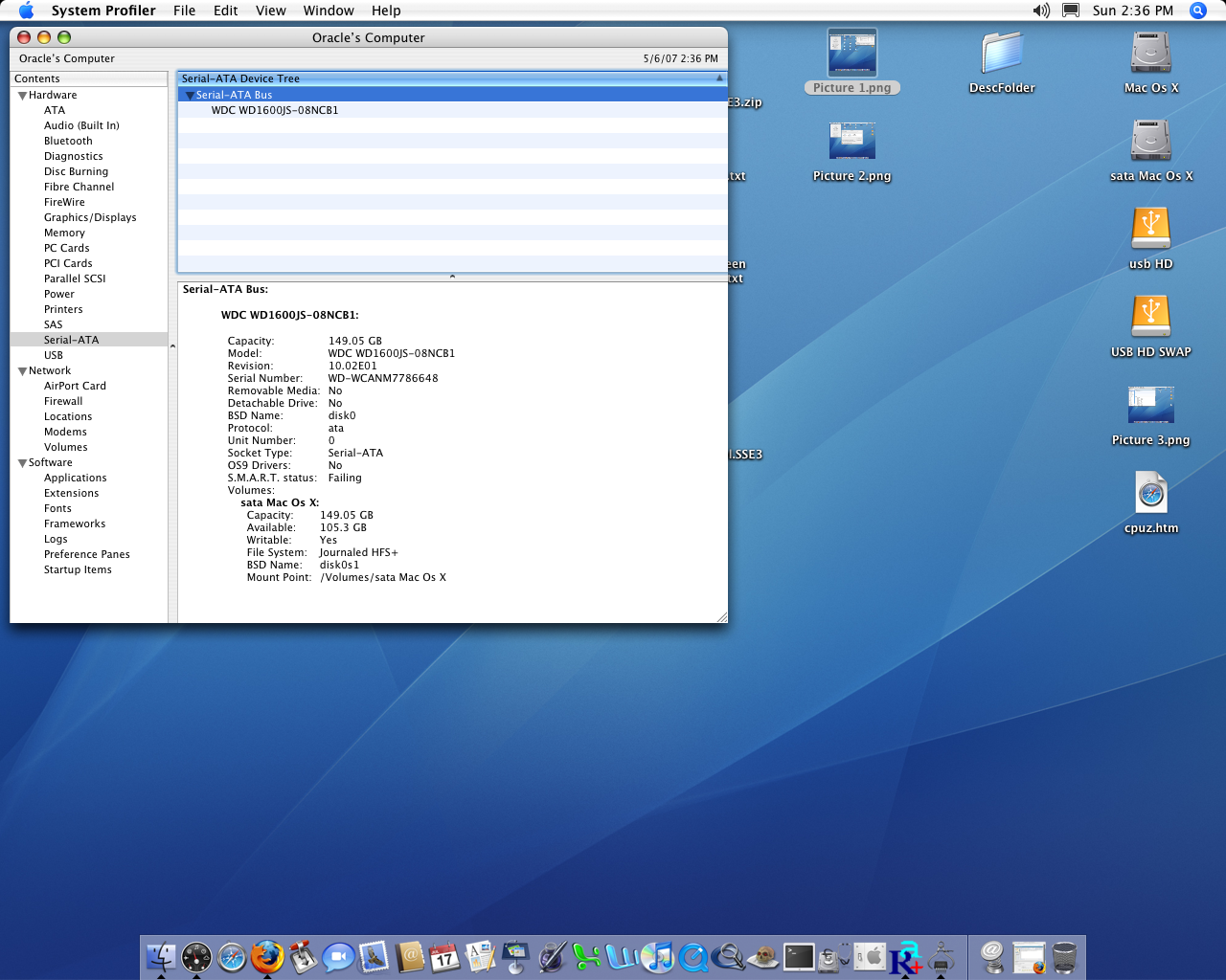

Oracle67 Posted May 7, 2007 Share Posted May 7, 2007 No. You cannot install on a USB HDD so easy. Installation can be done on FireWire. But dont complicate it, just unplug your sata Drives and use an IDE to install, the rest you ll se after that . Link to comment https://www.insanelymac.com/forum/topic/50342-installation-crash/#findComment-360931 Share on other sites More sharing options...

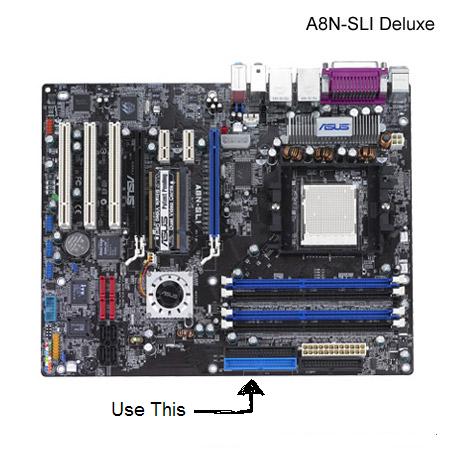

Oracle67 Posted May 7, 2007 Share Posted May 7, 2007 What is the Disc in the USB box that you use? Try reserch starting from Here . Otherwise use the blue IDE chanel with an IDE HDD to reinstall on it. Link to comment https://www.insanelymac.com/forum/topic/50342-installation-crash/#findComment-361055 Share on other sites More sharing options...
